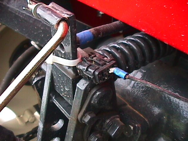

Here's a close up of the wire from the junction box being plugged into the pigtail that is below the slow moving vehicle sign...so probably a foot and half of wire from box to pigtail. Just fashioned a connector that would plug into the hot lead.
hope this helps....was quick and easy and worked for me.
