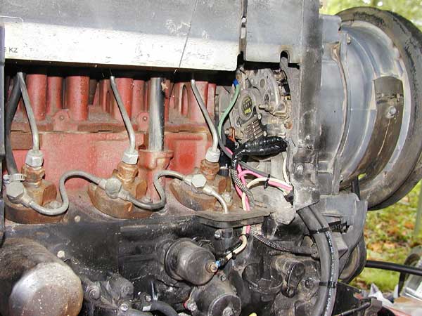

Bob999 <font color="red"> I would be interested in seeing a picture of this mod. </font>
The fan duct. It turns out a 5 gal compound bucket is a perfect fit over the outer/flexible part of the fan housing gasket. I just cut the top 2 inches or so (to just below the 3rd ring) off the top of a bucket and slipped it over the flexible gasket and up against the thick part of the gasket. Closing the hood holds it on.
BTW, for you non 1845 owners, that's one of two mouse entrances you see where the fan belt disappears through the slitted rubber gasket. The mousenest plenum is the ribbed sheetmetal piece to the left. The fan sucks cooling air in the duct, through the alternator (mounted in the fan hub) and blows it into the plenum where it is directed out the top through a horizontally mounted oil cooler.

FROGS!? No frognest in my plenum (maybe the mice keep them out). BTW, the mice also nest in the tunnel and under the floorboards. Jump on and fire up PT and the critters scatter in all directions. This thing's got way too many cozy nest sites. Do they make battery operated ultrasonic repellers - the nearest outlet is a good 500 feet from the tractorport.
Attachment shows plenum interior with the back of alternator showing at right end and the bottom of the cooler across the top.
