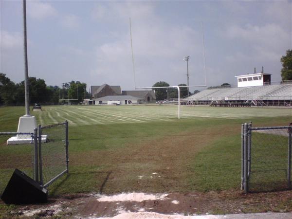

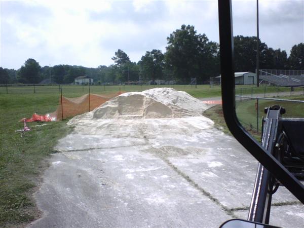

Spread 108 tons of sand on football field. Moved all of it with YM2020.
Thats a lot of work in about 6 hours!!!!

Can't really tell any details from your pictures but looks like a perfectly even spread. Did you do this with a loader and box blade combination? However you did it you must be a smooth operator.:thumbsup:

my guess would be he used a 3 point spreader.
Actually it was a greens top dresser from a local golf course. Really does a smooth and even job. I then dragged it with a piece of chain link fence made up as a drag, worked all the sand into the grass and after watering over night no sand was visible.
