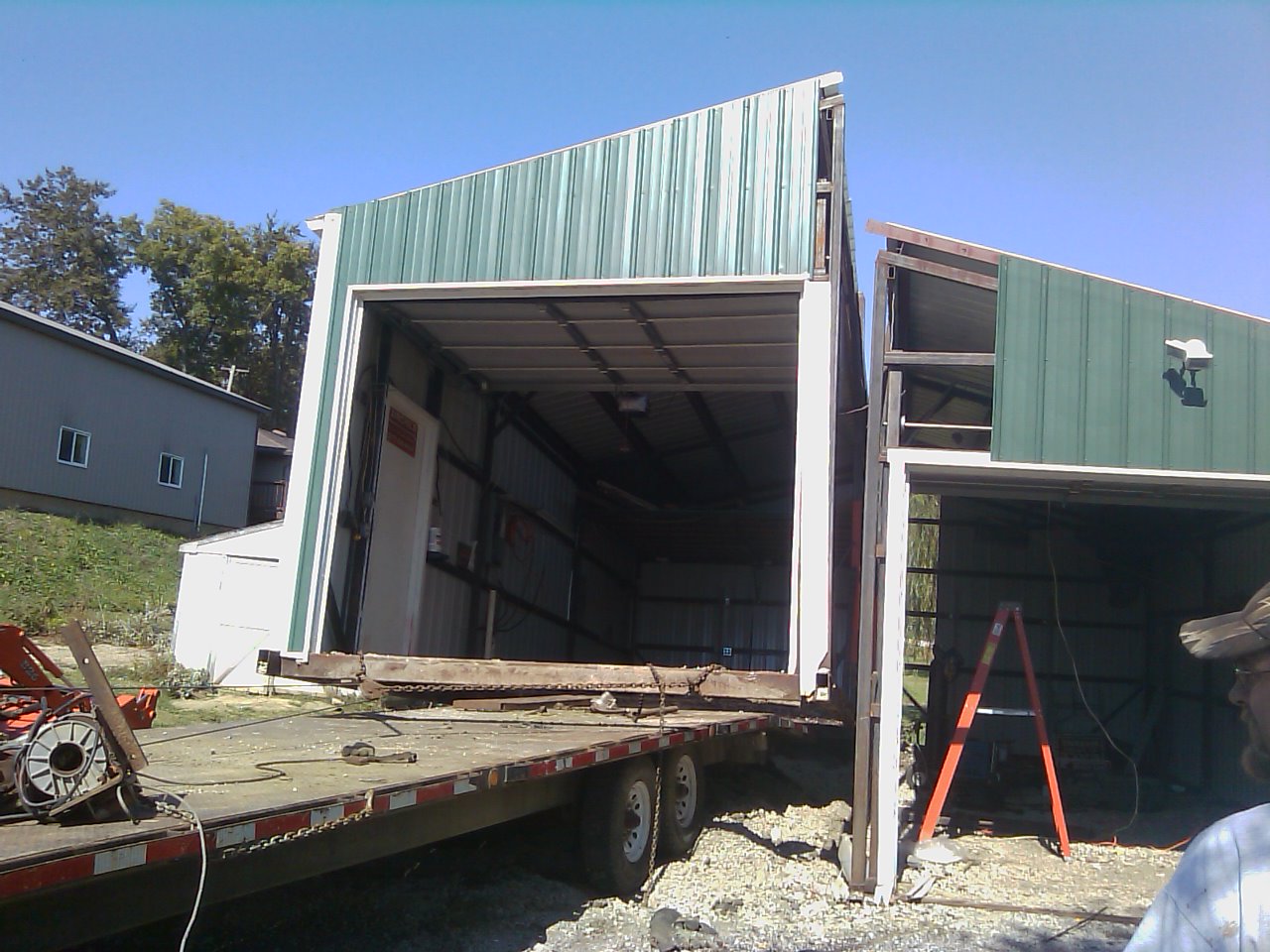

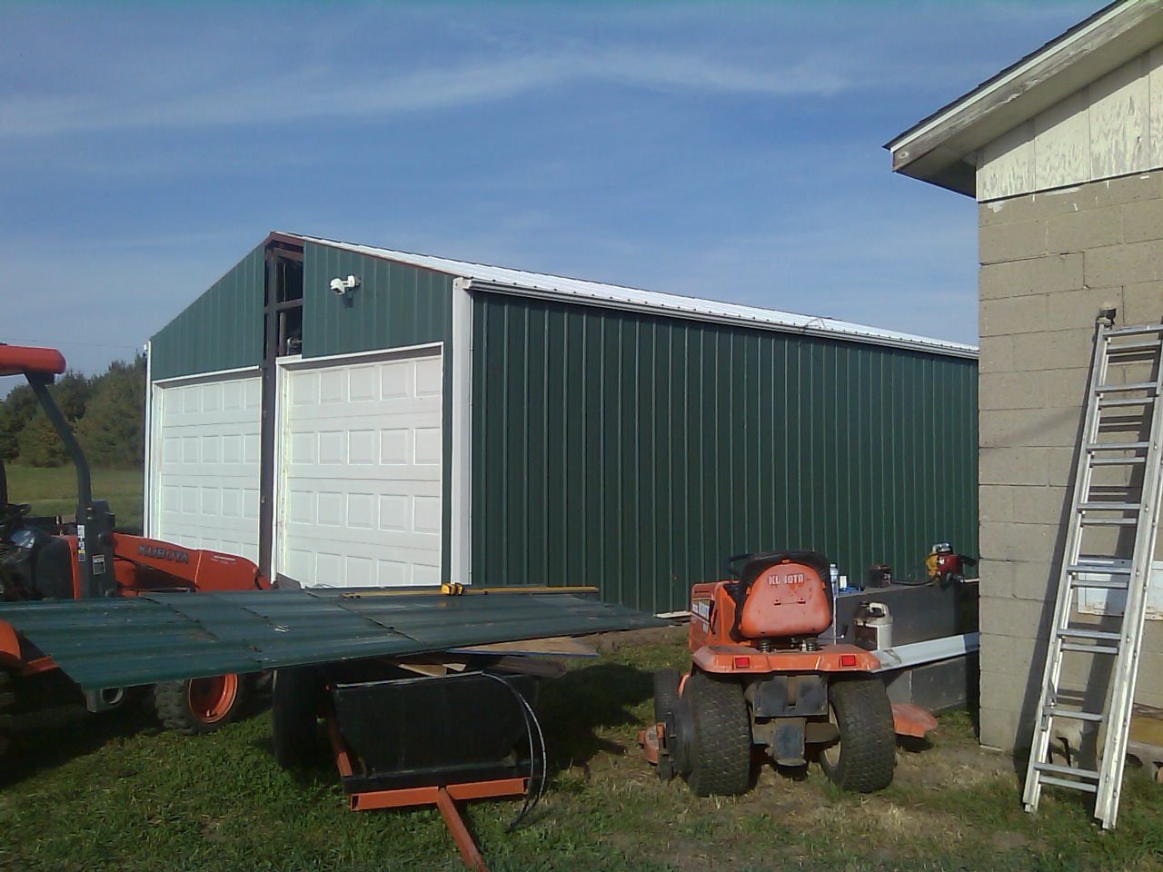

Well finally moved to a bigger place on more acres and I built this shed 5-6yrs ago knowing that I wanted to move to the new place when the time came. Well Saturday was the day.

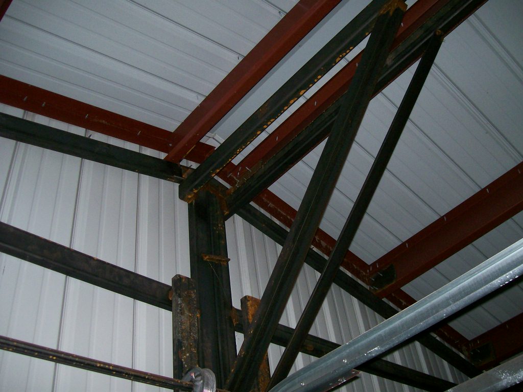

About the shed I built it as a portable shed. I has steel runners that are 3x6 steel tube and the frame was built out of 1x3 tube. I made each side 12 foot wide and 33 long and welded them together.
The 1st side I winched up on the deck of my trailer but after one to many close calls the second 1/2 i winched up to the bottom of the trailer which kept my height under 16 foot. I got it moved and put back together it was about 15 miles on 2 lane roads with escourt vechile to help control traffic. Hope you enjoy the photos

Wow! Nice job. You must have done it right when you built it and it appears to have held up for the move.
   / Moving my 24x33 all steel shed #3
Looks like fun and you could not have asked for better weather to do it.
Chris
   / Moving my 24x33 all steel shed #4
That's like moving a double wide mobile home.
