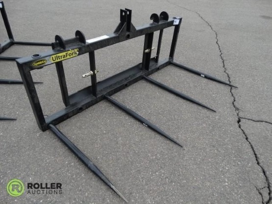

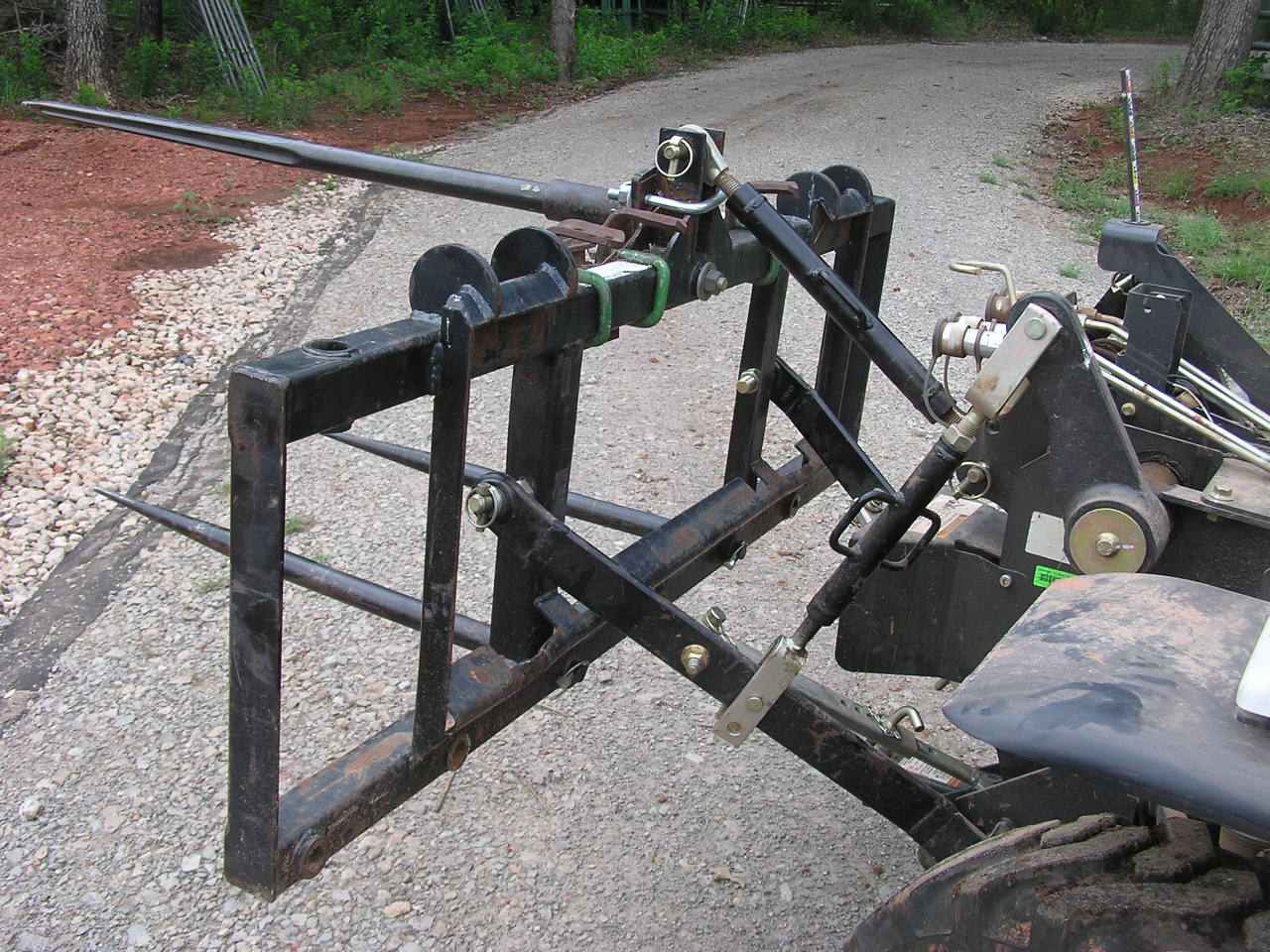

Pallet forks on a 3 point need a hydraulic toplink to be effective moving round bales.
Here is what I have, it fits SSQA and the 3 point: SpeeCo Products
I had to add a longer top spear to handle 5x6 bales:
