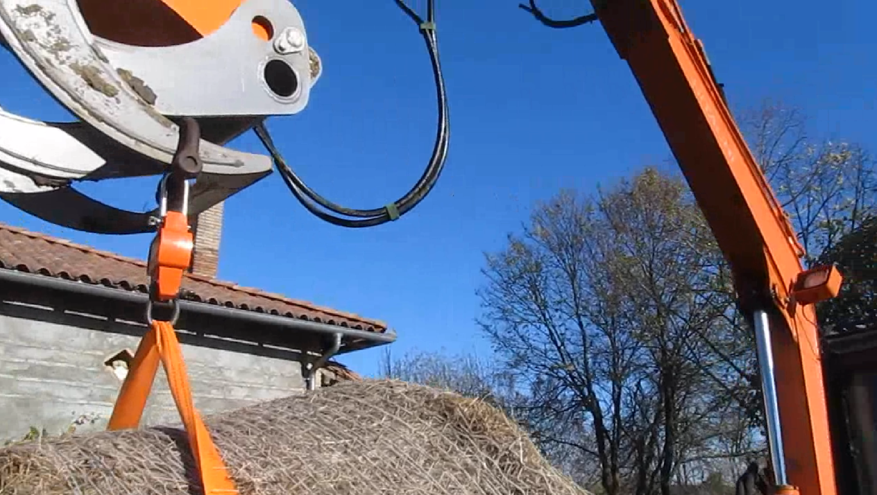

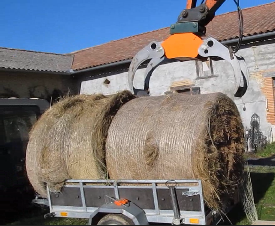

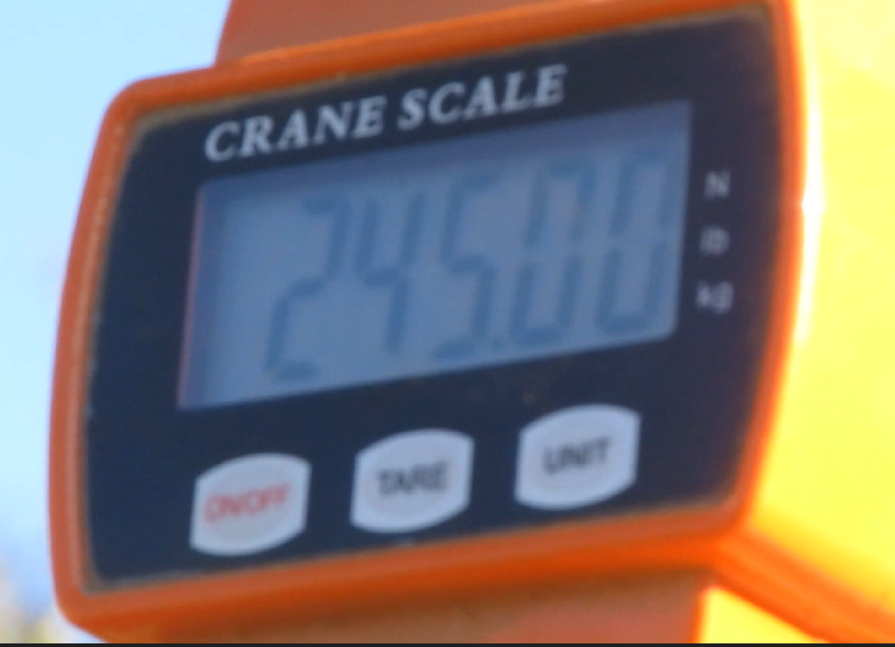

These round bails come in different sizes and also depend on type of grass that was mowed. But for a general guidance the average 1M³ bail weighs 250 kG. See photos (FR)
for reference, the trailer's interior size is 1M9 x 1M1
I used to push them off of the trailer by tilting it and then straight on a pallet, which my tractor could pickup with a palletfork on the rear of it.
