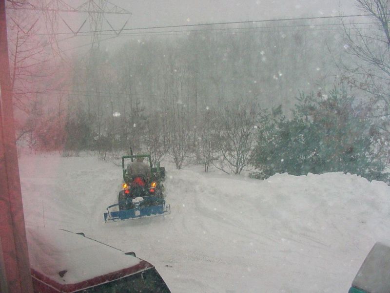

Moving snow with the loader is too slow.
I think you'll find most of us push snow with a back blade (I drive in reverse) and only use the loader for making and moving piles. I do use the loader bucket to pull snow away from the house, garage doors and vehicles by curling down and dragging it back.
But pushing snow with a back blade will eventually result in losing traction (without chains) once enough snow has acculmulated in the direction you're pushing it. That's when you use the loader to move it out of the way.
Mike must have been replying at the same time I was. The snow he's talking about is shown in the attached picture. We had about 36"-40" with drifts higher yet. Mike lives north of me, I believe, and this blizzard came in from the southwest.
I really enjoyed myself...and this snow made my wife a believer in tractors, but not enough of a believer to learn to operate it (more hours for me!)
