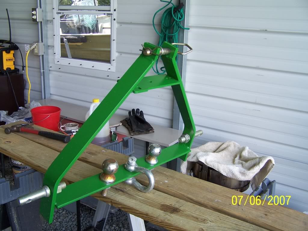

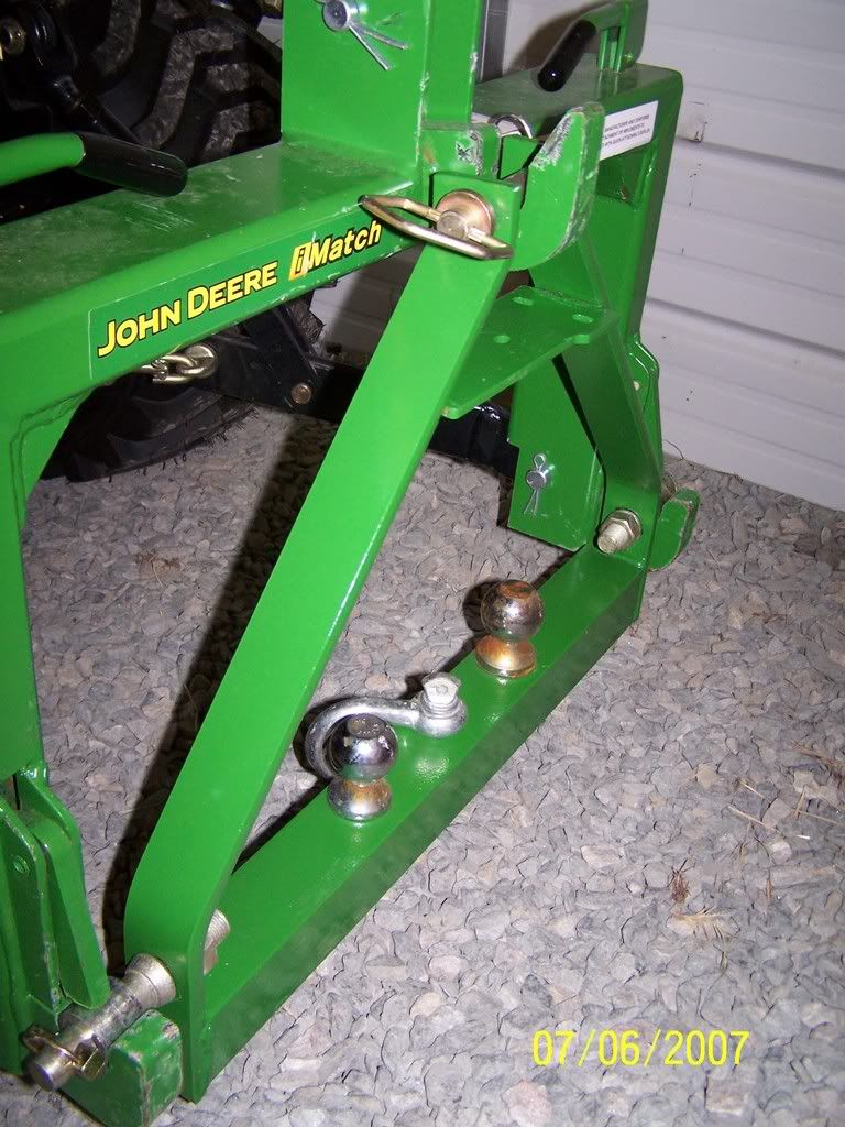

   / moving trailers #5
This Is What you need I Fabricated it myself to fit My I Match ! You Can Pyll With it also There is A Shackle In The center Plus I have 1-7/8" Ball & A 2" Ball on Hitch Bar !

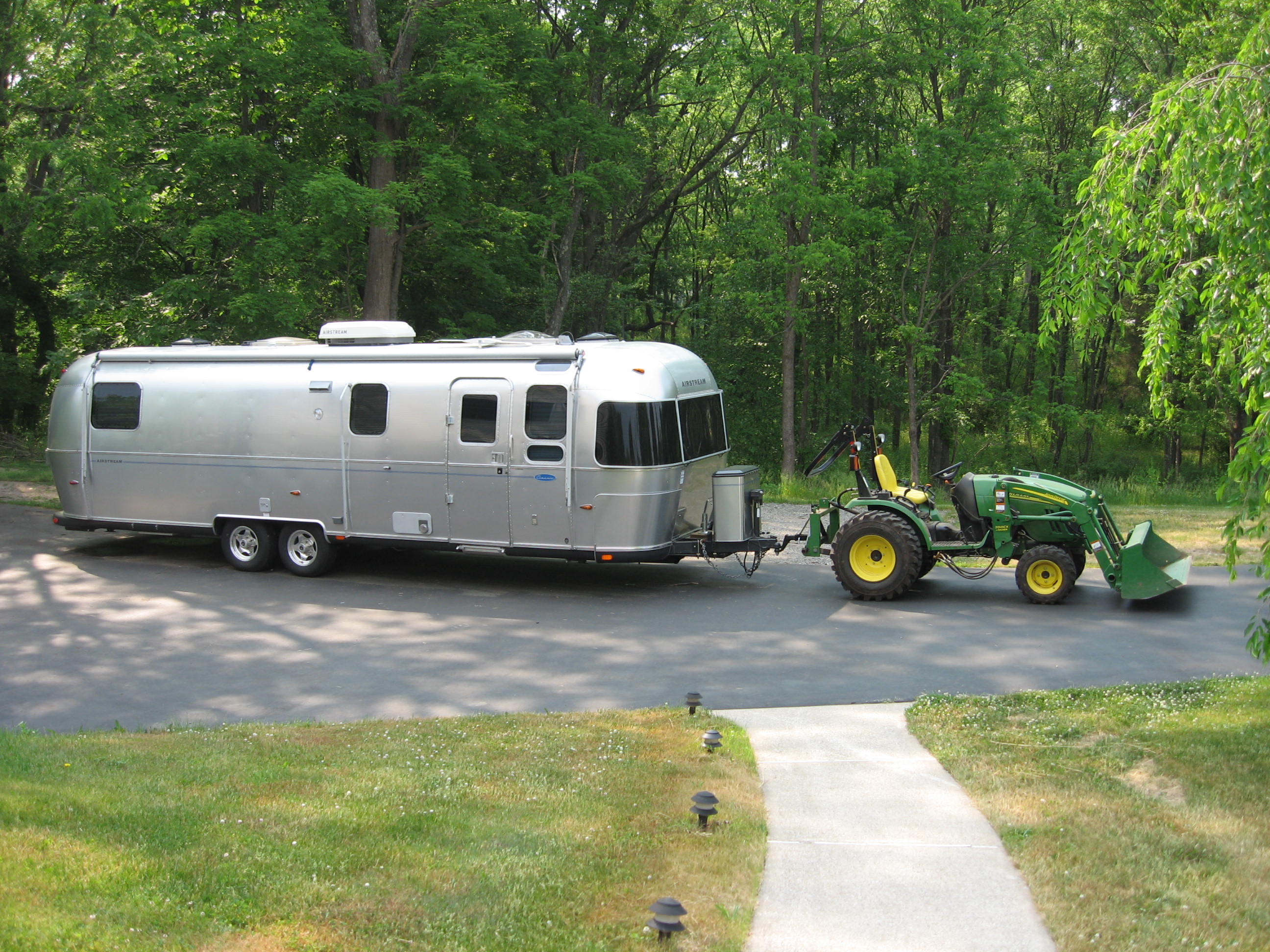

   / moving trailers #7
Here's what it looks like when you hook up one of those adapters to your 3pt and put it to work.

kvjohndeere -- nice bit of fabrication there. You've got all your options covered to pull whatever you need.
gunmaker -- that photo of JD and big trailer is great!

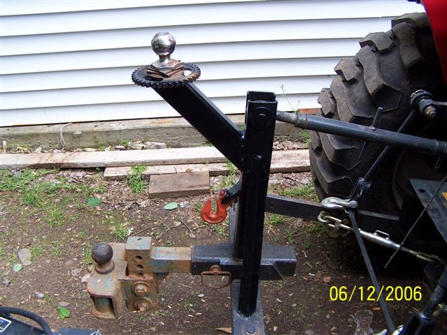

   / moving trailers #10
Here's the one I made. It may not look pretty but it gets the job done. I threw it together with what I had laying around. Upper ball is for moving gooseneck, lower for all others.
