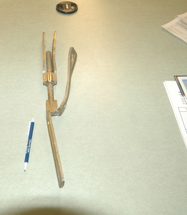

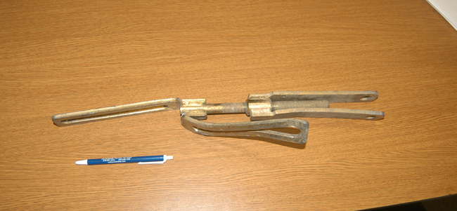

I have a 4110 J/D and last weekend a pin feel out of the linkage to the 3 pt hitch to the left arm of the deck, while going backwards the arm went under the deck. The photos shows wat is left of the turn buckle.
Question. Can this be taken to a welding shop and fixed. Or am I better getting a new part at the tune of about 110 to 120 dollars.
It seem it is about 3/8 or so very strong steel, I think.
Any welder out there that can give me some advise.
Thank for any help or ideas. Oh I already know do not do that.
Roger

But seriously, a welder can fix anything made of metal. It's just a matter of cost. On your part, it needs to have the old stuff taken off, then a new strap with slot milled ($) then that strap welded on. I'm assuming you would want the whole deal pounded out flat too. I'd guess your looking at a shop charge of around 2 hours. That means the repair cost is about the same as or a little more than, the replacement cost. Your call. I'd buy a new one and keep the old one around to remind me. Also, you never know when you may find a use for it.

I've done some welding, but don't consider myself a welder. That said, that part could be welded up. Break it off, flatten it out, weld it up. 2 ways to do the weld, either grind a full depth bevel for a full penetration weld from the outside, or put a small bit of steel over the break on the outside and weld that up. The small bit gives more edges to weld. If it doesn't carry lots of weight the bevel and weld might do it. I'd think you'd want someone with a TIG machine because it's a pretty small part.

I think by the time that you take it into a shop and they fix it up for you, you would be better just to buy a new one.

I think you might all be on to something, a new part and forget it. I think I would always be worried if the fixed one would hold out. And if it is about the same amount of money why take that road.
