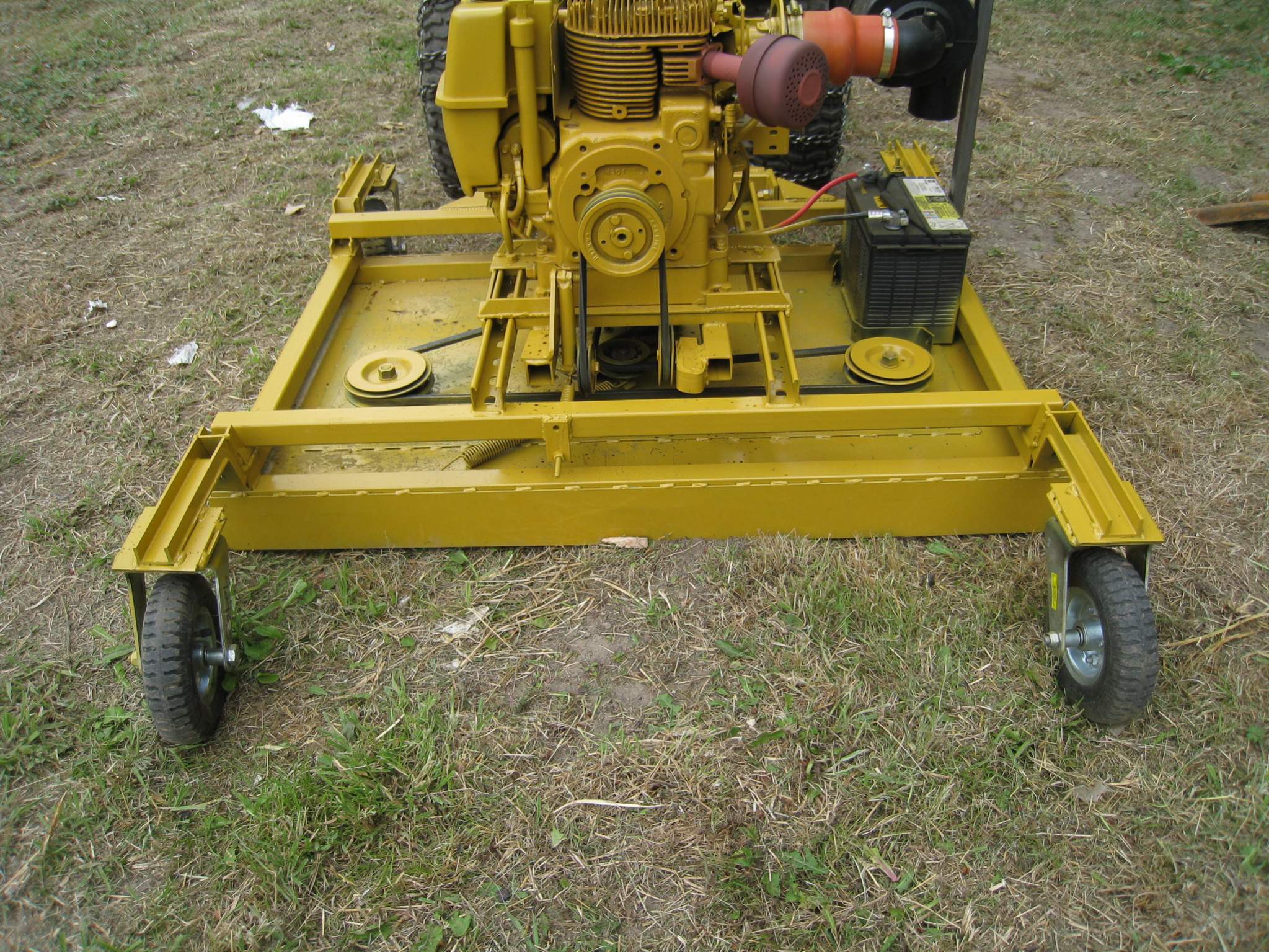

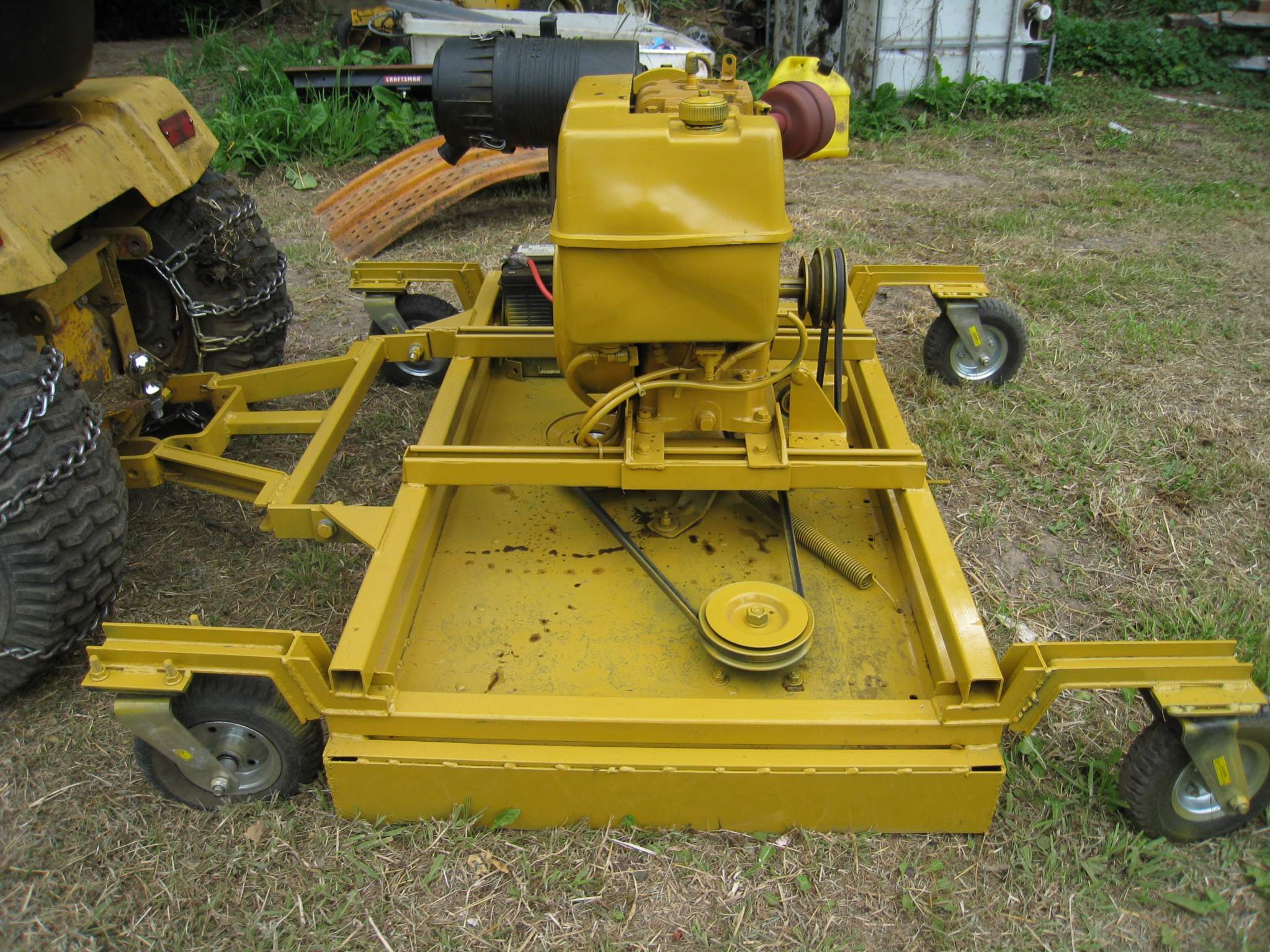

I've been lurking for long enough. Finally registered. I finally gave up trying to find a usable deck for my Cub 107 and just built my own. I didn't take any pics during the build. Most of the steel came out of the scrap pile except the MTD Spindles and Harbor Freight Wheels. The K301 was a spare for my Cub. It's 50" wide and nothing will stop it. I owe this build to this Forum. It gave me the courage to just do it.
John
   / Mower Deck build
I have about 3 hours of running time on it and the only problem is the cheap wheels. It's going to get upgraded to solid rubber tires and adjustable cutting height. Overall it's the best $300.00 I've spent in a long time. Was well worth the effort. My next project is installing a 3cyl Yanmar Diesel in my Cub 108 this Winter. I'm on a roll why stop now.

Nice work!
I share your opinion of the cheapo HF wheels/tires. I tried them for gauge wheels on my rear blade and they lasted about 30 minutes before blowing out.
Is there a way to adjust the mowing height? I'd imagine it would be easy enough to just put spacers between the top of the casters and the mounting plates.
Have you thought about making an offset hitch to get increased mowing width? A guy who lives near me mows about 4 acres with such a setup and it seems to work well.
Thanks for posting.

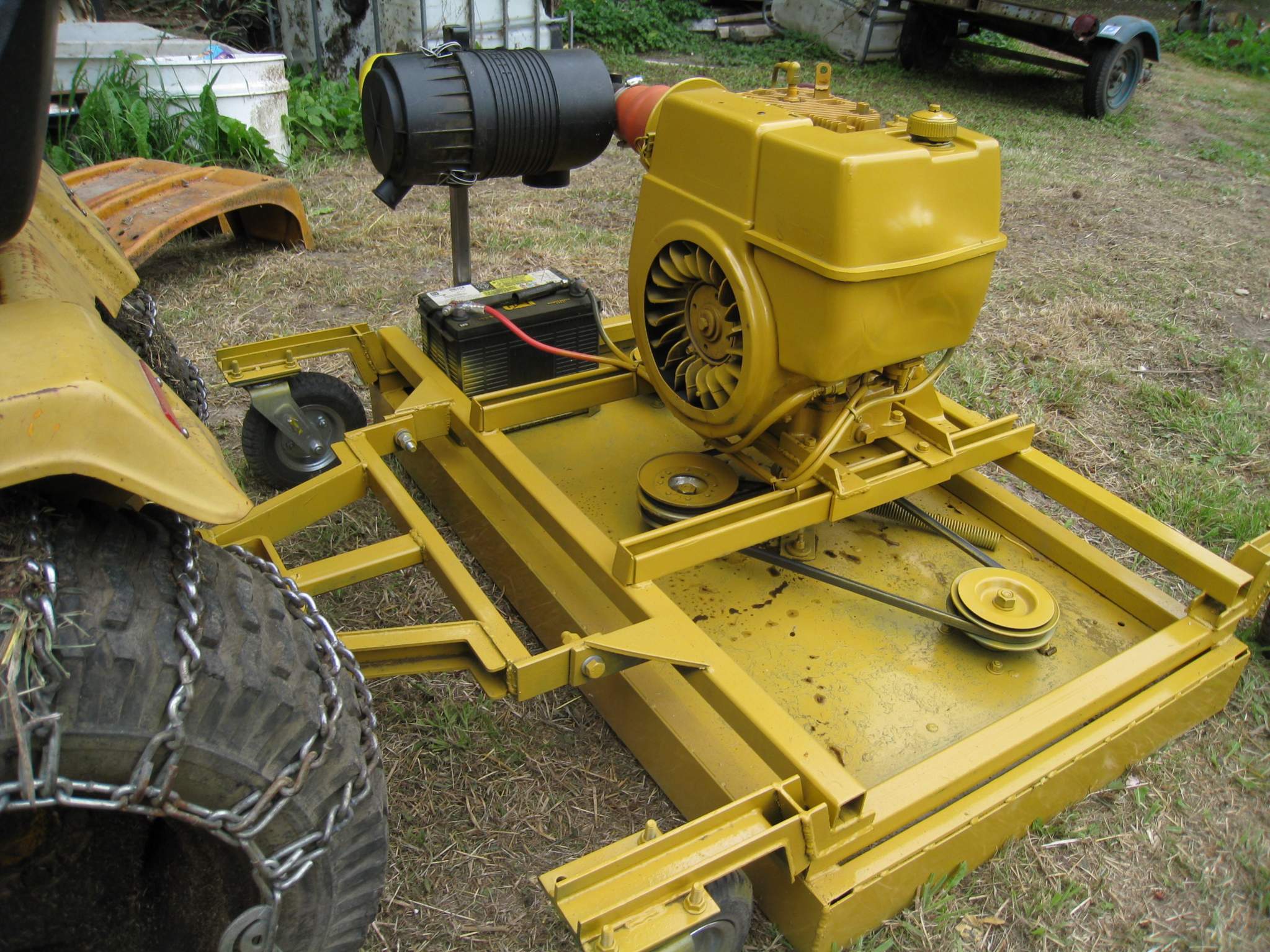

Nice job.:thumbsup: Where does the grass discharge.
Bill

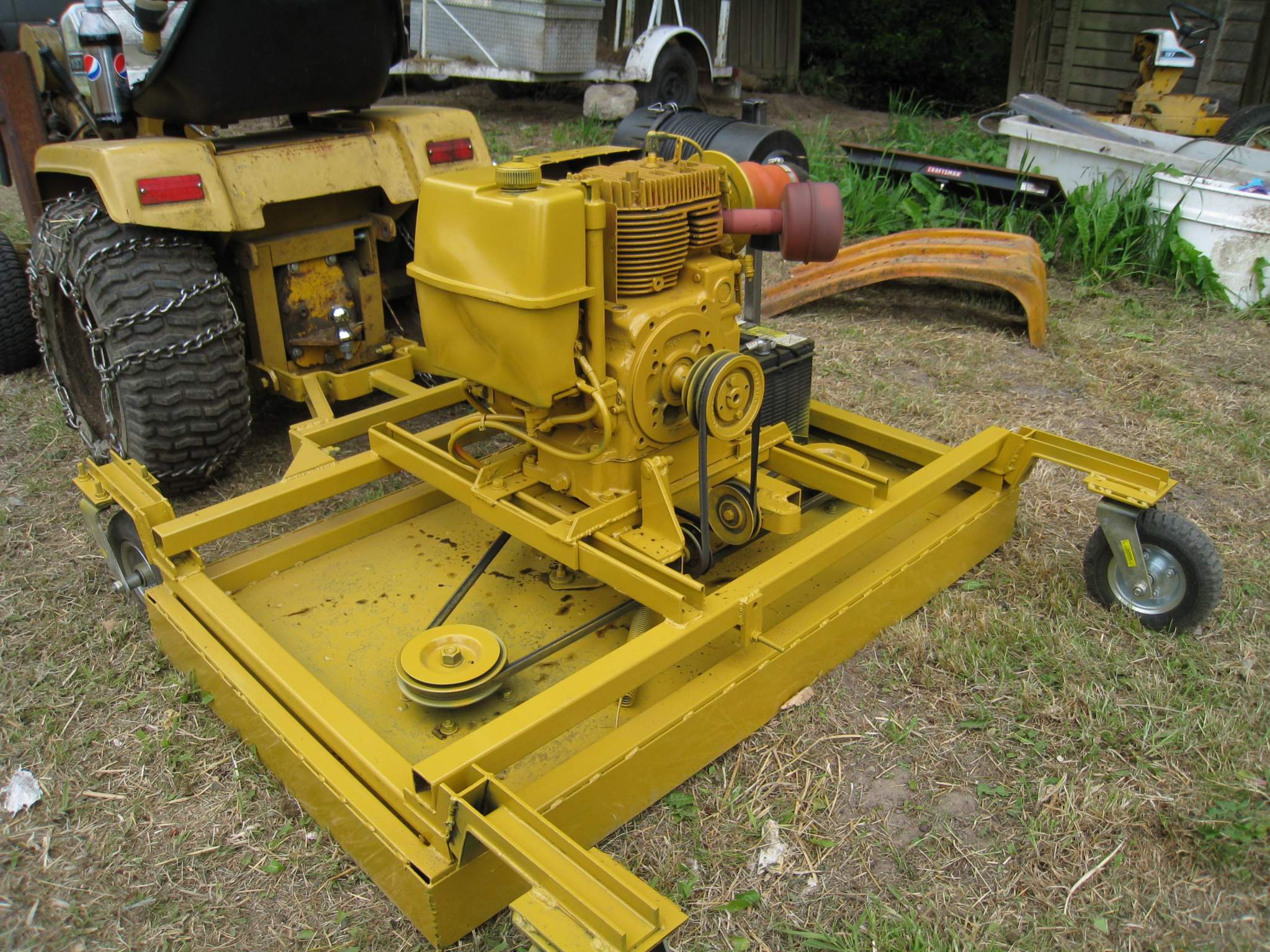

   / Mower Deck build

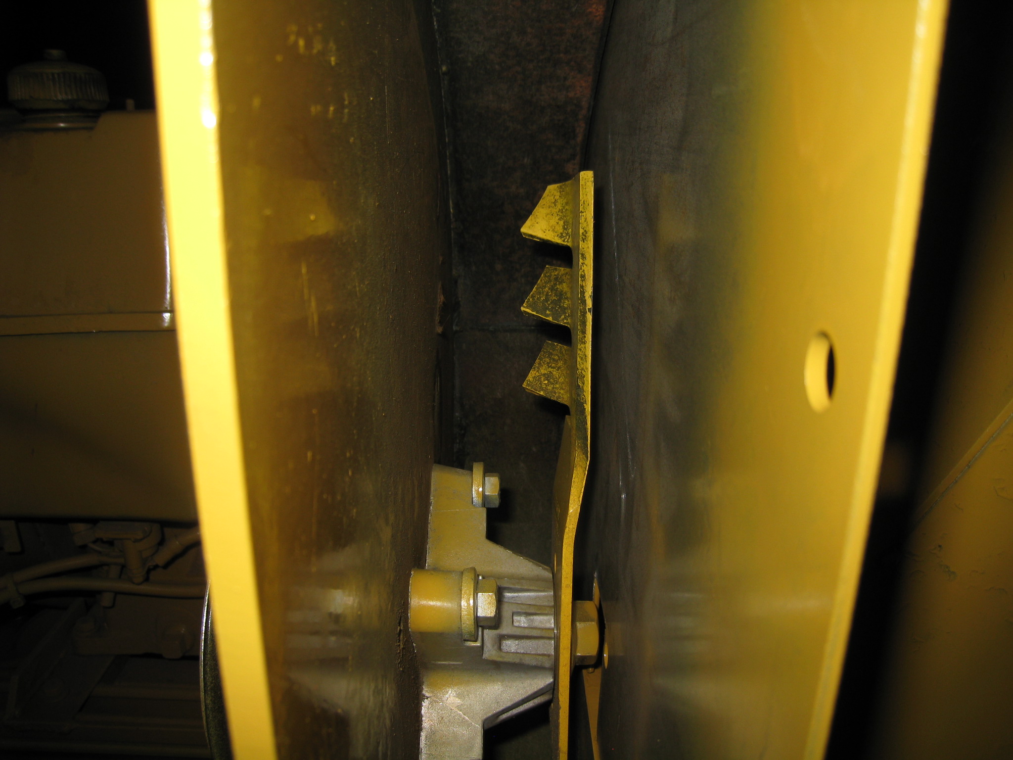

The discharge is under the Battery. Here's a low resolution pic of it.
Once I replace the HF wheels I'll separate it from the tractor and take some better shots including the underside.
One additional item still to be added is a small Wood Chipper driven off the K301 on the side opposite the Air Cleaner. That way when I'm Mowing and come across a small branch I can stop, engage the Chipper and dispatch the offending item.

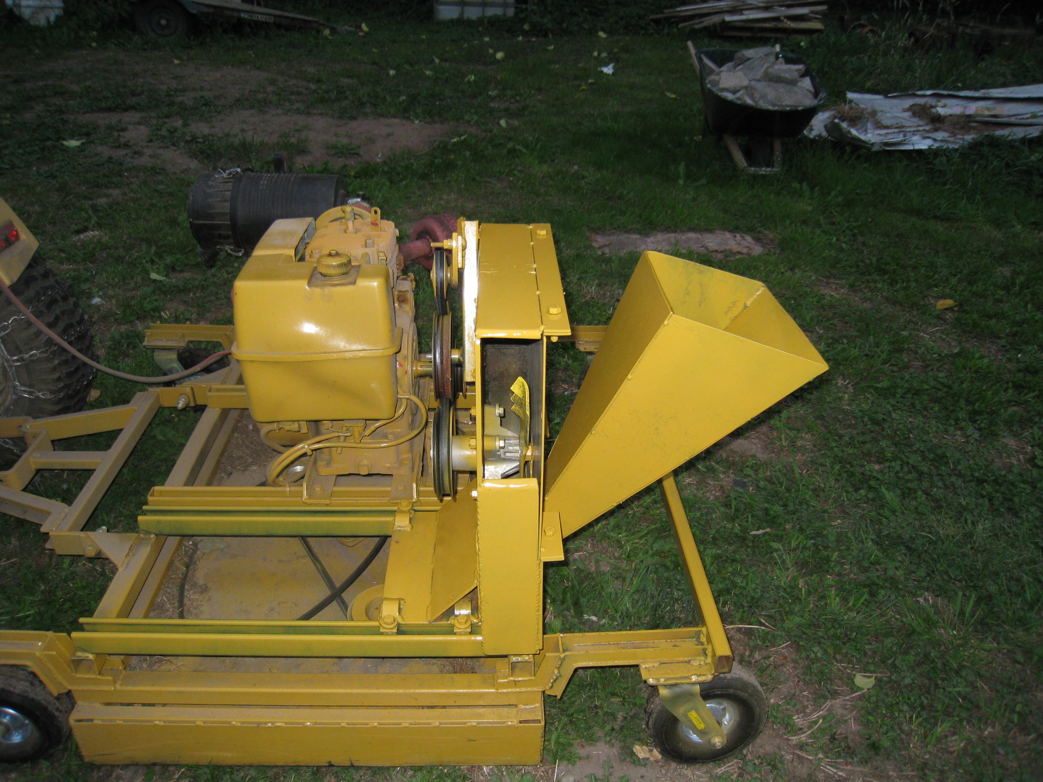

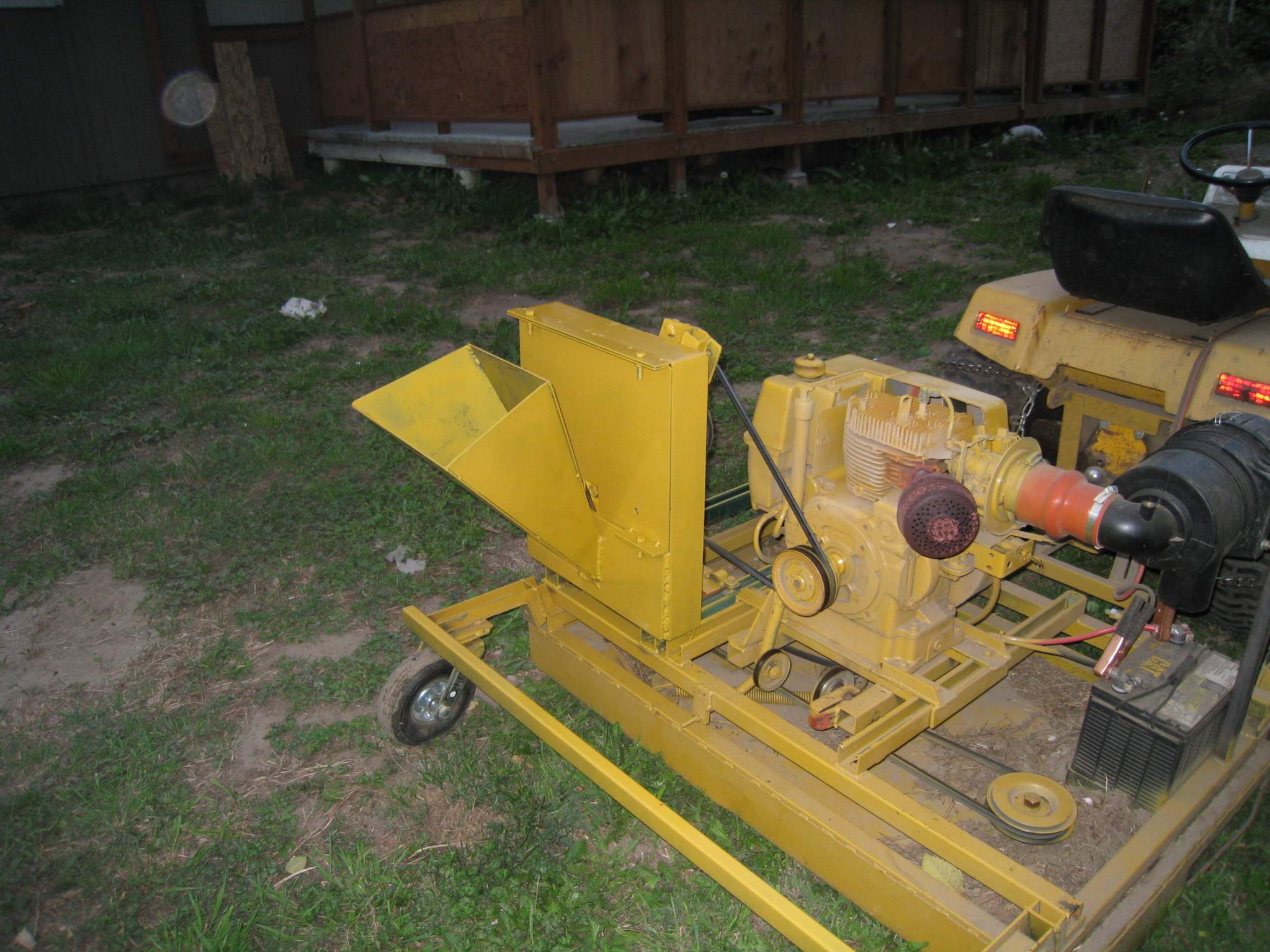

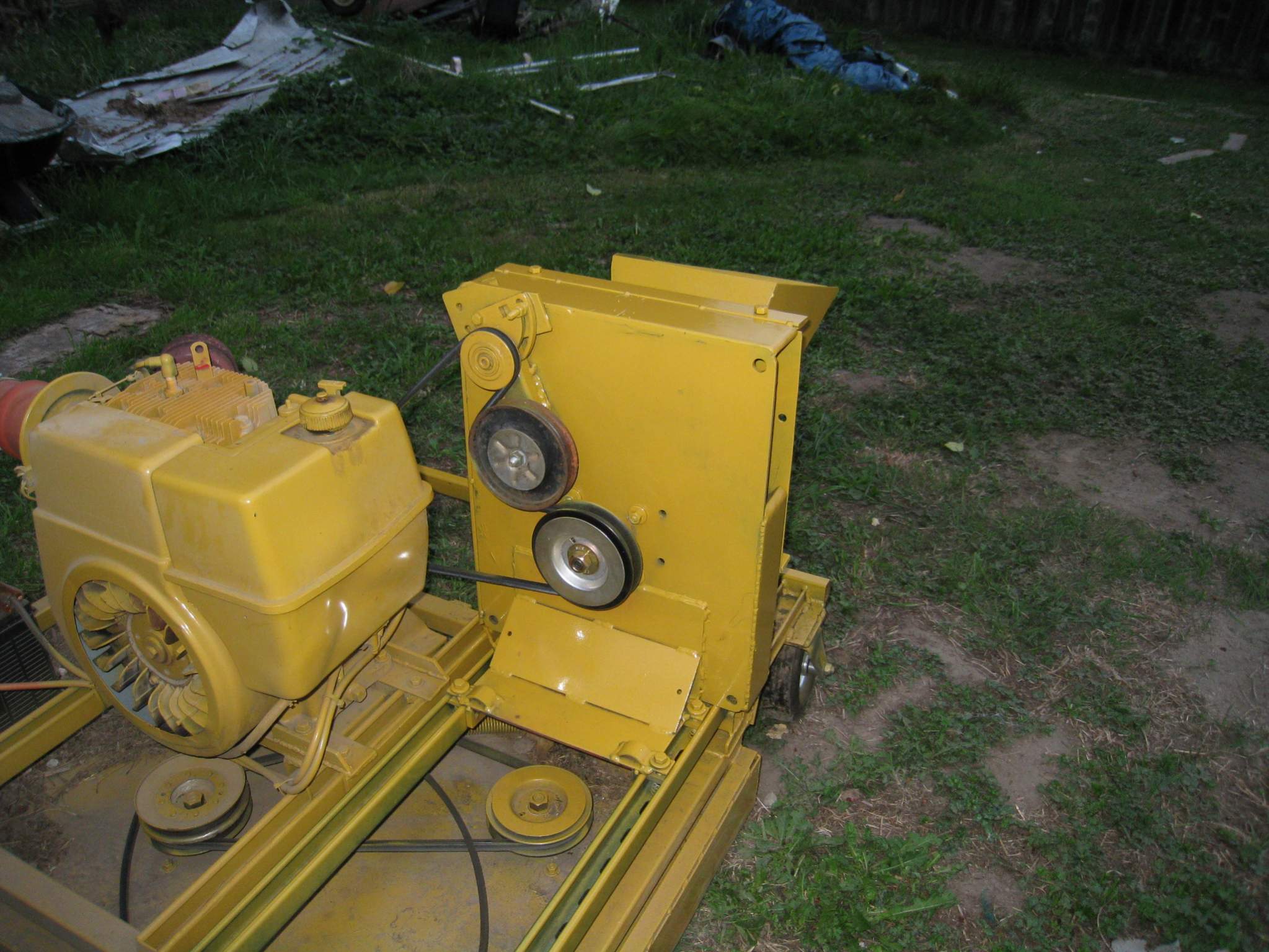

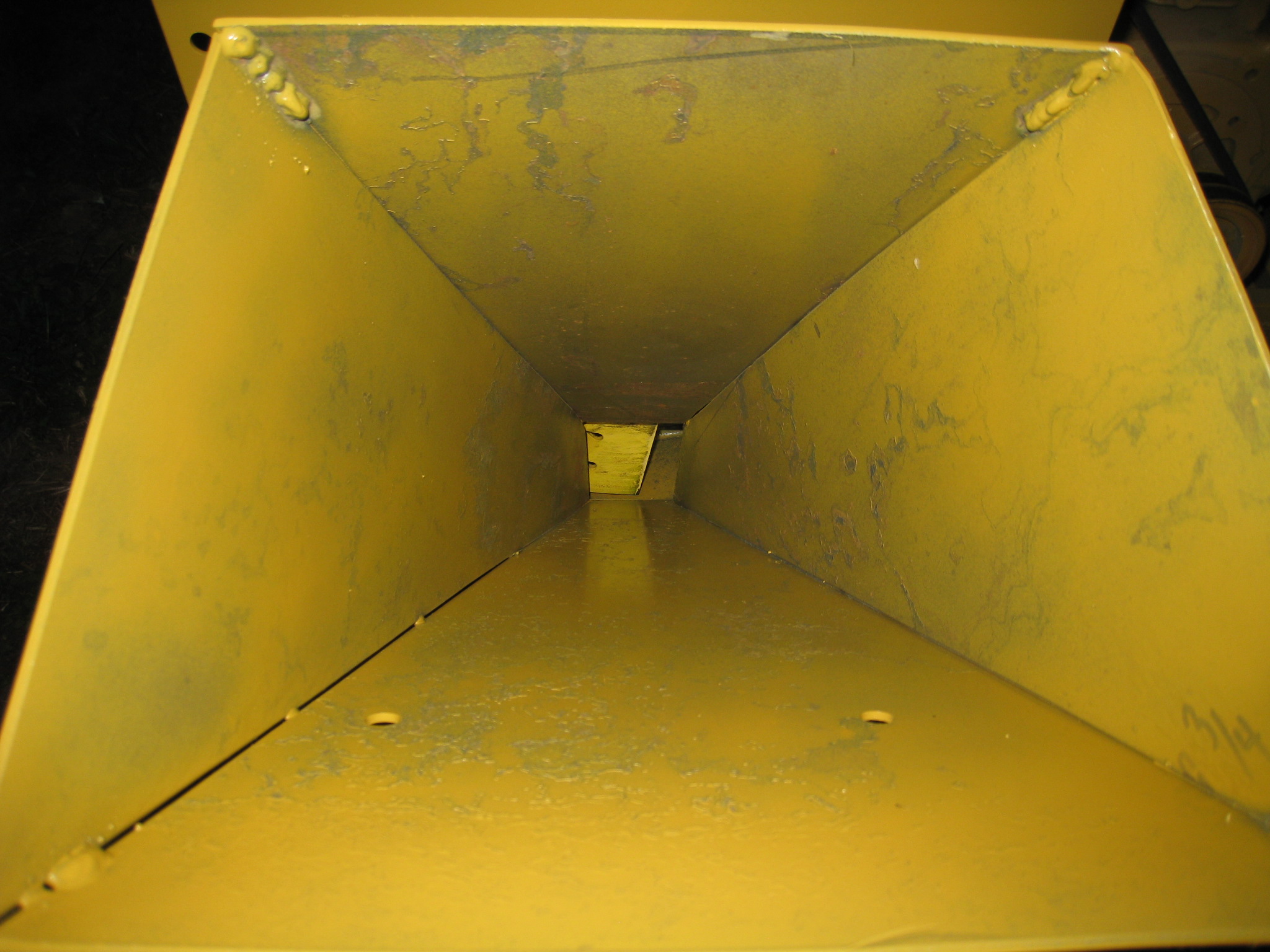

#15

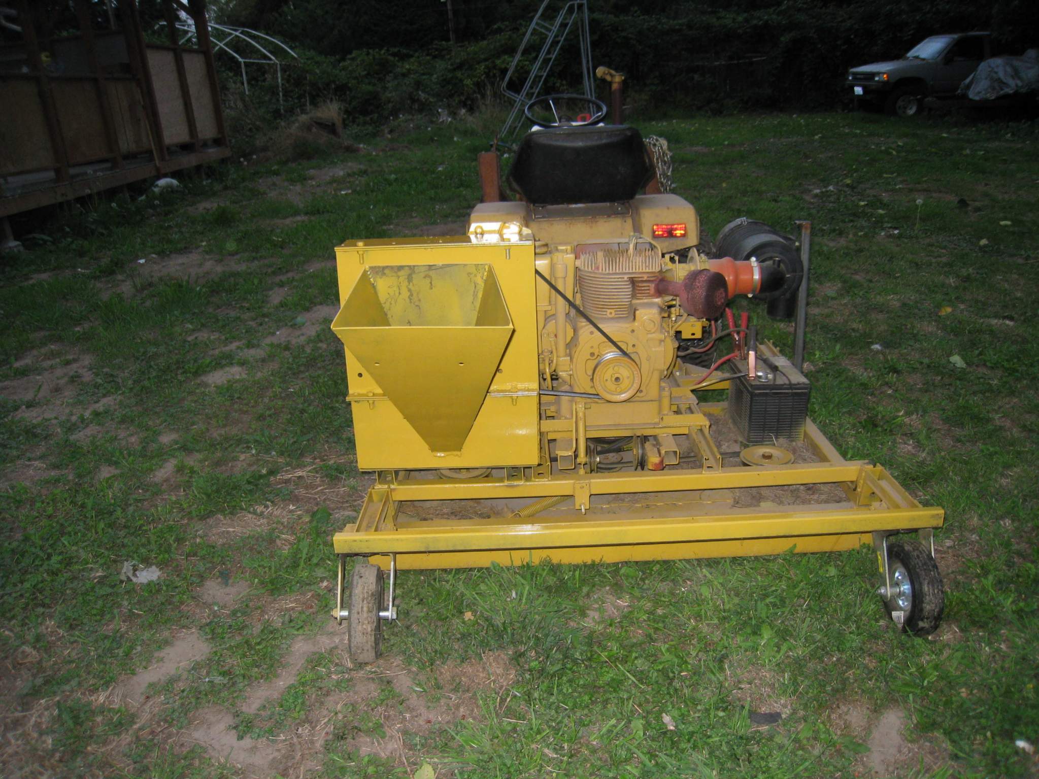

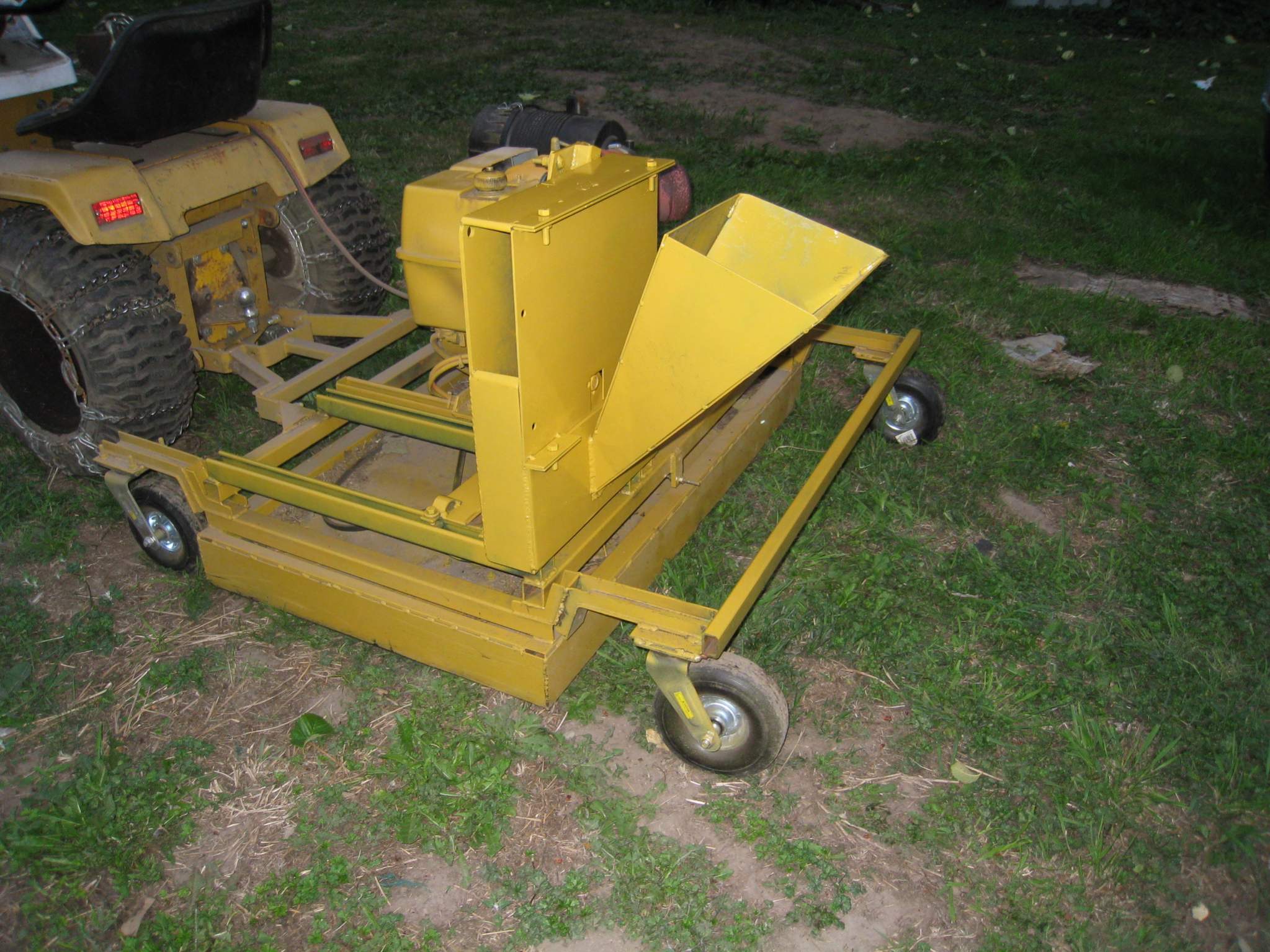

Well I finally changed out the wheels to solid rubber and it cured all the problems. I've been working on the Chipper addition and the only thing remaining is to go back and finish some welding on the Chute and a few small areas. Rain is on it's way here this weekend so I reluctantly threw on some paint to keep the rust down until I finish the welding. Oh I did run a bunch of DF branches and Blackberry vines through it. Works great. Some of the Branches were 1" and above. Didn't even slow it down. Keep in mind this was designed for light duty. I'll post some final pics once I finish it. I like this multi-purpose machine thing. I'm thinking the next accessory will be a 1/2 scale Buck Saw. IMG_2064.jpg

I, like others just saw this post. Nice build!!Probably the only thing I hesitate in appalding you on is the choice of spindles, but understand that was probably due to using what was on hand. I did a larger version (7' 6") to pull behind my Ford 1100 13hp 4x4 tractor and used boat axle spindle hubs (3500 pound cap) with custom made spindles. The deck got traded for some electrical work that I needed done before I ever finished it, (but I had to finish it as part of the deal) so I never got to try it out. Since I still have 3 of those spindles, maybe I need to start another deck project.... (NOT!!!)
I especially like the addition of the chipper!
