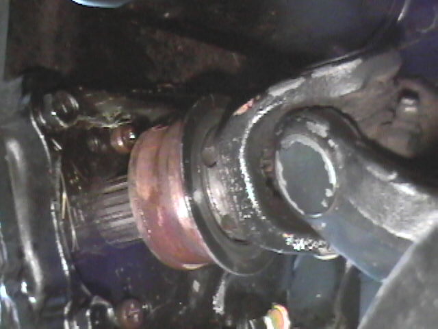

Here is a series of pictures

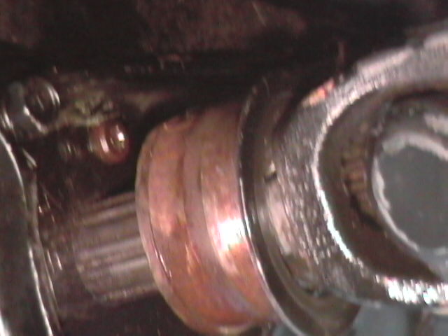

Another view

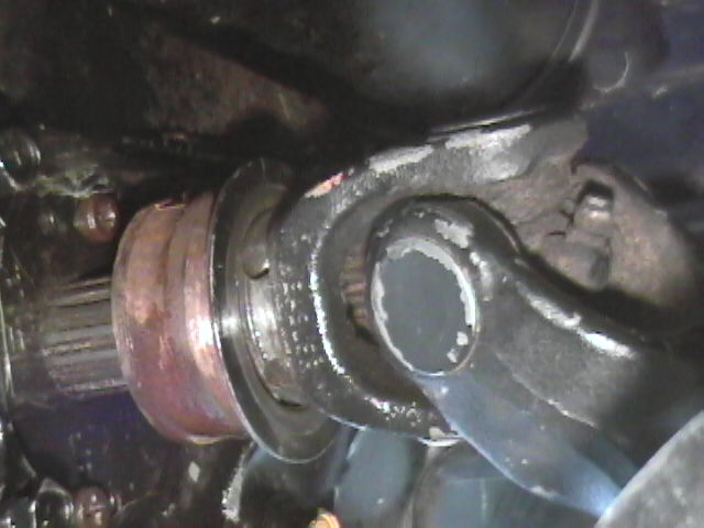

One more

Nuru, that looks like a quick-disconnect attachment where you push the outer housing away from the ball bearings against spring tension, allowing them room to move out of their groove, however it looks like it is lacking for lubrication. I would lube the bearings and housing with heavy (80-90wt) oil and go at it with a rubber or plastic mallet to try and free up the bearings.
All it takes is one stuck bearing.
   / Mower Deck Stuck on Spindle
normde2001; that is what I thought, but the holes where the ball bearings go, are empty. I sprayed it with WD-40 to try and loosen the area up, but no dice yet. I moved the MMM out of the way, so I could get closer to make observations. The holes you see are empty, so I do not know what is hanging it up at this tkme. I have the replacement collar, spring, and ball bearings, so I can repair the until when I get the old one's remnants off.
