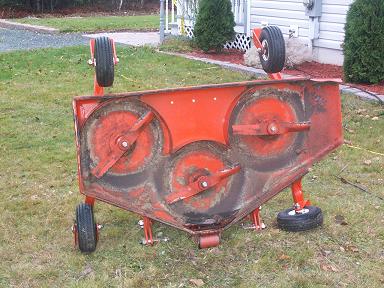

Hi Jim,
I'm running Kubota RCR48CA Rear mount Finish Mower on the BX. I would strongly recommend this unit to anyone. Minimum time to install & beautiful cuts everytime. As far as wider one than a 48", the unit may be to wide for the HP & harder moving around. The rear discharge would be a great suggestion (I have the side discharge)
Hope this helps...
