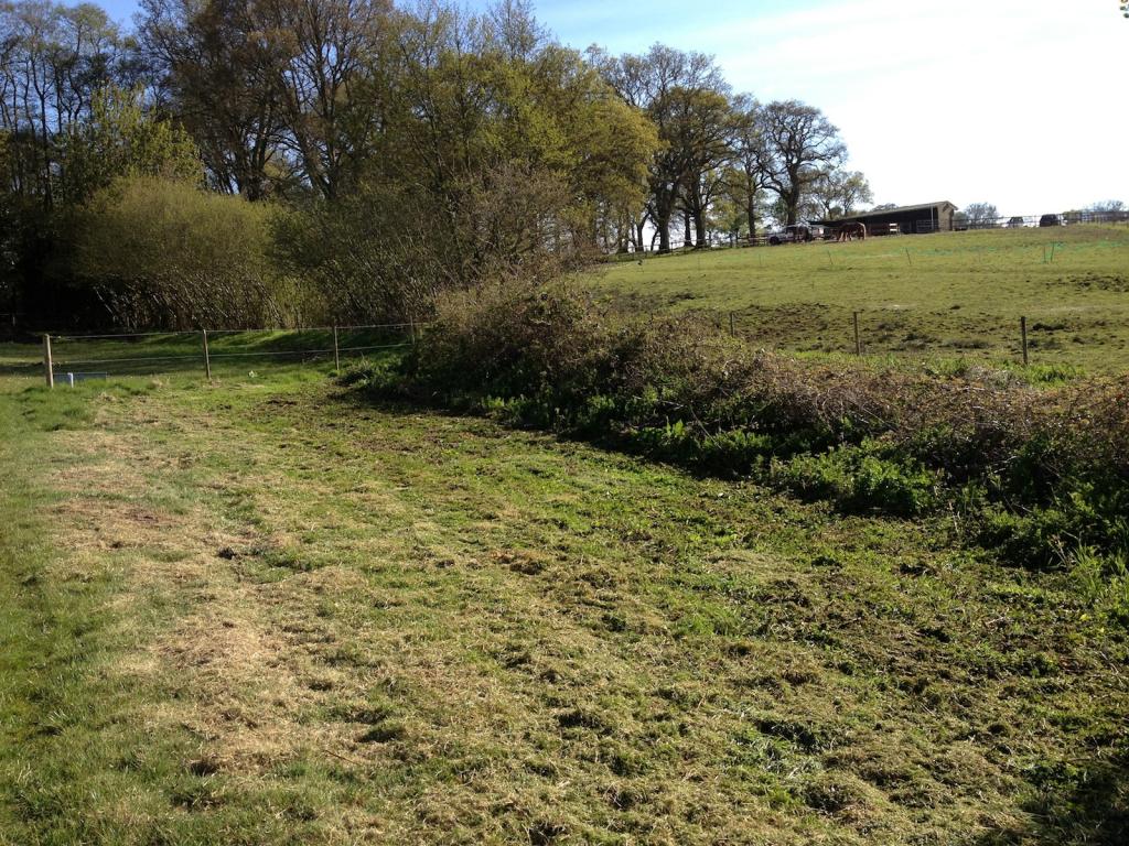

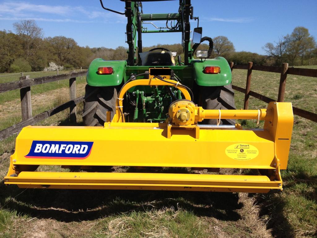

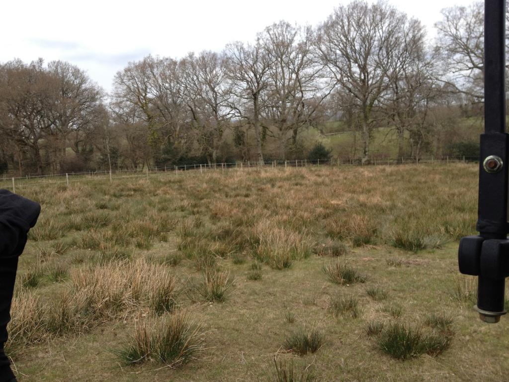

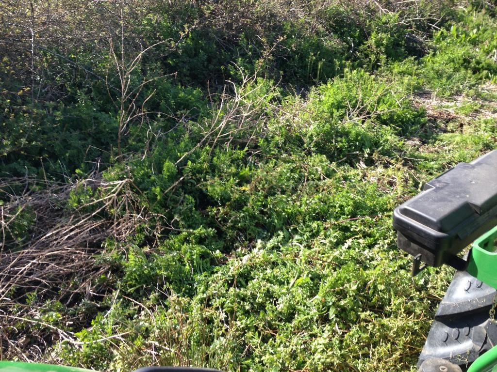

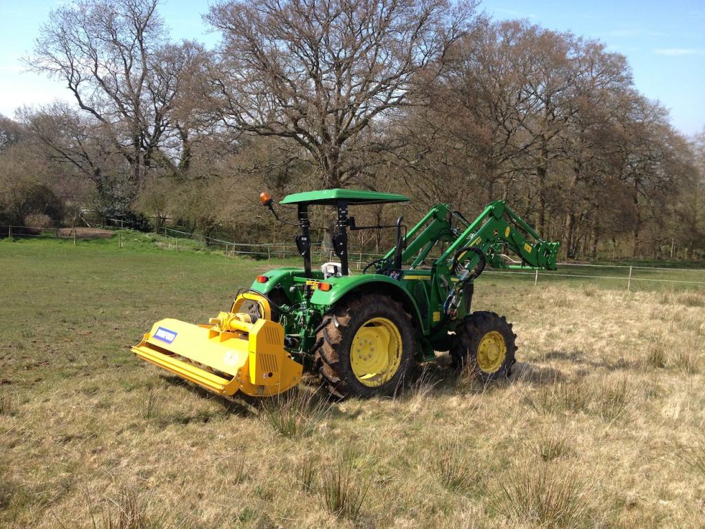

I use a flail mower for cutting heavy grass and rushes. The cutting width is just under 8 foot and the tractor handles it fine, except for the really thick rushes. I need to lift it a bit and then go over again. Mine also has a hydraulic offset, which comes in very handy to get close to fences.
With enough power a flail mower can cut really low. You can get light duty and heavy duty ones.
The pictures don't show it very well, but these are very thick rushes
This is brambles and all other kinds of weeds
