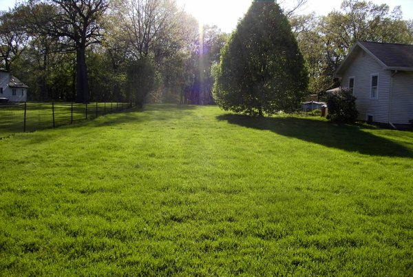

I posted these photos back in 2002. As I said before, it's not the best mower, but it works well enough for my needs/wants.
Before
After

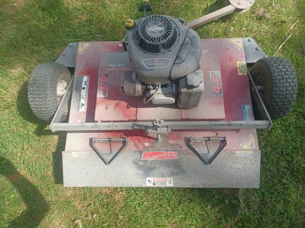

In the market for a mower myself. What about a tow behind mower?
My area to mow is not that big. This one does a 44 inch cut.
Guy wants 850.00 for it??
