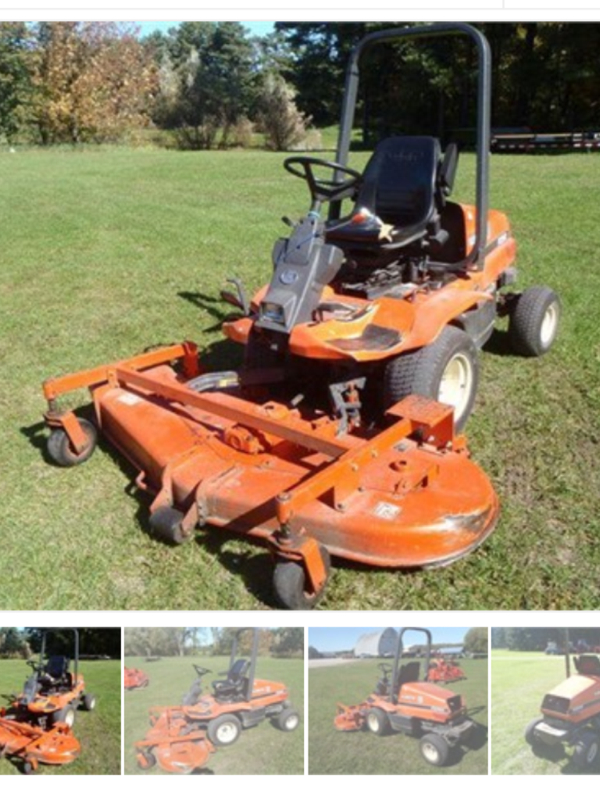

I have two Kubota B7100's. One has a belly mower. The other has a finish mower. I am hard on both tractors. One has 1900 hours the other has 1180. They both run as good as new. I bought them used for $3500 each.

I have a Kubota F series mower, but I like the B7100 better for rough ground. My rough ground has holes over a foot deep. If you have hills or mud the F series has terrible traction. For your budget you can find a used diesel mower. I would not get a gas .
