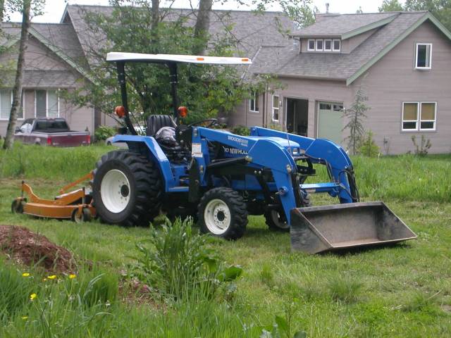

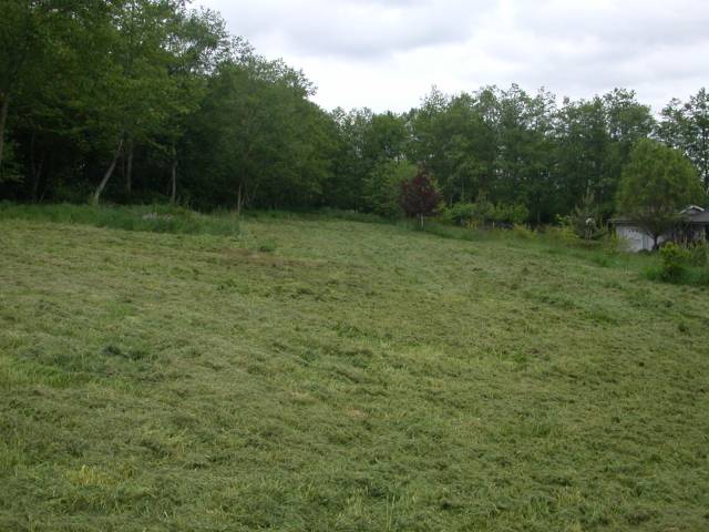

I have read lots of questions about mowing fields with a finish mower, and since I did just that this weekend, I thought I would share my experience. Since my TC30 came with a Woods 72" Finish mower when I bought it used, it made my decision very easy /forums/images/graemlins/smile.gif
You can see from a few attached pictures, most of the field was waist high and thick. The field is about 3 acres, and was formerly a cow pasture. It was fairly rough, so I set the mower as high as it would go. Put it in low and took my time. The mower didn't bog down much except for a few of the steeper hills where the grass was thick. I had so much fun I mowed the neighbors field at the same time. I will certainly keep it shorter and I am sure it will have a nicer cut.
I think my tractor was actually grinning in this picture.

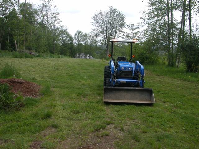

This was the tallest part of the field.

Here is the tractor and finish mower. I really like the Woods mower.
