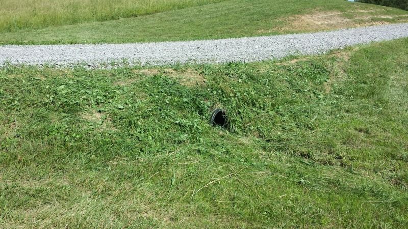

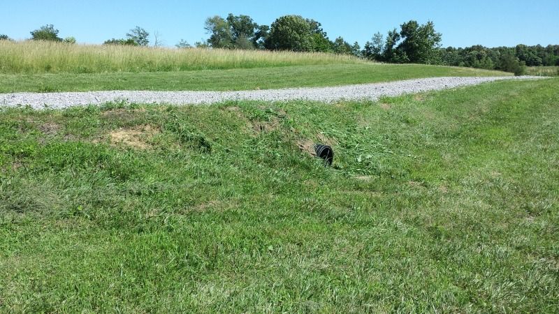

Part of the purchase of my current house was a new driveway, since I bought this out of a larger parcel of land. I said...I don't like weedeating, and wanted the culverts set in to allow mowing around them. Well it didn't work out. Irritated about it, but it is what it is, and trying to figure out how to change or should I say improve the mowing ability around these culverts in my drive.
Pictures below...you can see the longer grass that I just weedeated. BTW, fell head over heels down the steepest one. The ground is a bit irregular, needs work, but my age didn't help matters. SO...this post starts the process of how I can improve it.
I've thought of bulkheads, rock, more dirt for larger 'wings' so the slope is more gradual and the mower will work. Looking for ideas on how others have done this.

get some bags of concrete & fill around them with that then build up dirt to level & seed with short growing highway type grasses or wild flowers & let it go...
   / Mowing around culverts #3
I install road culverts all the time. There's no way to install that culvert so you can mow over it with a regular lawn mowing machine. Tractor and brush cutter maybe.
Next point. Isn't that plastic dual wall pipe???? If so, crank up your chain saw and cut the culvert to match the slope of the bank. Then mow over it.

You could put extensions on each end to give you room to make a more gradual dirt slope. They make rings to attach extensions.
I mow in this area with Kubota ZD326. The slope is to much for the ztr. Right now I'm thinking of adding dirt to create larger wings with a slope the ztr can handle. I much prefer fer a mowed finish look since it's my main drive.
And actually the steepest one have those extension .. Should of seen it before they were put on.
   / Mowing around culverts #6
I have a 4ft fill on my driveway. plastic culvert is cut so it fits the ground. Almost functions as a dropped inlet. Can't see my culvert at all now. Just gotta watch and not drop a tire in it. Plastic culvert makes anything doable. You may hafta haul in some dirt on the steepest one. Hard to tell in the pics.

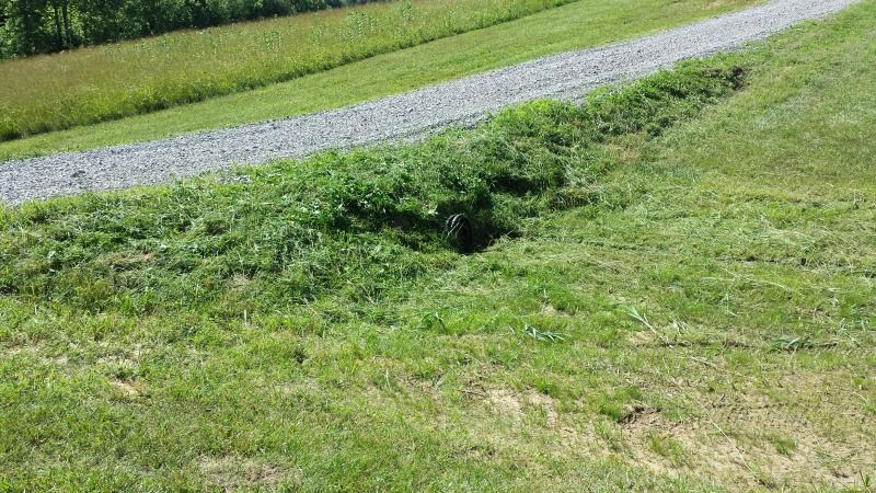

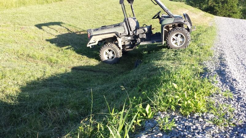

Now I'm thinking more, had to go out and study it a bit. Really hard to get the perspective of a slope in a picture. Here is the worse culvert, different perspective. The slope in the background I mow with the ztr.

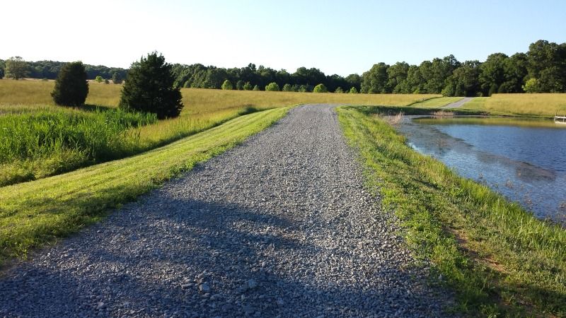

More perspective of trying to capture a slop in a pic. Here is a different portion of my drive that goes across a pond dam. The outside mowed area I do with the ztr...but it is 'crabbing' and I can see the grass is starting to wear where the lowest rear tire is tracking. The inside slope, I mow with a sickle mower. About half way across the dam, the ztr would slide, and with the water there, just feel uncomfortable trying to mow it. But, in the picture, doesn't look that steep.
