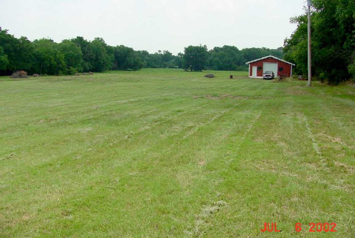

While this is my first post, I have been hanging around awhile, getting lots of good advice from all of you, both on deciding what tractor and implements to buy and techniques for tractor use. Thanks to all of you for this!
Now I need to purchase a mower to hang off the back of my JD990. I will have to rough cut about 15 acres, which used to be a corn/soybeans field, so no real issues with rocks, stumps, etc.
It is now a newly rototilled, newly planted rye/clover field with an oats nurse crop. I will need to clip the oats tall, but once it is established, I want to maintain it as a nice looking area, but not "front-lawn" quality. Eventually much of this will be growing plots for a small perennial plant nursery, separated by 20 foot wide paths of the grass.
I have another 10 acres I will plant hardwood seedlings into, and will need to mow until the trees are established.
I am considering 3 options:
1. rotary cutter (keep the blades sharp, PTO speed up and tractor speed down to get a good cut)
2. finish mower (same as above, plus lift as high as possible to get through tall, thick stuff when needed)
I suppose buying both 1 & 2 is the ideal, but cost, maintenance, storage space, etc. are a consideration. So I am also considering #3, but don't know much about that option:
3. flail mower
Any suggestions or opinions?

I would go with the rotary cutter. I use a Howse 6' light duty to mow my pasture and ditches. But I sometimes also use it to do brush clearing as I reclaim my overgrown creek areas. The pasture cut looks pretty good as you can see from the picture. I did let it go a little long and got some "windrowing" on this mow.

Thank you all for your suggestions. The deciding factor was the photo BB_TX attached. The quality of cut from a rotary cutter seems good enough for what I have in mind right now. My wife agreed that a finish mower may still be in our future, once our nursery business gets going.
