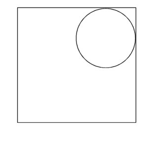

As for the corner issue, I have one inside corner that I mow. I approach it along one side until the mower hits the side in front of me. I back out, swing around and approach it along the other side until the mower hits the first side that I mowed along. Look at the attached picture. The point from the inside corner to where the arc of the blade stops on either side is about 10 inches. That's not too bad at all. I think my 20 inch push mower leaves a similar arc on inside corners.

Your diagram illustrates what I thought would happen. What I couldn't tell was the dimensions of the uncut remnant in the corner. Your mowing technique was exactly as I had planned to do it . I have 6 inside corners to cut so this is something that I have been giving some thought to.
