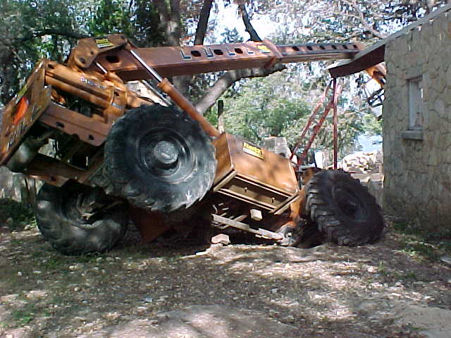

I don't know, but here is what happens if you guess wrong/w3tcompact/icons/blush.gif.
Thank goodness this is my brother's work and house - not mine/w3tcompact/icons/grin.gif

The machine pictured is a motorized manlift or forklift.. those are rather heavy.... much heavier than tractors...Also.. factor in if the lift was carrying any extra load ( like trusses, etc ) Shock load is another issue. A static load is one thing.. but a sudden shock load ( loaded vehicle carying a swing load.. slams on breaks.. etc ) introduces other factors.
Soundguy
" don't know, but here is what happens if you guess wrong.
Thank goodness this is my brother's work and house - not mine "

Yikes..I bet that cost little in repairs to the building,and a bugger to get the fork lift out.
