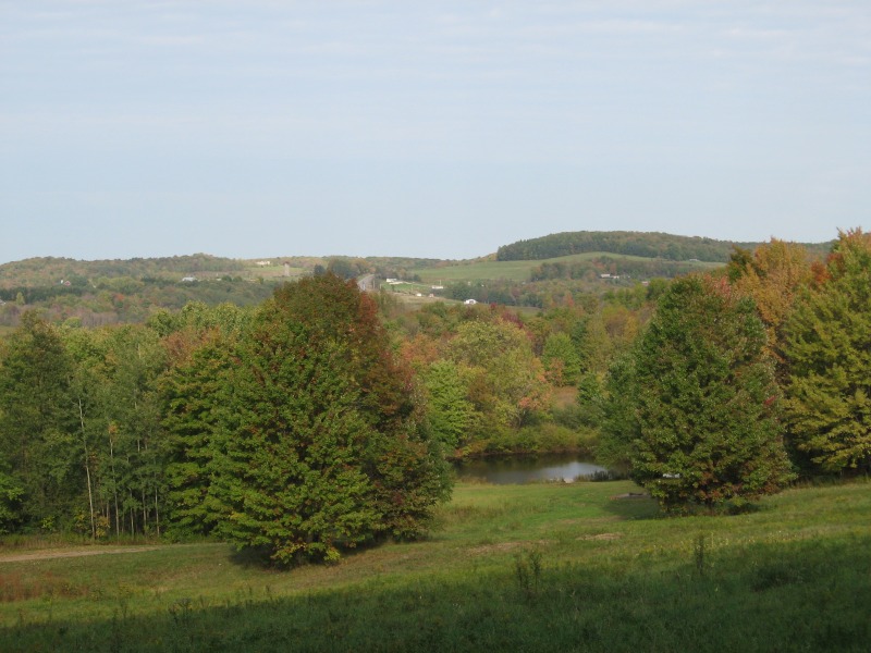

My place is very hilly with about 60 acres of woods and the rest in old hay fields. I learned a long time ago to "hog" up and down the hills and not sideways. It makes life a lot easier.
The attached is one of the hills I mow, you can get an idea of the pucker factor if I didn't mow up and down

Toad,
Beautiful property, and I agree, if at all possible mow up and down any hill.
