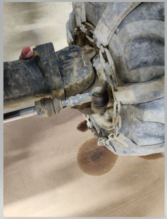

I was wondering if anyone can give me advice on what is leaking and what I would need to do to fix it. The dealer is an hour away and I have to pay to have it picked up and delivered so rather fix it myself. Capture.JPG
   / MT 125 Leaking from Front Axle #2
Looks like the upper and / or lower pivot seals. First clean it up real good, then see where it is coming from. With the dirt on it like that, it will seep throughout the dirt, making it hard to pinpoint. A time consuming job at the least, needing careful reassembly of all the internal gears and seals. You can YouTube replacing tractor front axle seals to get an idea what you are in for.
A question... is the tractor still under 2 years old? If it is, it is covered under the two year bumper to bumper warranty.

I got under the tractor and found the drain plug which was falling out and very loose. I tightened it and clean the area but I'm pretty sure it's fixed. Glad it wasn't the seals since I dreaded the idea of sending off my tractor for repairs. I only have 122 hours on the machine and in that time -
