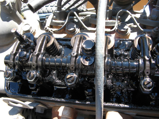

Bill Rodgers can tell you what it is. He told me many moons ago and I can't remember. It is metric but has a different pitch and thread count. Same threads as a lug bolt.
   / MT160D #142
Bill Rodgers can tell you what it is. He told me many moons ago and I can't remember. It is metric but has a different pitch and thread count. Same threads as a lug bolt. The sludge could have something to do with your oil pressure. You might want to pull the oil pump and check it out.
   / MT160D
#143

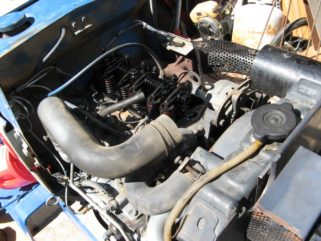

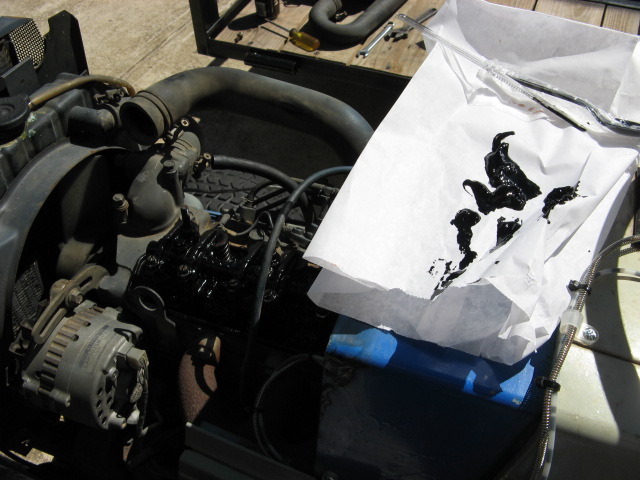

I'd rather not bother him if I'm not buying the bolts from him. Since I have a sample I'll try the local fastener store sometime this week and see if they have the things. Threads in the empty holes appear to be OK.
Also "backed-off" on the idle limit screw on the governor, since the engine idles too fast when hot (1250 or so). It needs some throttle now to idle when cold but I need to try it out in the field to see if the hot idle is much slower.
Looking at some sludge-remover products to see if i can clean out some of the sludge @ the next oil change.

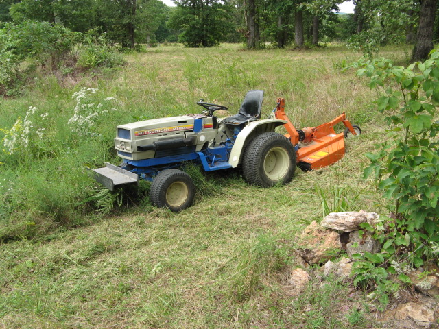

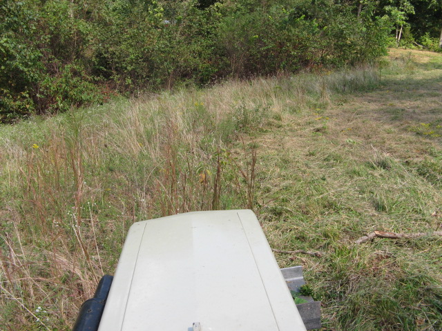

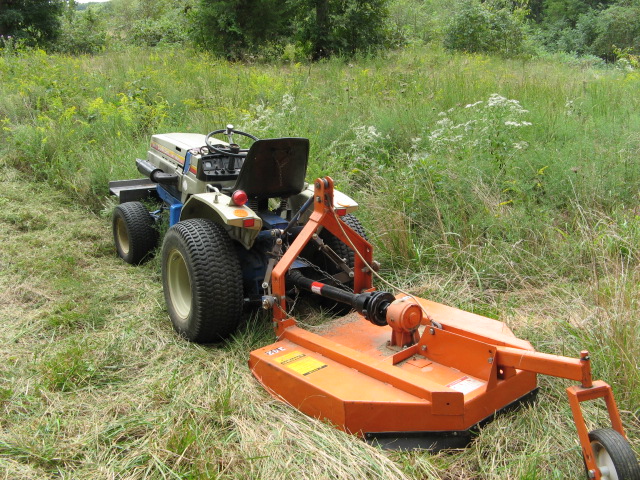

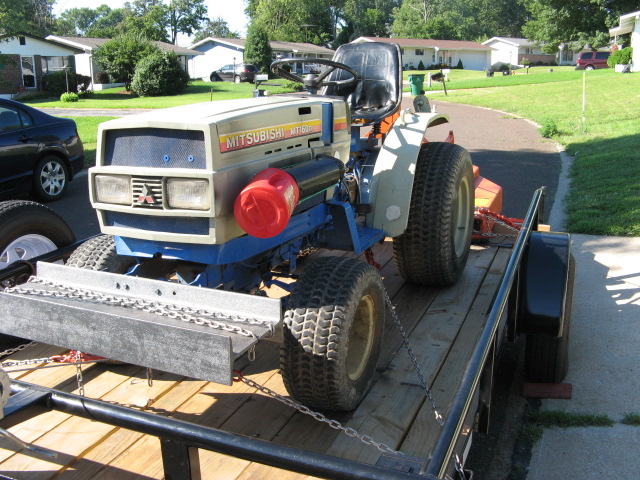

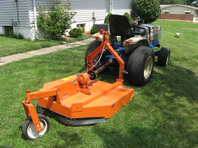

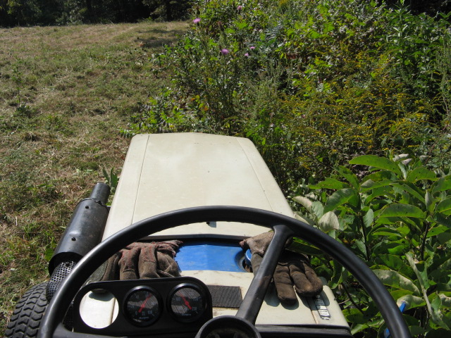

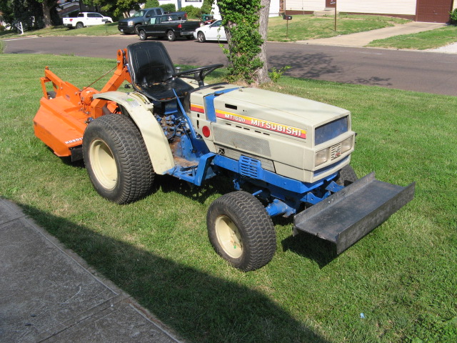

Took the Mitsubishi tractor "brush hogging" again on saturday:
2nd time 'in the field' for the tractor.

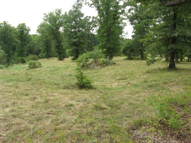

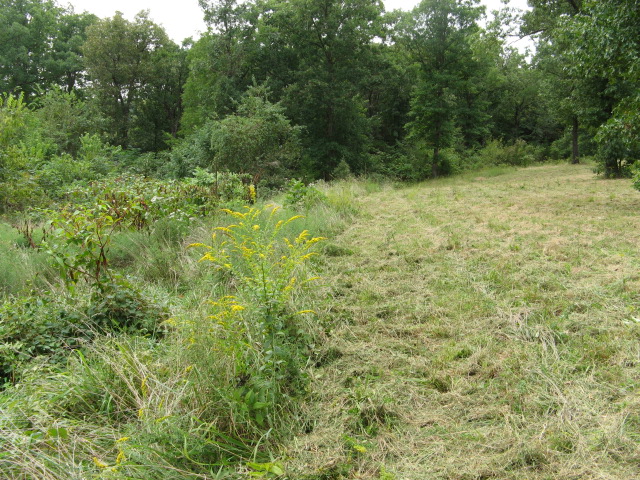

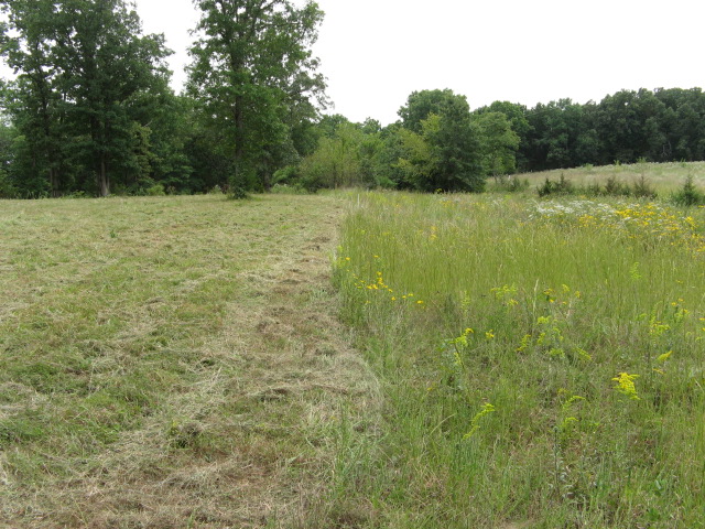

From the photos posted before, some may be under the impression that I am mowing mostly grass:

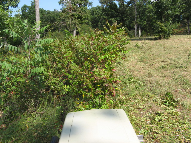

...but i am also mowing this:
...and this:

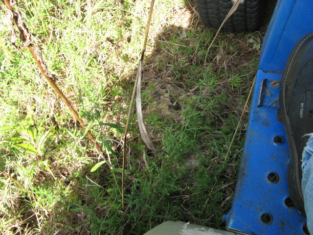

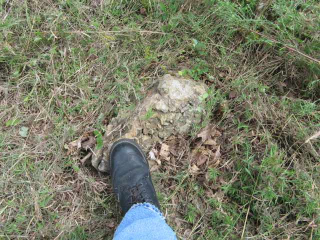

While taking photos the left front wheel rolled over something big. Hit the clutch and the brakes, looked down and saw this:
A large rock hidden in the brush. Here is a better view:

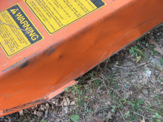

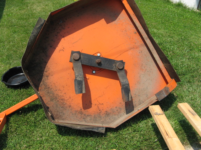

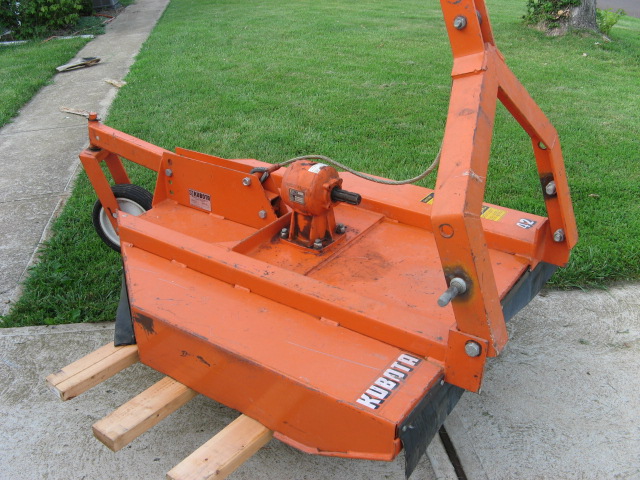

Lots of rocks to avoid. Haven't avoided all of them. My formerly smooth-sided cutter:
I keep raising the height but the rocks get bigger.

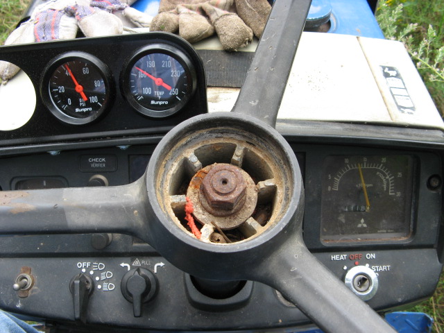

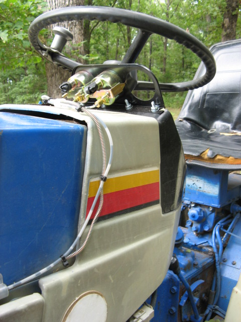

Adjusted the idle down to about 900 as it is suposed to be. Getting oil pressure of between 25 and 30 @ 900. Still getting 40 to 43 @ 1250 which is as slow as it
would idle last time. Temp never exceed 170 F.
Am done with the tractor work for this year. Still need to spend about a day with the walk-behind field & brush mower trimming-up areas, especially "The Hill."
Not going to take the tractor on the hill.

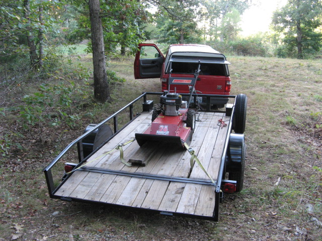

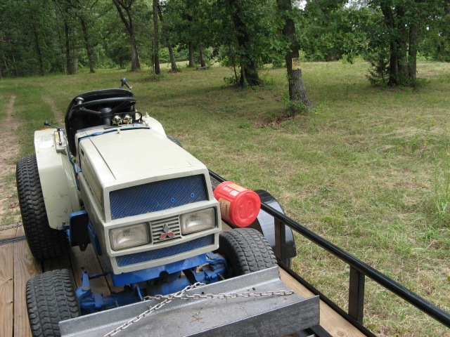

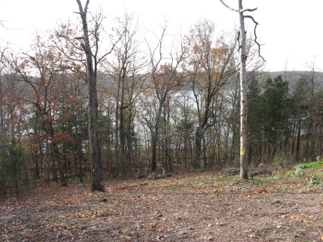

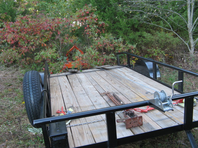

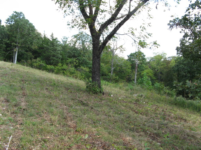

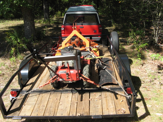

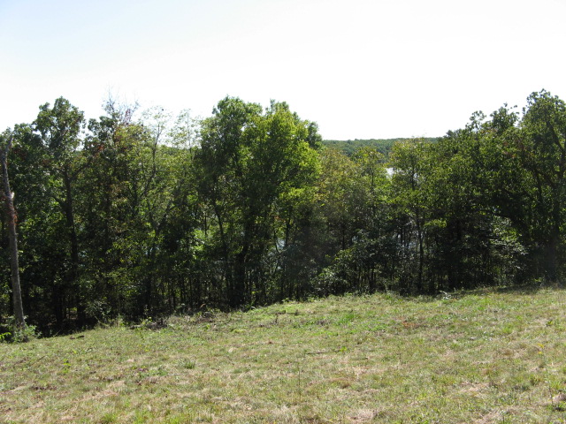

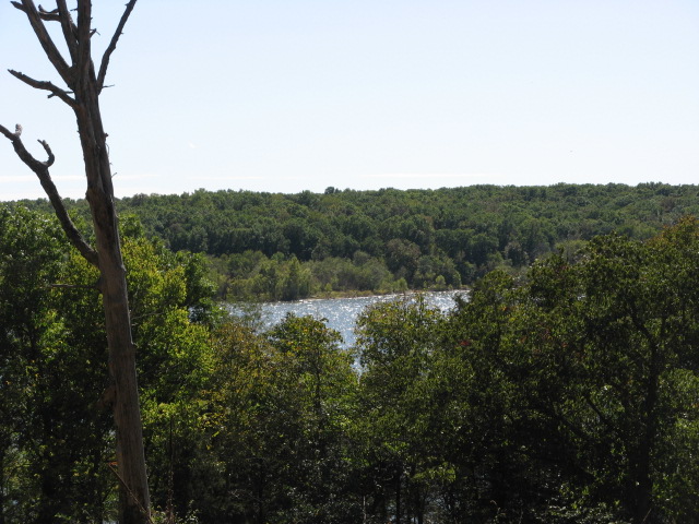

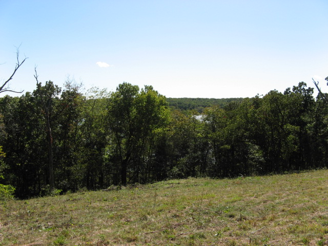

Went mowing again on Sunday. As per the plan, I did not take the tractor, but instead brought along the walk-behind brush mower in order to cut those areas unsafe or unwise to attempt with the tractor:

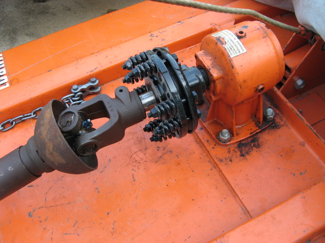

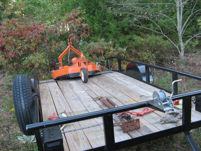

As previously noted in the thread, I had left the rotary cutter on site and had been hauling just the tractor in order to limit the load on the truck. Since I am done using the rotary cutter for this year I intended to bring it home. On the previous visit to the site I had left the cutter hidden in the brush, so I now had to winch it out of the brush and onto the trailer. If this had been a 6 or 7 footer, or even a 5 footer, that would have been a real job, but it was no big deal to load a 370 lb, 42" cutter:

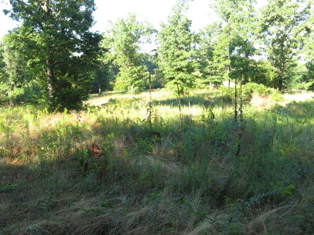

Finished up cutting "the hill." In additon to the walk-behind, also had to chainsaw a few small trees and ran the hand-held brush cutter a bit:

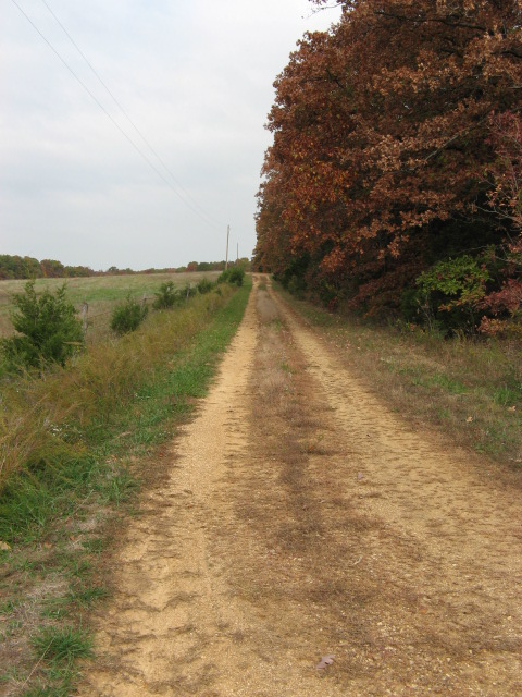

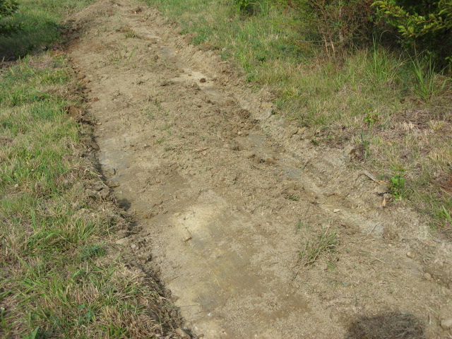

Then it was time to load-up for home. Also taking the angle blade home for the winter. The rock access road could use a little work, but for "political" reasons as long as it is passable I do not want to improve it at this time:
I won't need the tractor again until spring, so i might spend some time over the winter fixxing a few small issues with it.

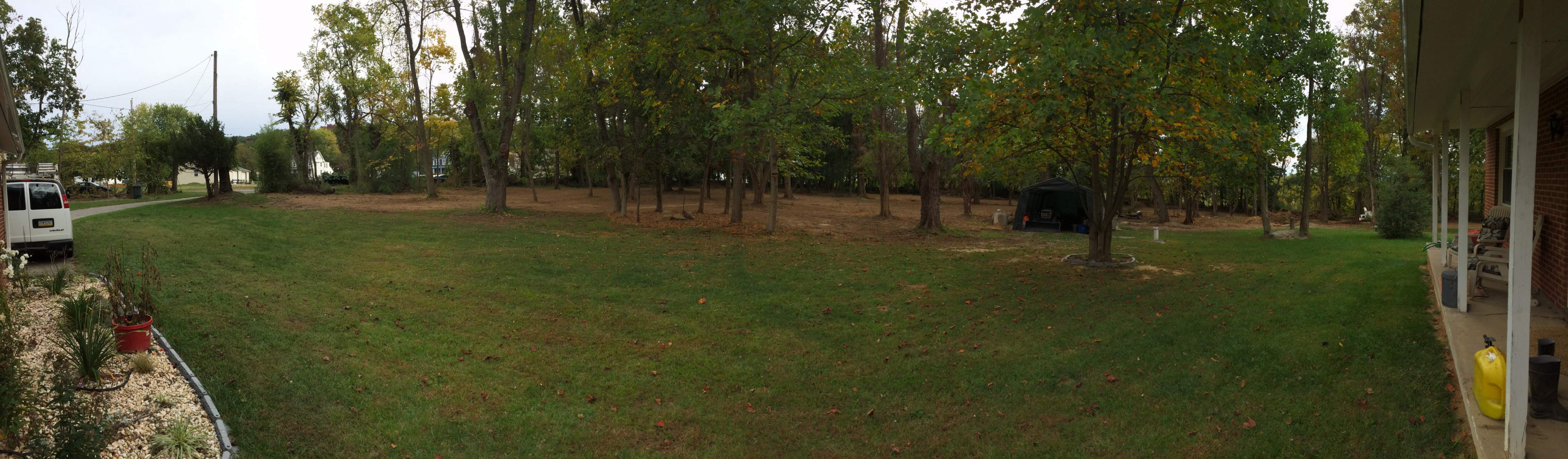

Actually there is only 1 small 1/2 acre property with a house that has grandfathered past the minimum 2 acre ordinance.The rest is road frontage, 4 acres to the right, 18 acre to the rear, church on 9 acres to the left.
We pushed everything to the property lines to make kinda a natural fence to give our 3 year old springer spaniel a boundary so to speak, it's working she stays on the property with no shock coller or wireless fence.
Thank you for the kind words, yes the property is nice but a lot of work.We would like to plant some fruit trees to encourage the deer to continue to visit the property regularly.
