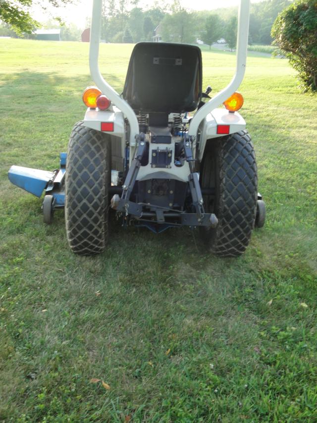

I thought I was on to a ROPS supplier recently until they told me I would have to hack off my under seat toolbox and other mods to fit their product. I then discovered this MT180HMD for sale below with quite an elegant ROPS design. Can anyone identify the manufacturer?
Thanks.

I forgot to clarify - the pictures above are of a North American tractor not Australian as some of you may have thought.
Thanks

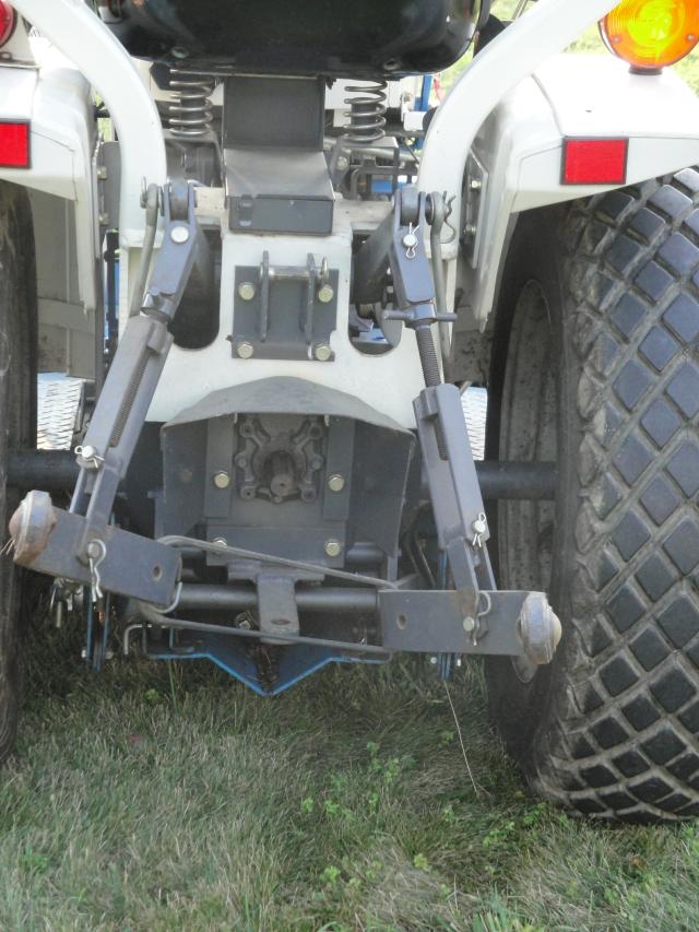

Could you post a picture of your tractor showing the top link area please? I'd like to make a comparison to the one I posted above.
Thanks

Is the ROPS mounting location what you wanted to see? It was a very easy installation. There are the six bolts around the PTO shaft, and then there are two more where the top link attachment was. The ROPS acts as the new top link attachment. They fold in half to allow you to get into a barn, or under trees, ect. MMine came with two seat belts (1 spare) and everything that I needed to install them. It took me about an hour, and the bottom mount detaches from the main part of the ROPS, so you don't have to balance the ROPS structure during installation. I am very happy with the ROPS, and they have a heavy powder coating on them, and they are very strong. It really gives makes me feel much safer operating the tractor(with the seat belt on). These are the photos that I think that you need? I hope that this helps a bit!

Thanks Mitch. Yes, this helps a great deal. I wasn't aware that it became the new top link. Of course there are some differences between our tractors but conceptually its the same. I'll contact Hercules today for comment.
Appreciate your input.

For any MT180 owners who are interested.......the ROPS in the original post was factory supplied (from contract fabricator) not Mitsubishi themselves.
Hercules have been tremendously helpful but do not have any product which will fit. So......I have drawn up the brackets as best I can using the above photos and am getting a local engineering shop to fabricate for me. It will not be certified though. As the engineering shop is using CNC to make the brackets he will be able to replicate.
I will gladly put any MT180 owner with no ROPS, in touch with them.
