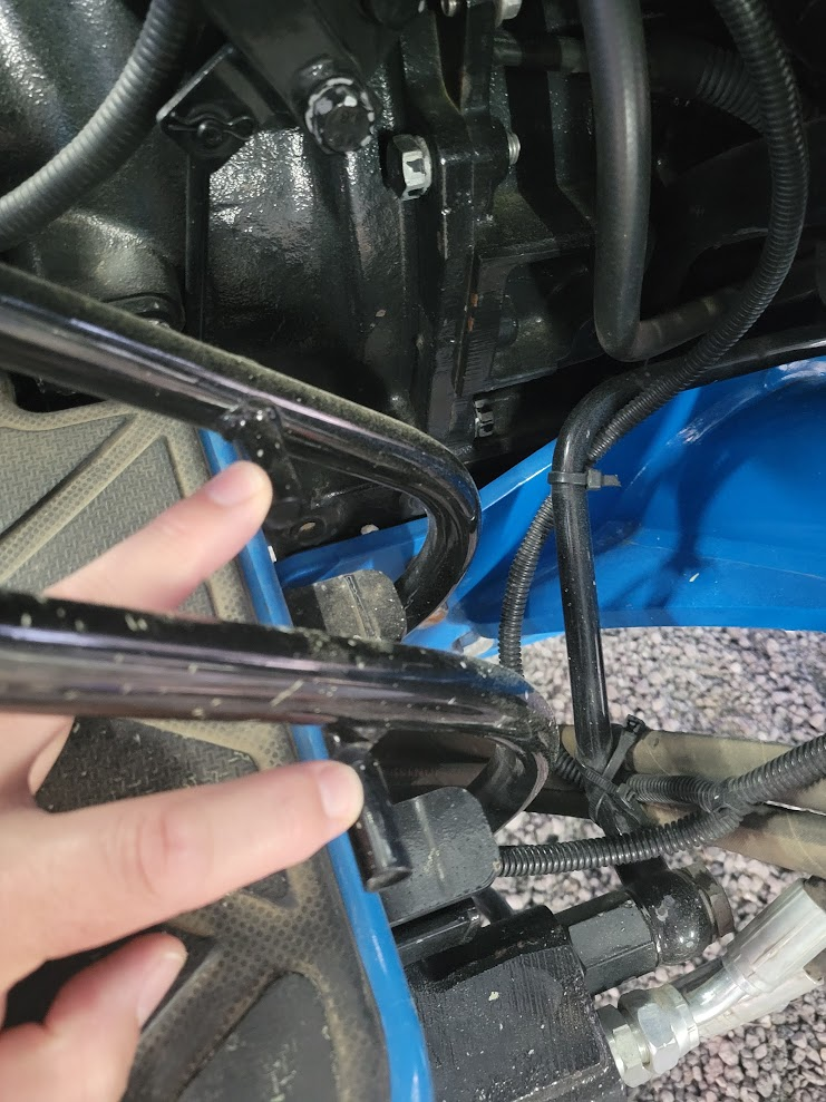

as @Eagle1 said, look at your pedals, mine have limit bars welded to them, and the reverse limit is physically welded not to travel as far.
Edit:
The 2 bars where my fingers are strike the stops below them. Those bars are at different heights, and control how far the pedals move, the reverse pedal moves less.

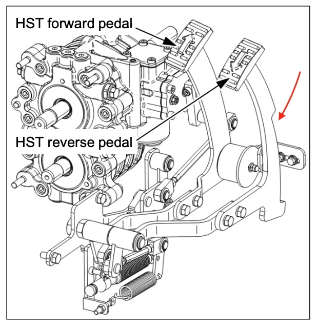

The MT3 S-HST model is slightly different than the pedals you showed. However there are stops cut into the reverse pedal arm. As you press on the forward pedal the reverse pedal rises and when pressing on the reverse the forward pedal rises. The reverse arm has a notch which determines how far you can go in either direction. There are adjustments that can be made to those stops via threaded control arms further in on the hinging mechanism.
