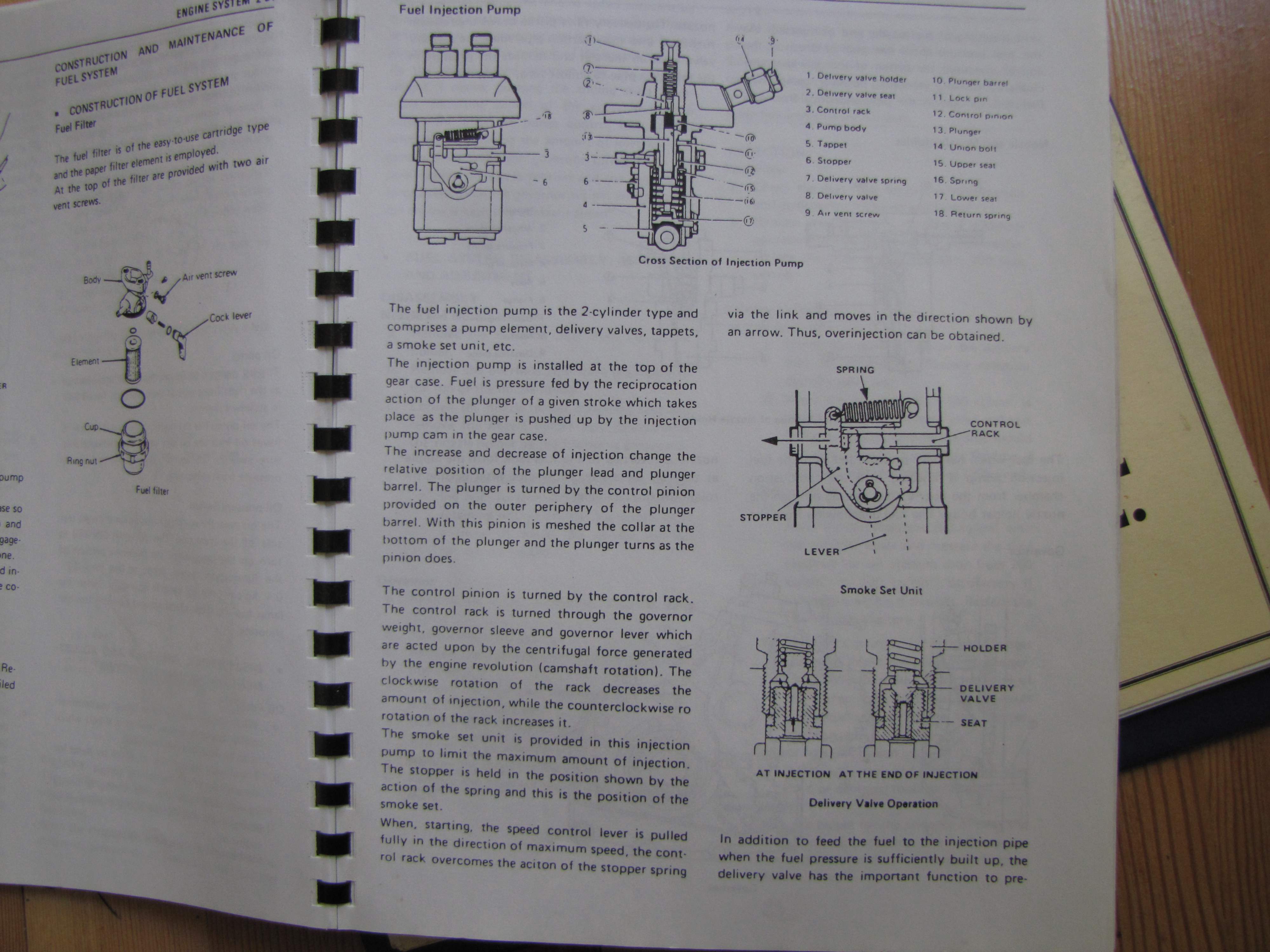

Here is a picture of the page about the fuel pump from my manual. I have no scanner so this will have to do. If you zoom in you can read the text. Hope this helps. IMG_2018.jpg
   / MT372 fuel pump question
Thanks for the replies. Thank you skylark for the manual shot, it should be a big help. Is that from the shop manual?
