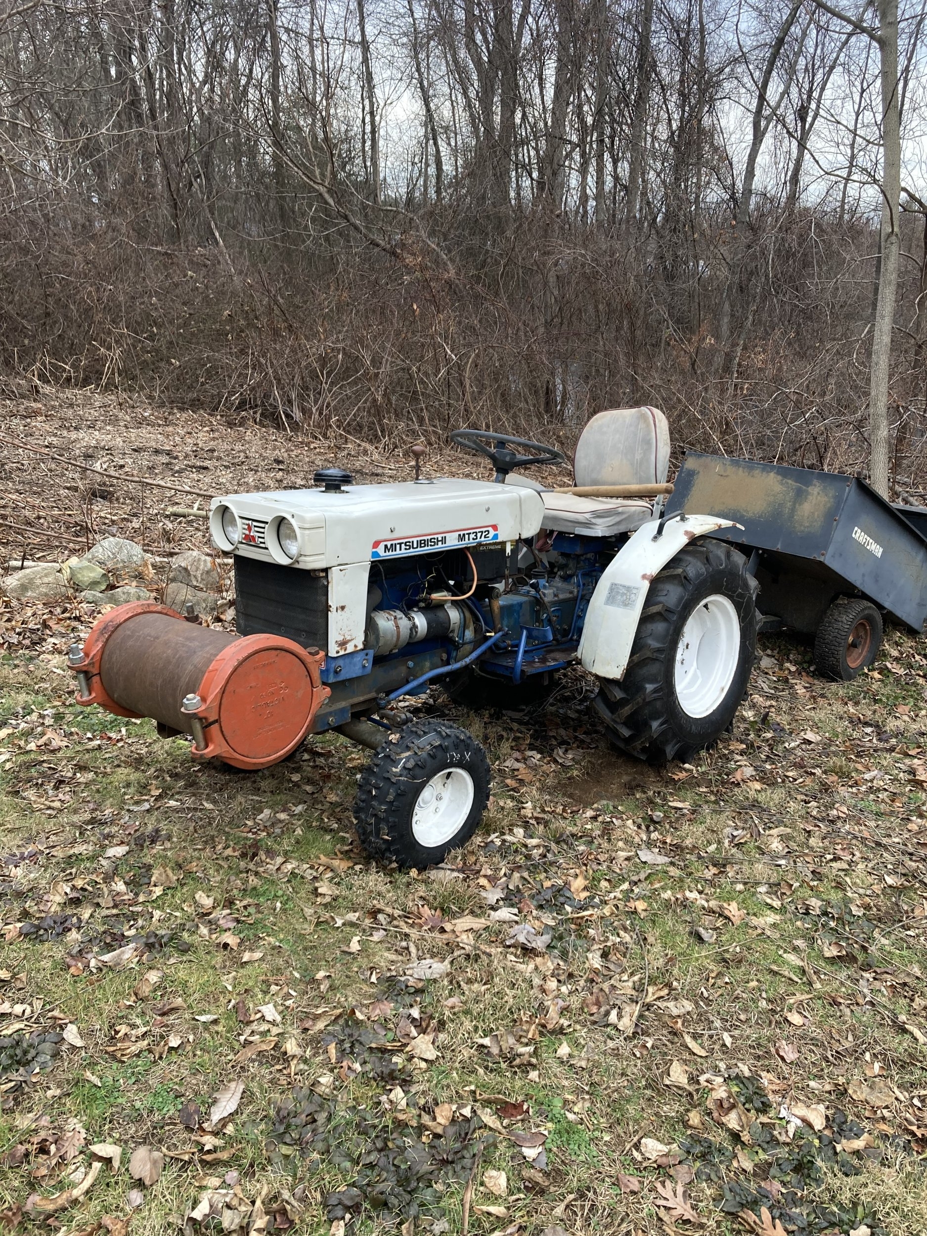

Anyone have any idea on what you would need for a hydraulic front plow or rear hydraulics or just a general hydraulic control I don’t know much about hydraulics and I’m not sure where how or what to get to upgrade the hydraulics for my Mitsubishi

Do you have a front end loader valve on your tractor?

No I got the tractor with just a 3pt mower front what I know I don’t have any auxiliary hydraulic hookups already installed I can take more pictures tomorow or at least looking at other threads I have a idea of what I’m looking for and need

I looked at some specs on line that show the MT372 as having a 3 point hitch and your one post supports that. There maybe some way of tapping into that as a power source but not sure what would be required to do that. Some tractors have or had the option of removing a cover and then bolting on valves for remote connections. Others had a block that could be reconfigured for supplying oil to remote valves and then feed the 3 point.
There is a Mitsubishi / Satoh section on this forum. Maybe post your question there where people with more knowledge of the Mitsubishi options and features would view it.
