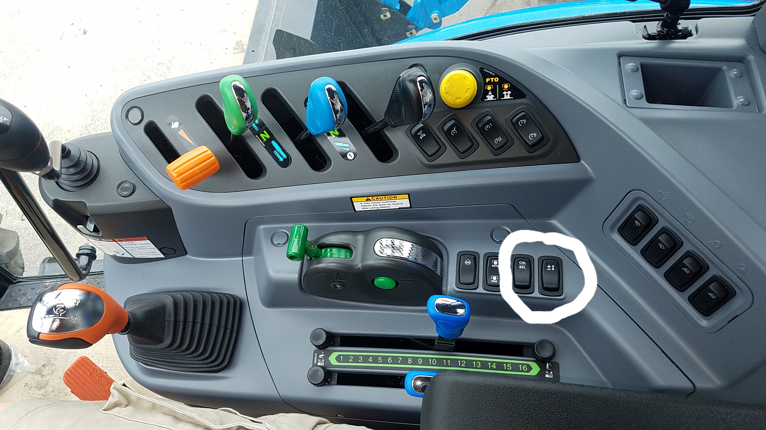

I test drove the MT5 recently, it's a very nice Tractor, and because of this I have added it to my short list of tractors that are in the running for my upcoming purchase. I thought I was familiar with all of the switches and there functions while I was operating tractor, but after looking thru some photos I took, I discovered a couple of switches that for whatever reason I managed to overlook while test driving, and I have no idea what there function is, and it's driving me nuts...
This is the dealerships first MT5, and admittedly they know less about the tractor than I do, so before I put them thru the torture of trying to figure it out, I thought I would ask the community here first if they had any thoughts? The dealer is about an hour away or I would just swing back in and sort it out for myself.
I am kind of hoping it is used to dial in the clutch engagement speed of the power shuttle, I know on the other LS power shuttle tractors there is a two position switch for this function, but the markings on these switches are different. I am wishing for it to function more like the Massey power shuttle, where there are multiple settings available, probably just wishful thinking...

Thats gotta be something for the 3point? The Cal/Sel button is Calibrate/Select and plus and minus?

actually, is this the creep function?? This one has me bothered too. I need answers. :)

the info on the website is very little, you'd figure they would have an operators manual on there, but nope.. but it does look like the transmission controls area.. I think for the creep function..

The 3pt speed control is located on the seat mount as with other LS Tractors. It does come equipped with a creeper gear, but again it's located on the floor as with other LS Tractors. It does have speed/cruise control if you will, but this is also like all of the other LS's...

I don’t see the two position switch for the power shuttle that my 6168 has, so I am thinking you may be correct in thinking it’s for setting the clutch engagement harshness.

I just can't think of what else the switches might be used for, I find it strange that all of the other LS tractors where the power shuttle is offered have a the two position clutch engagement switch, so why would they omit it from the MT573, it just doesn't seem logical to me.....

Hi, the left switch (Cal) is for re-calibrating the shuttle shift pressures .
the other is to adjust the shuttle take up and also the clutch.
Hope that helps. Its a great tractor and works very well, I bought one and now have 53hrs on it, I find it very good on fuel , with ample power. I traded a 2017 MF 4608m for it.

fretwear, thank you for taking the time to explain the mystery switches, this is exactly what I was hoping they were for, I really appreciate the info.... If I might pick your brain a little more, are there preset levels of engagement, if so how many, and is the this displayed anywhere on the instrument cluster, or is it strictly just seat of the pants feel?

Yes there are 3 preset levels for both the clutch and the shuttle, it shows on the dash, very easy to do.

The owners manual tells you how to set the presets and if you ever needed to, also the re cal.
