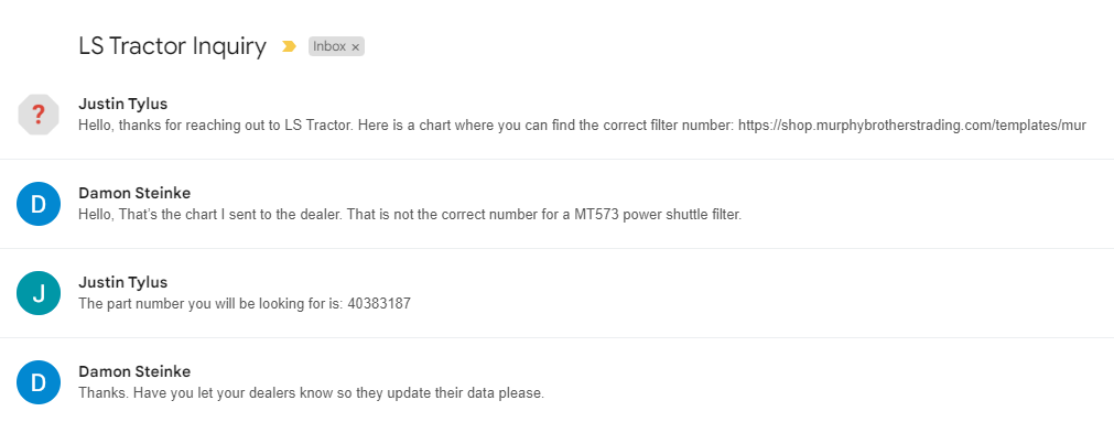

Hi Guys!
I got a response from LS Tractor, they initially told me the filter number was 40214028 again but i told them that was incorrect. They came back with this response.
We are looking for filter 40383187.
Thanks,
Damon.

Thanks Bro!
I'll have to check that out if i need something in the future, was banging my head against the wall with 2 LS dealers in Canada for well over a month before i just reached out to LS myself.
You're a hero.
Damon.
