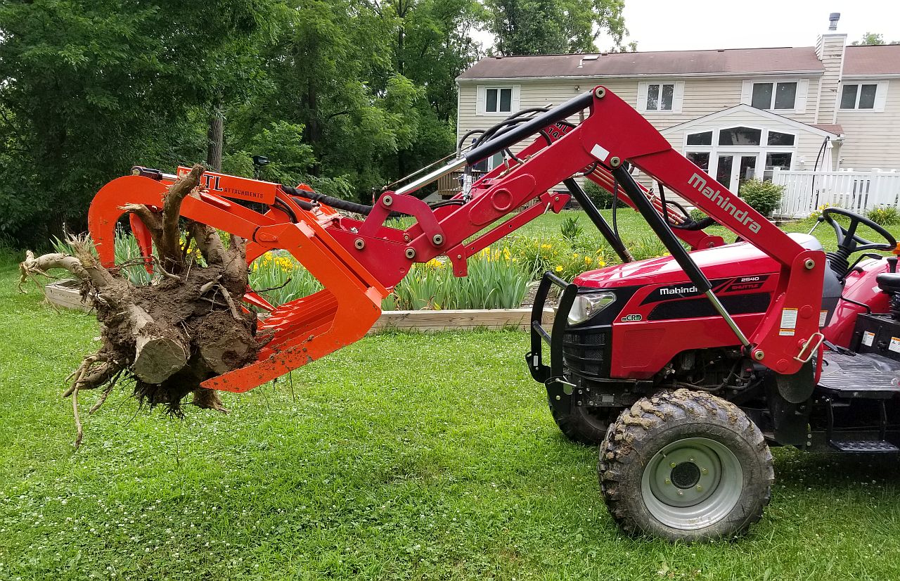

Budget and time concerns both prevented me from getting a lighter-weight (and stronger) EA unit, so for under a grand, delivered, I got an MTL 72" dual-lid grapple, in Kubota orange (to set off the Mahindra red) as advertised on eBay. I've played with it for several hours, and have no complaints; it works just fine, it's reasonably well built, not super-heavy (shipping weight was about 550 lbs.), has grease fittings and cylinder covers, and it's made in the USA. The seller (who is the manufacturer) called me and asked what kind of connectors I wanted, so it came ready to rock and roll.
I'm not going to do any actual root raking (except perhaps in the loose dirt where I've back-hoed several stumps) so there should be no real issue with strength. Mainly I'll move logs, brush piles, and construction debris from the money pit in the background of the picture. It would be nice if it was 100 lbs. lighter, but that would cost me more than a grand, and it can lift the largest log I have laying around and great gobs of brush with no issues.
So if money is tight, no need to fear the cheaper.

I like it....and more importantly, you like it :)

That's about 2.5 times the weight of my EA. On a bigger tractor, the extra 300lbs wouldn't be a big deal, but on my just-big-enough tractor - it matters. That's 25% of capacity, gone before I start.

Yeah, but compare grapple to grapple, and the EA is lighter, but not by that much. This is the "flat bottom" grapple, not the clamshell.

You missed my point, CF, which was that the MTL is too heavy for smaller CUTs like mine.

I have the MTL Extreme 84 and some Titan products. I can tell you right now the Titan welds look like they were done by a palsied simian but hold together. The MTL on the other hand has pretty welds. Again mine is an Extreme 84 and might not be a direct comparison. If you want more info let me know. I am a slow and bad typer -Typist?
