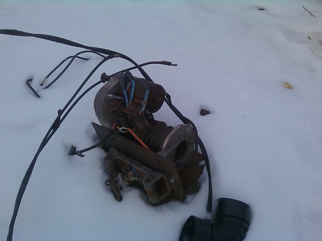

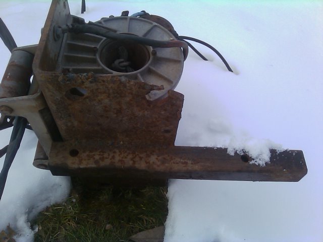

I use a old warn 38631? 8,000lbs of pull it is a little big and heavy but pulls like there is no tommorow. I have had to use a doubler block but have found nothing that I could not pull or pull apart. I bolted to a pieace of 3/8 plate and welded the plate to a reciever that fits in all 2" truck mounts and weld chain hooks on it for use with out a truck. I have tied to tractors trees dump trucks wagons and it works great. I have a 8,000 ramesy on my goosneck which is a good winch but not near as fast or strong as the warn. I'll try to take a photo tonight of it.

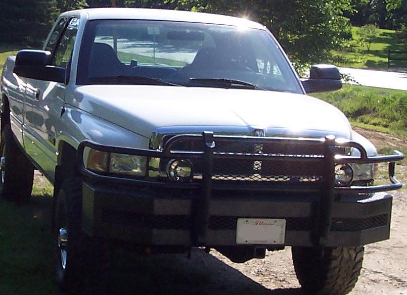

Here are the pictures not the best as I took them with my phone. All my trucks have 2" recievers up front to use this and it has been abused over the yrs but still works. Yes I should keep it inside but with what it weighs I usually just slide it out of the truck and drop it. I use a 100' extension cord I wired up to control it so I can be way for it if a chain breaks or be riding in the vechile I am trying to recover. The truck has the bumper I put on most of the trucks so you see how I attach it.
