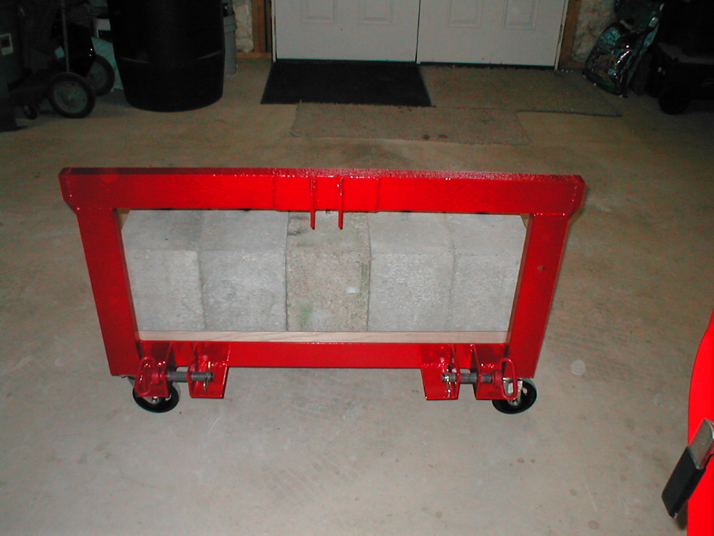

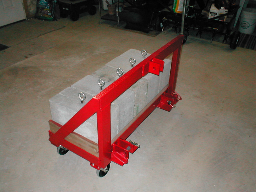

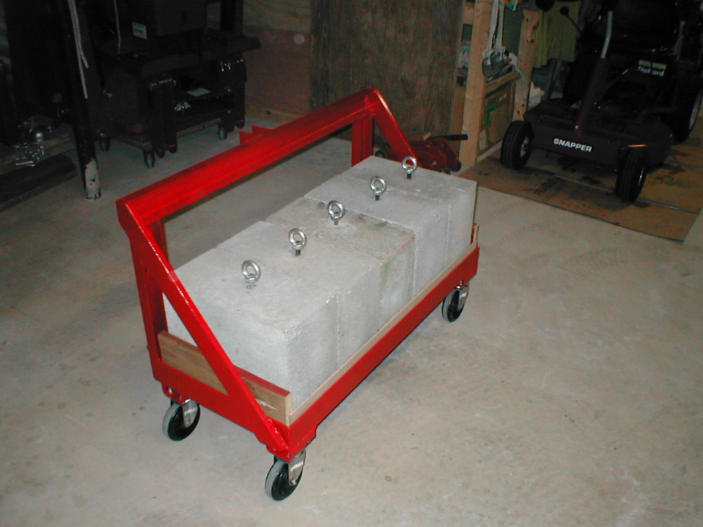

Rather than use the backhoe on my GC2410 for ballast, I built a ballast box for use with the FEL and quick hitch snow blower. What's unique about this is I can move each of the 100lb cement blocks to my aerator and back as needed. I drilled a hole and drove a length of rebar through each block and welded a flat washer to the bottom and a lifting eye to the top. I can now use a chain attached to the FEL to easily move the blocks back an forth instead of wrestling them by hand. The ballast box give me a smaller footprint allowing me to get into tighter spots if needed. I'm thinking the total ballast box weight is about 600 lb.

Nice build! I really like the casters for moving it when off the tractor. The ability to use the weights on multiple attachments shows some good planning took place too...

Thanks guys. The casters are 5" that I picked up at harbor freight and work fine unless you need to change direction. There's no ball bearings in the swivel, so I have to jack it up and rotate the casters by hand. Kind of a PITA, so I'll be replacing them, but for now, it works.
I used Tractor Supply M-F red with the enamel hardener to paint this thing and so far seems to be pretty durable. I bought a cheep spray gun from harbor freight ($20) and was able to get a nice gloss. At the same time, I also sprayed a '84 snapper mower. It sure looks a lot better now. Next summer I think I'll paint the chipper and roller.
