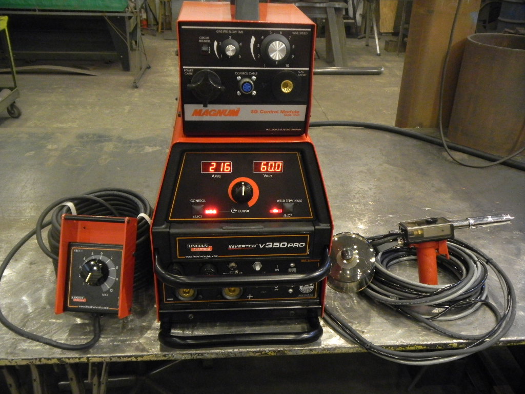

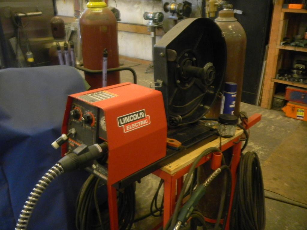

I have a multi process machine, but without plasma, Lincoln V350-Pro. I've read where you want to be careful buying a unit that has a plasma, along with high frequency for Tig welding.
