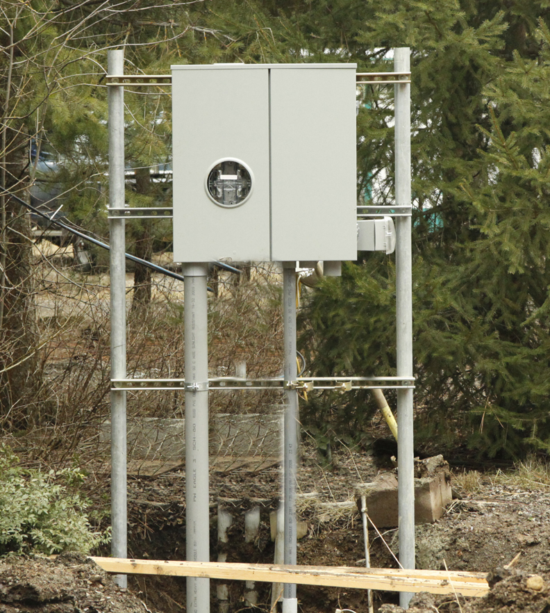

   / Multiple electric meters and "availability charge" #10
Yeah, actually, in addition to killing those two birds with the same stone, I also ran in my new solar power system I was building out next to the new service....so it was a "3 'fer".
The small meter base on the right is the "buy" meter that they pay me for production.
