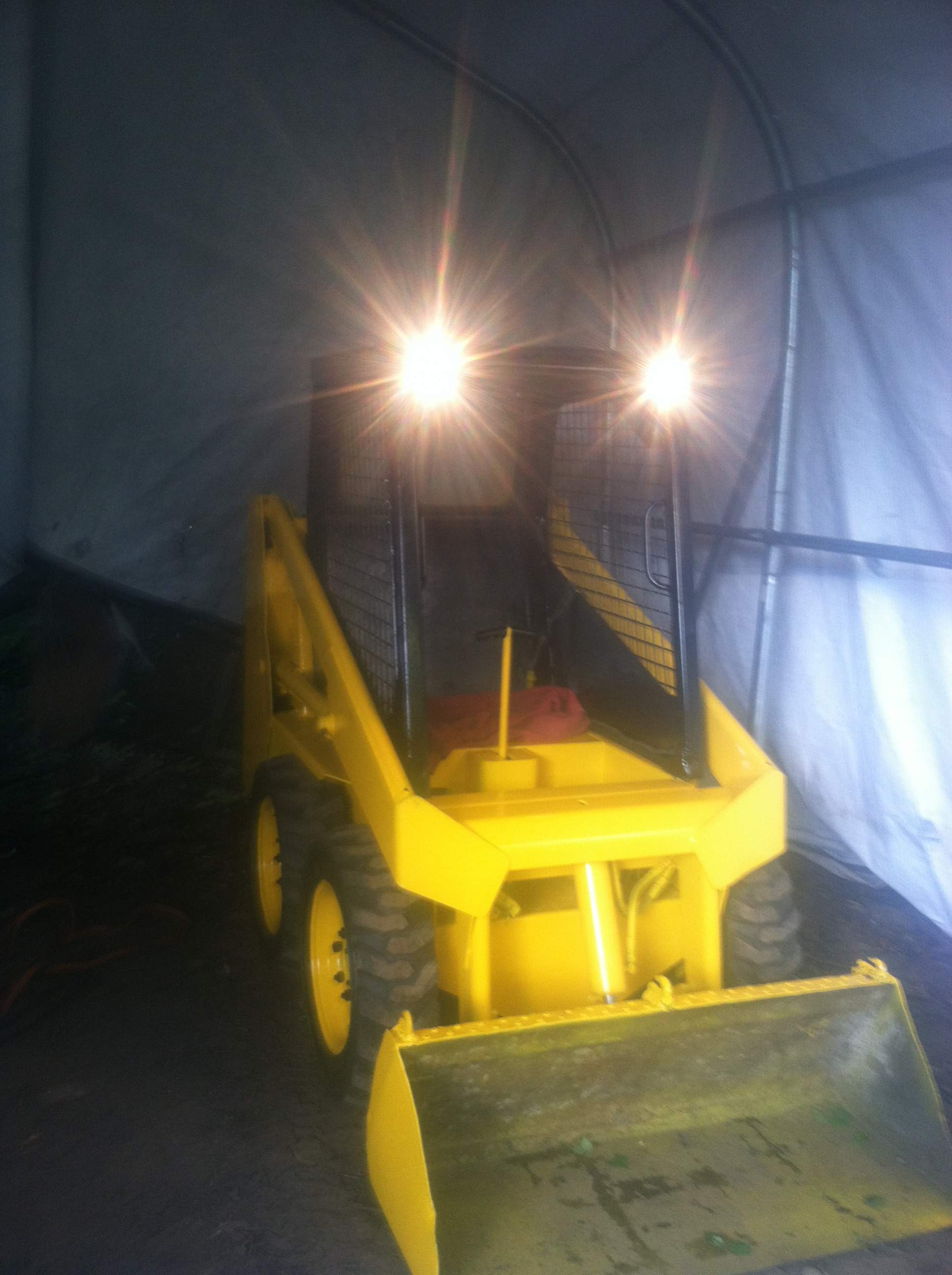

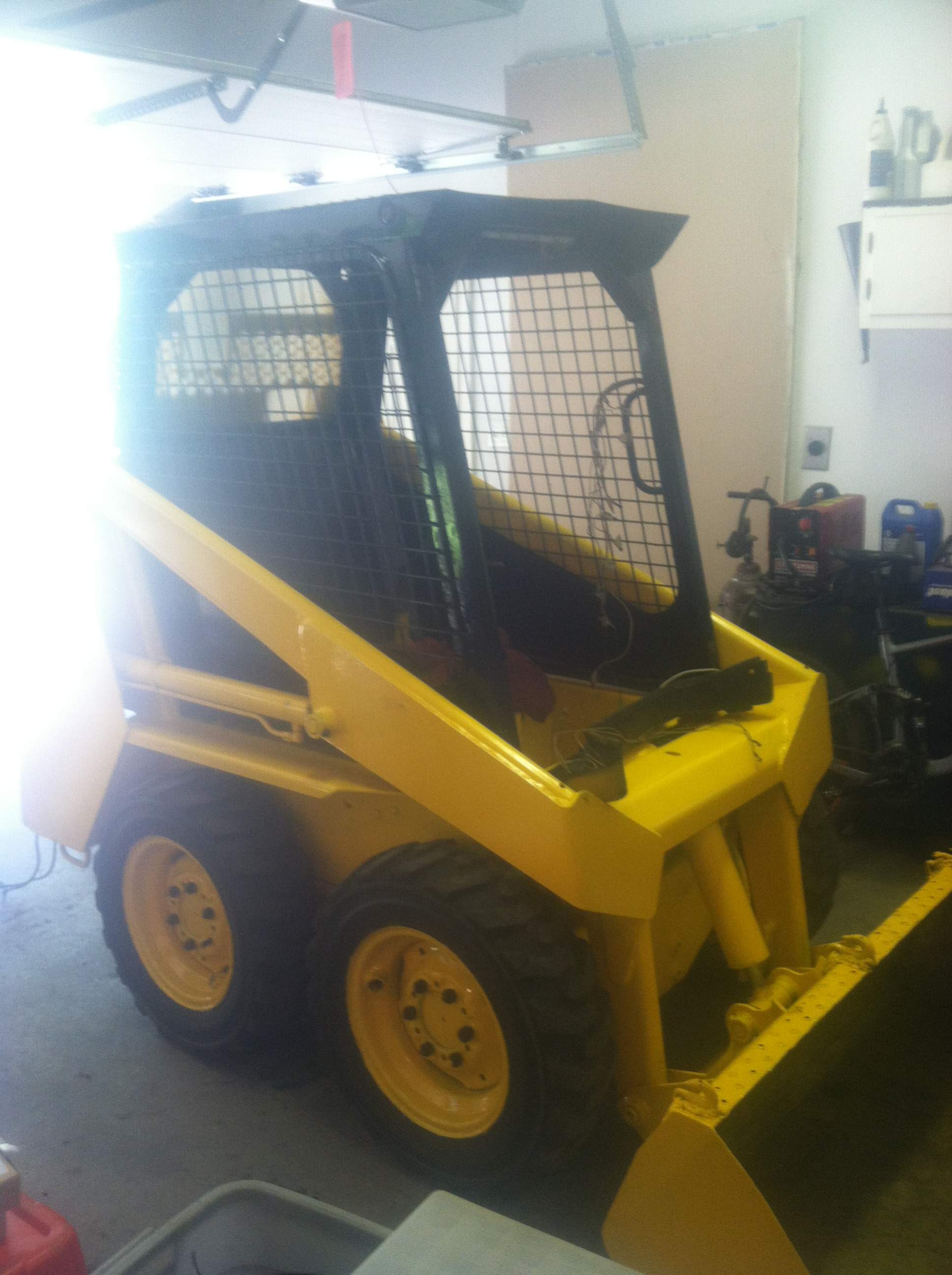

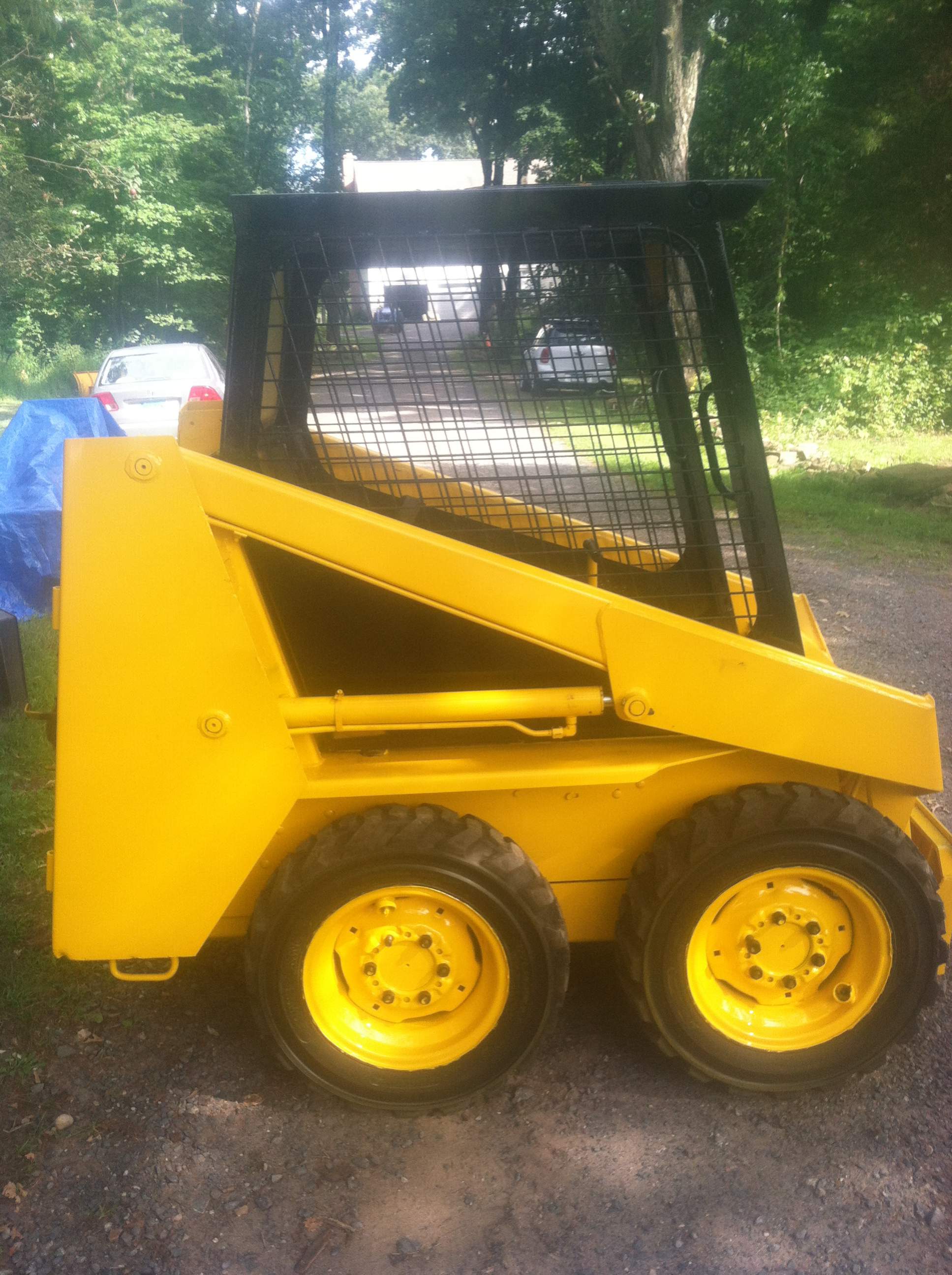

Heres a few pictures of the finished product,
new paint, removed cab and engine door, powerwashed, wire-wheeld, sanded, primped and painted
rebuild hyd cylinders
replaced hyd lines
new filters and fluid
rewired back to factory schematic
new tires
machines ready to work. runs and work great. logo and seat ordered. took more pictures throughout if anyone's interested. If i have time ill make a restor thread on it.
