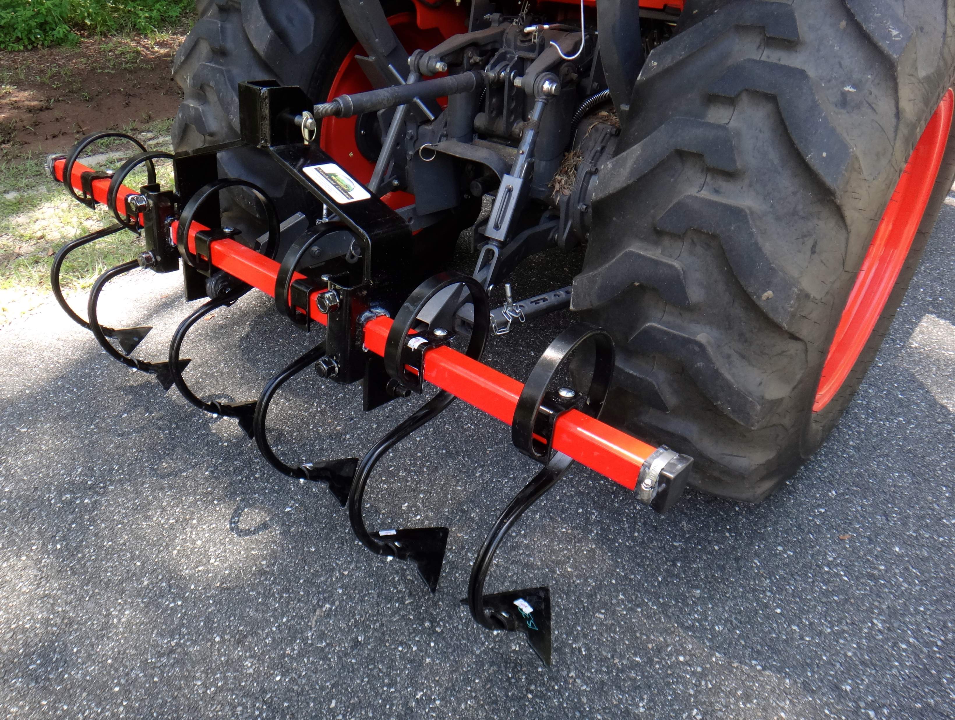

I resuscitated a 8 1/2 foot offset pull type disc harrow that came with the property. 28 discs on 7 1/2" spacing. Matched well to the Case Farmall 75A, it does a great job of breaking up the dirt to 6-8 inches (gravelly loam) and being pull type is easy to manage on the undulating terrain and turns. I need a 2nd implement to break the clods, and level the furrows. I have a chain harrow, it's doesn't come close to doing the job. I've looked and researched this to death, started with arena drags but ended up with 2 more cost effective candidates, a 96" Jake Rake or a 96" Buckeye Tractor 3 row toolbar w/s tines. gauge wheels and a leveling bar. Is Jake's Rake still in business? There are no new posts on either the website or Facebook page since 2017 and there has been no response to my inquiries for 2 weeks. The biggest attraction is it is short and close to the tractor, making it far easier to manage. It seems putting a hydraulic cylinder on the rake arm would be a no brainer. It also seems expensive for what it is. Buckeye Tractor is easy to get a hold and is very helpful. While twice as long, the gauge wheels should help a lot. They suggested 3 rows of s tines with 4" shovels, but I'm still leaning towards the 1st row being 1 1/2" chisel points instead of s tines. I want to be able to use just it and disc less frequently. I guess if I never get any response from Jake it become academic.
Oh, and I already have a box blade and a landscape rake and they are both ill suited to this task. Any thoughts?

Buckeye suggested 3 rows of s tines with 4" shovels, but I'm leaning towards the 1st row being 1 1/2" chisel points instead of s tines.
I have an S-tine toolbar cultivator with shovels. Your inclination toward chisel points in front is good.
S-tines are not very strong intentionally, so they will oscillate in the soil. S-tines may be too weak for your application.
