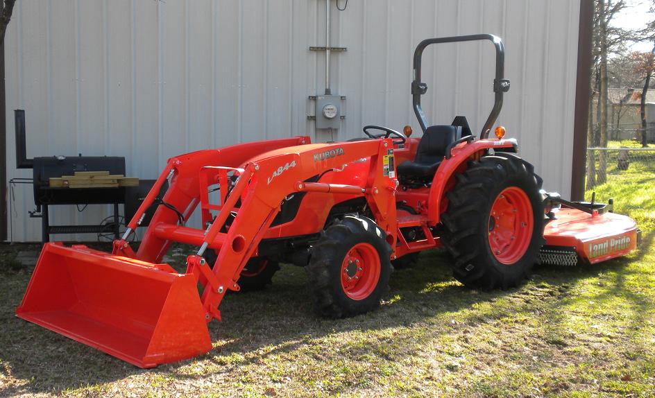

Thanks for the excellent advice! We were on the fence and had decided on the 4700, but then the final cost changed so we opted for the 5100. Just the process of removing the rotary cutter (which was on when it was delivered) and connecting to the box blade we definitely appreciated the advantages that the telescopic arms have. As you said, well worth the cost difference alone.
Here is the brand new MX5100
That GREAT, glad you got one and like it !!!!! I can't get over how much I like the Adj. arms. I never had them before but would hate to go without them now.
CONGRATS and have fun with the new Kubota!
