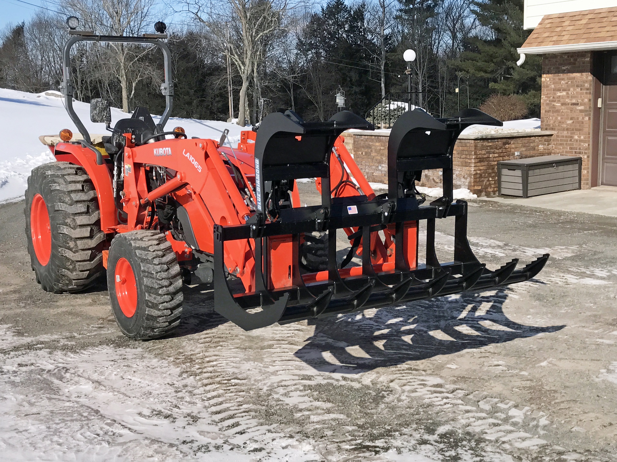

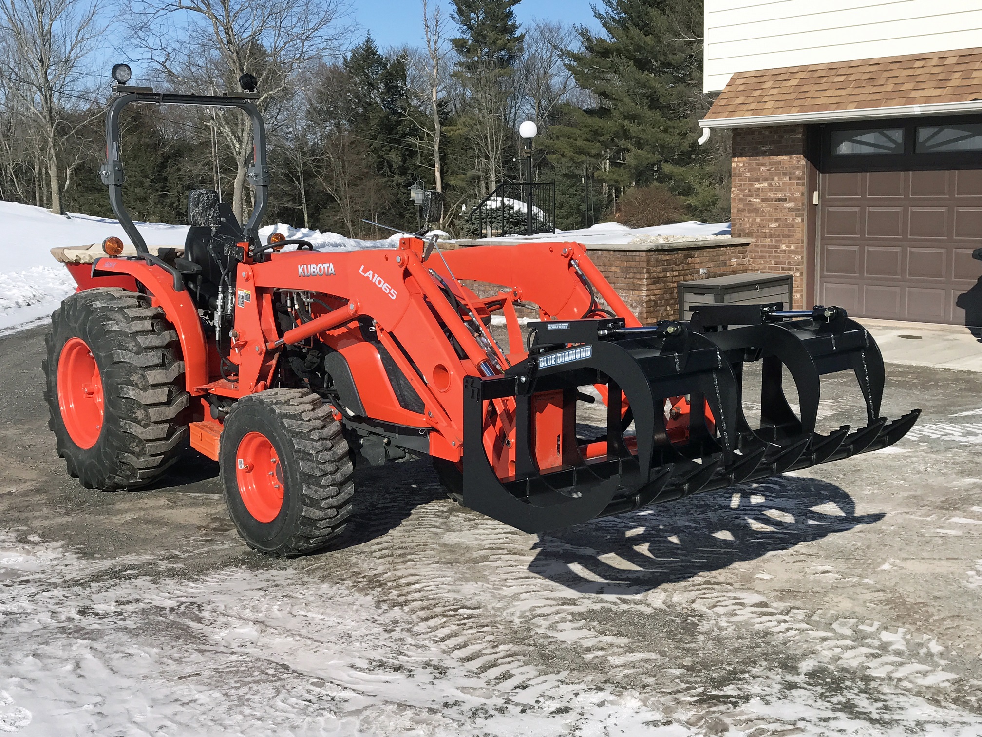

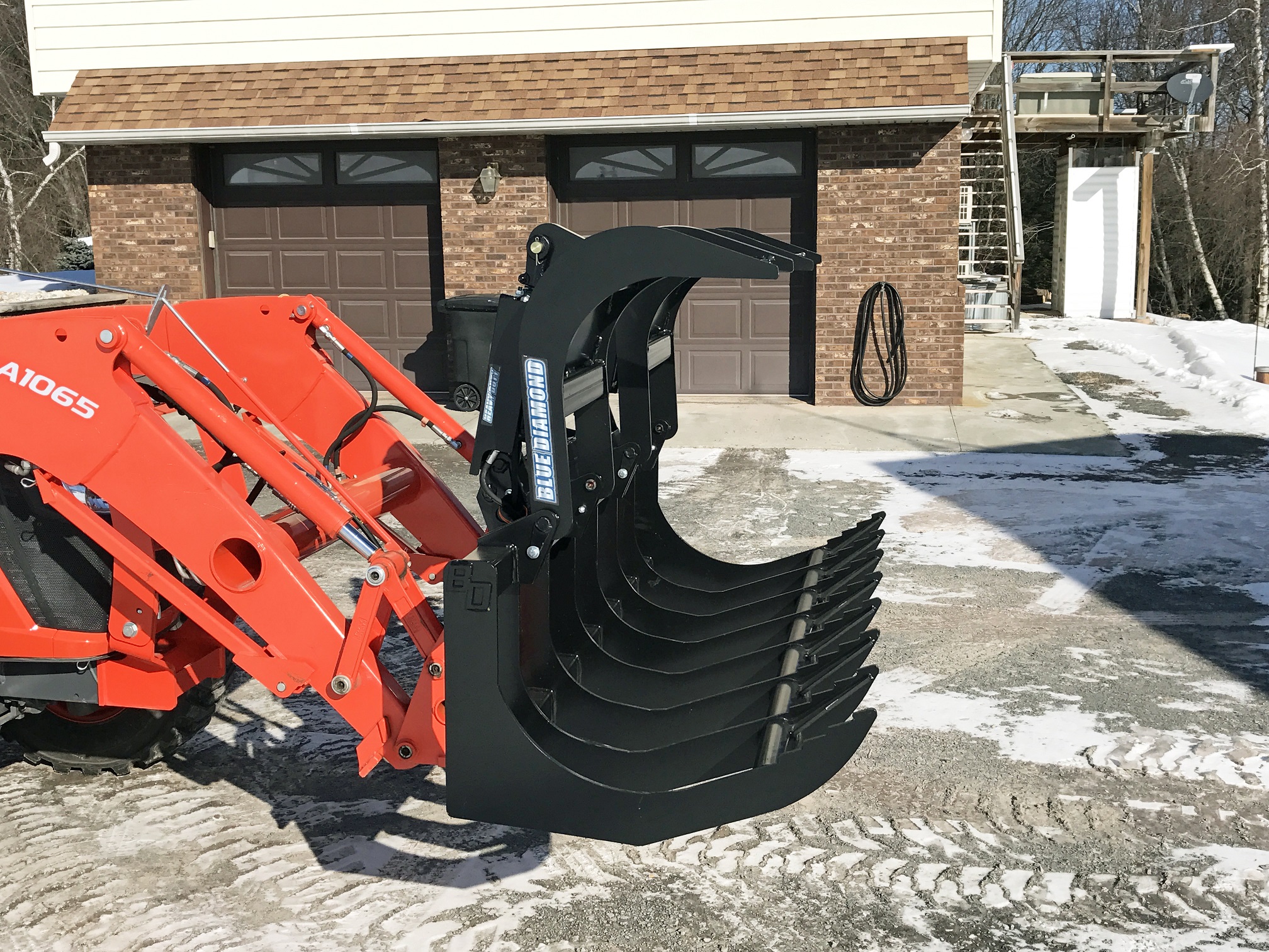

This is definitely a frequently discussed topic here at TBN and you will find many differing opinions if you do a search.
In my case, I chose a Blue Diamond 72" grapple which closely matches the track width of my MX5800.
Blue Diamond 72" Heavy Duty Root Grapple Skid Steer Attachment | eBay
As you know, wider units weigh more and you sacrifice some lifting ability. Don't buy more grapple than you need.
Don't forget the 3rd function valve or rear remote necessary to power the implement.
