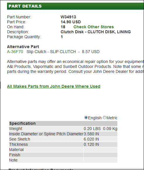

The clutch lining spec's are shown below if tightening the nuts won't stop the clutch slippage.

texas: is this parts to change the sc plates?
