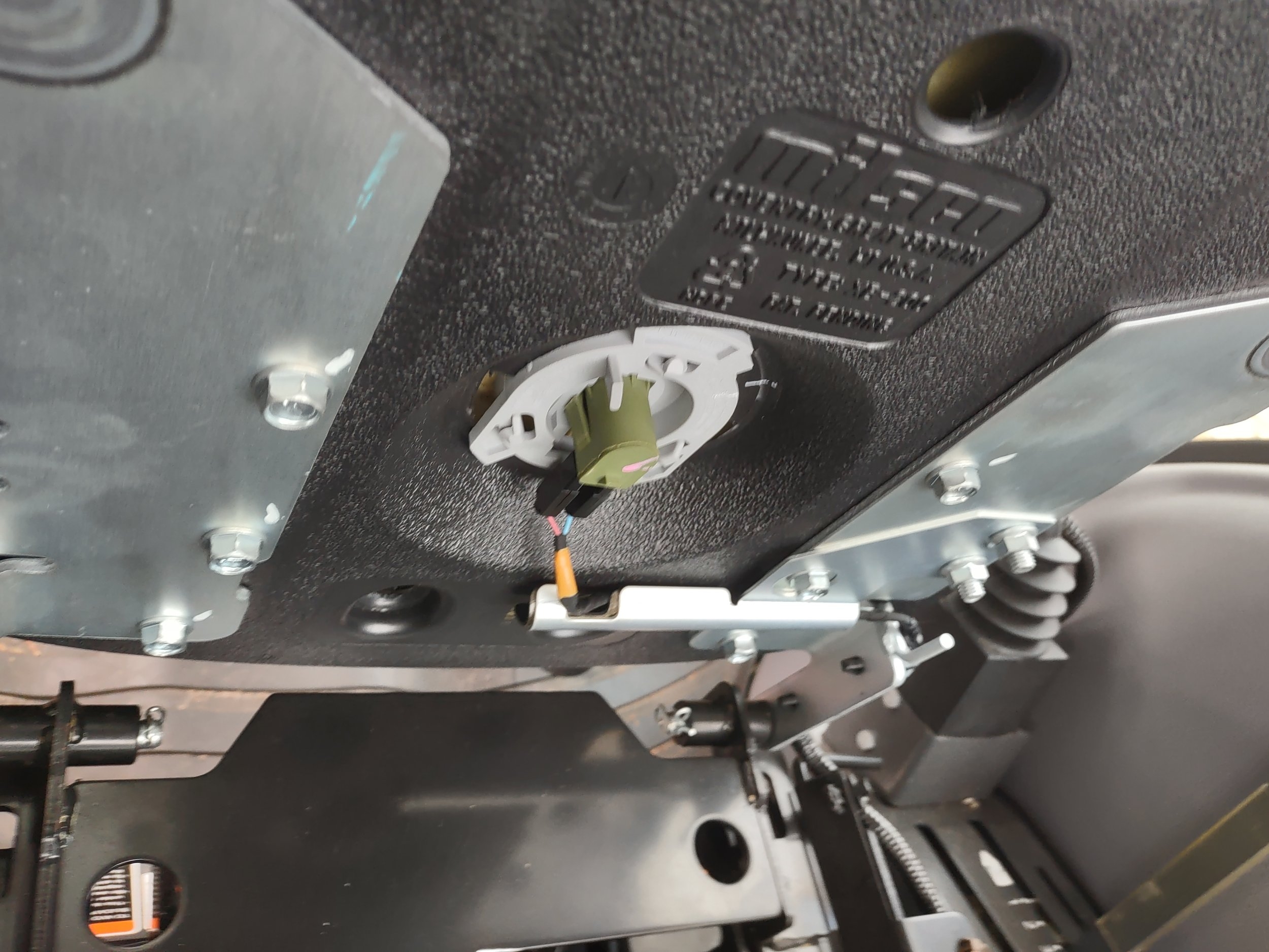

Thinking the switch is bad or out of adjustment,you have to bounce on the seat about 20% of the time.
Always cranks after that .
Just out fo warranty started it with about 200 hours on it .

I think I would spray switch with contactor spray cleaner
   / MX6000 seat switch #3
Flip the seat up and look at the pivot rod. If one end comes out of the mount that can create a problem. Check for any junk caught under the seat. That can prevent proper operation, too.
   / MX6000 seat switch #4
Sounds like you need to tune it, pretty easy task.
It is inside the seat,not s lever like you normally see
Looks like the one in my lawn mower I noticed today
