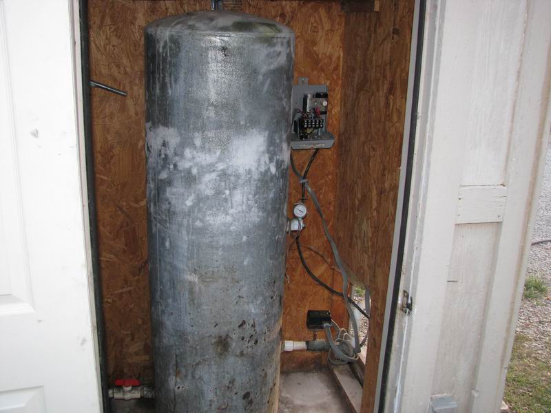

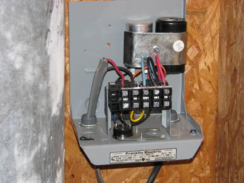

Well, my well is not well.:thumbdown: This morning it worked for awhile and about 10:30 am it quit pumping. I checked and the thermal overload is popping on the motor controller. When I throw the pressure control to off, the thermal overload holds just fine, but as soon as I put it to the operate position the thermal overload button will pop in about 5 seconds. My guess is that the pump has bound up.:smiley_aafz:
I had this well drilled in July of 1999. It has worked continuously and flawlessly for almost 11 years. The pump is sitting at about 340' and the well is drilled down to 386'. Our water is perfect, no iron and soft, good tasting water. The pump is a Gould pump. I don't think there's any better one than that.
I called my driller and he has 7 calls ahead of me today, so it may be tomorrow or Monday before they can come out.:( In the meantime, we are getting water from a neighbor and may go to my in-laws for a shower or two if repair is delayed. I haven't taken any photos yet, but will do that as the repair goes forward.

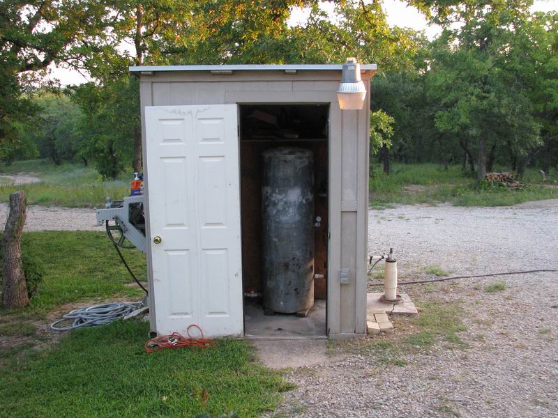

I didn't hear from my well company yesterday, so I will probably call them in a few minutes (after 8 am) to see if they work on Saturday or if I'll be waterless until Monday at least. I opened up the pump controller box, but I don't want to do anything else before they get here. I could use my tractor and loader with a pinch strap to pull the pump, but I don't want to do that. I can afford to have someone else do this and I'll be happy to sit on the sidelines and watch, then write a check.

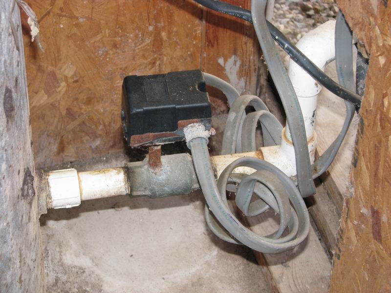

I also know that I need a couple of things like the tank's pressure gage replaced. The pump pressure gage is stuck at 30 psi and has been that way for several years. Also the small pipe going into the bottom of the pressure switch is very rusty and might need to be replaced. The wiring is not up to professional electrician standards either, but that seems typical for well drillers in this area. I provided a breaker box and they wired the rest of this. Notice the controller has no safety ground attached to the box. This is the first time I've opened the box and discovered that.
This was a good excuse for me to clean out my wellhouse (with my wife's help) and my little concrete pad around the wellhead has seen better days. Oh yes, my garage door opener died while we were on vacation. It is flashing a code that says the logic board is dead. It won't reset itself when unplugged as instructed on the troubleshooting sheet. The price of the board is 1/2 the price of a new opener, so I have a new opener sitting in the garage.
Both the opener and the pump have failed after a hard thunderstorm that came through a few days before we got home from vacation. I'm wondering if lightning or a power surge might be responsible for both these failures. I can't find any evidence of anything burned, but it does seem fishy that both went within a week of each other. However, we water our large yard and our garden off this well. It's done double duty for many years and I just can't complain if I have to replace the pump because it wore out. I do think Goulds pumps are the best and I'll be replacing mine with as good a pump as I can get.
