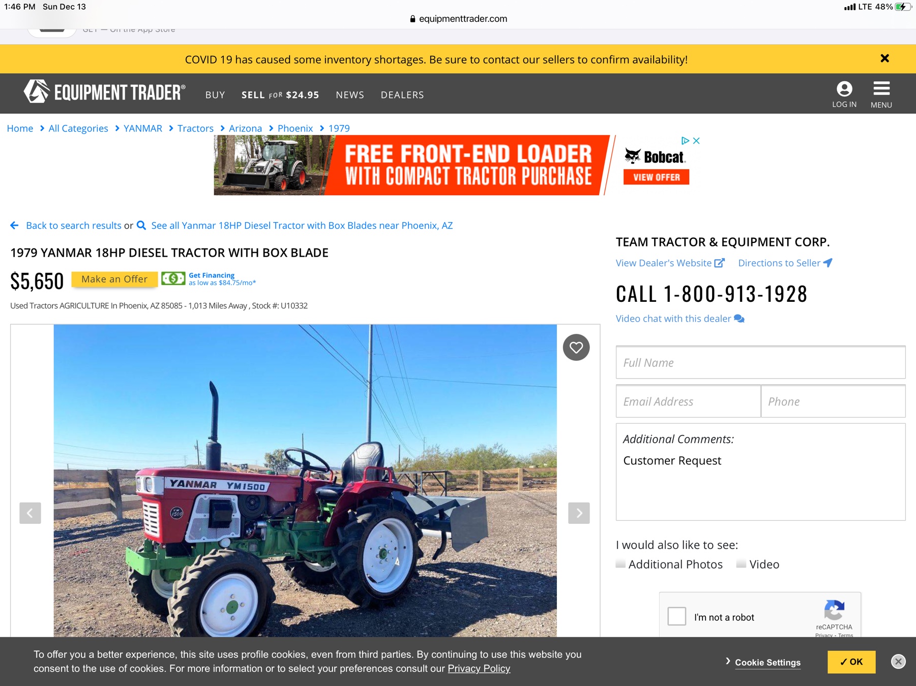

I have seen different sites on the web selling the MY1500 and some advertise different engine hp. I was under the assumption that they were all 15 hp but like the one here it claims 18 hp. Are some of the tractors outfitted with larger hp than 15? If so how do i find out which mine is ? IMG_0562.JPG

The engine Hp has it's rating, some place 2Hp to 4Hp above 15Hp (depends on fuel injector type on the machine). The PTO should be 15Hp output.
This is the best definition I can give you from all the manuals and the fuel/hydraulic pump guy's feed back I've read on our Yanmar forums.

The difference in hp rating for the Japan-version Yanmars is this: The near-universal application for these small tractors in Japan is to permanently mount a rototiller for small rice plots. And the tillers need a specified input horsepower. So the tractor model names, and the marketing, specify the PTO hp.
In contrast, tractors in the US are marketed using the dynamometer horsepower, same as car engines have been rated for 100 years. Naked engine on a test stand, maybe no fan or belt-driven components at all. No transmission power losses. Maybe no allowance for heat increase that would overwhelm the cooling system in its real-world application. In other words, US hp is a marketing number.
Considering all that - there is one Yanmar model that uses the identical engine in Japan and US tractors. YM2000 (20 PTO hp) is YM240 (24 dyno hp) in the US. Based on this known 20% conversion factor, many gray market Yanmars are marketed using the US-equivalent hp rating, so they can be compared with other tractors available here. YM1500 is '18 horsepower' etc.

Sweet, then i have a 18 hp tractor with a 15 hp output at the pto, or there about.
