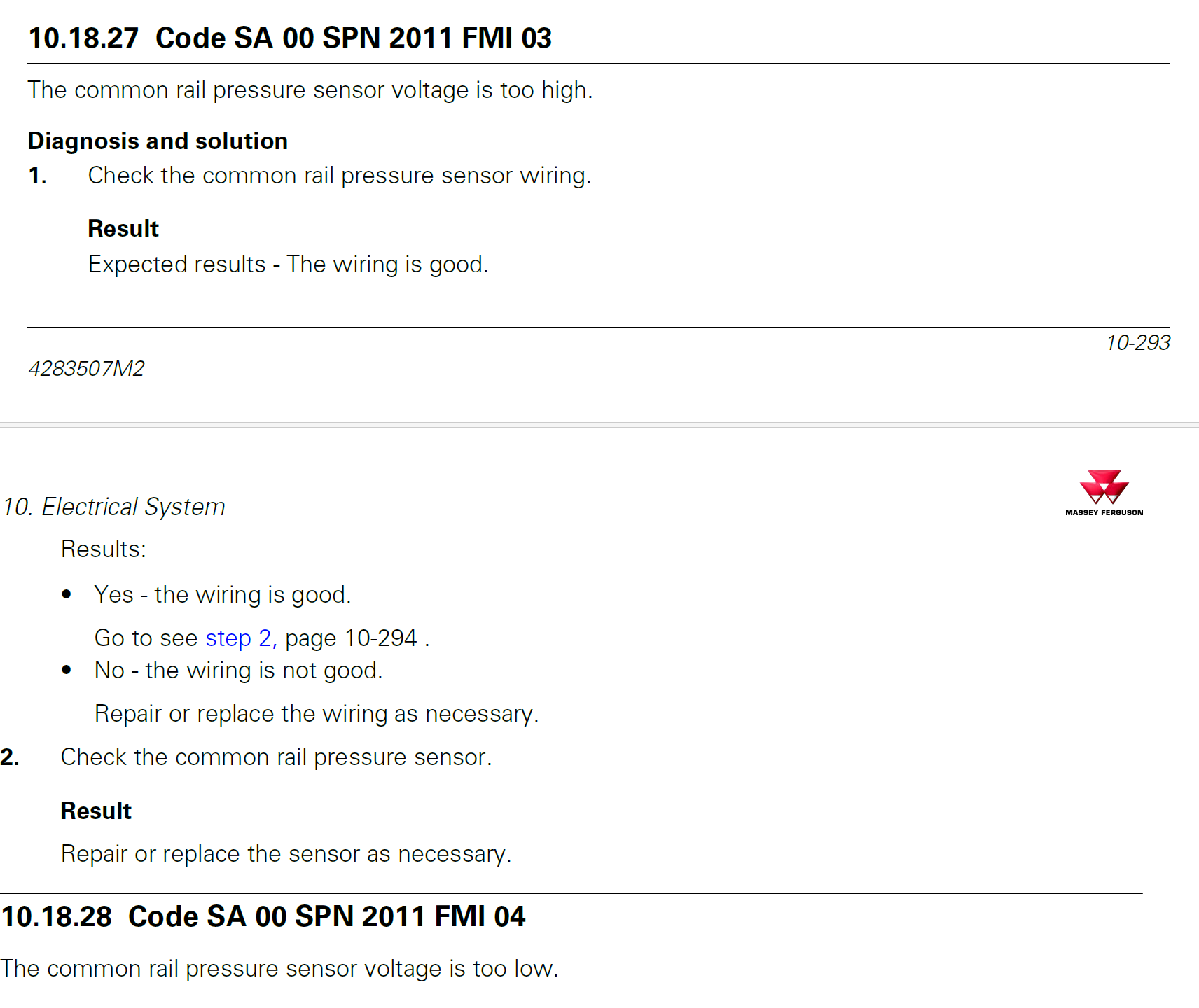

MY 2014 Massey 1736 just quit won’t restart. What’s Code 002011 And below it 03???

It had to die mowing the extreme edge of the field s right in some brush which makes carefully looking it over rough. No issues, no overheat plenty of fuel just quit:cry:. any idea what I’m looking for here before I drag it back in to check it out. I’m getting an engine symbol illumination and the 002011. With an 03 in mid display below it. No history of break downs and it’s been quite goo to me about 850 hours on it.
I’m wondering if I could have snagged something underneath with a bush. That’s my first thought……

Maybe this:
As you though I'd be checking all the wiring and looking for the obvious of a branch or something poking where it should not have.
Then I guess I would call my dealer's service department to get their assessment if this to determine if its something that you can fix. I'd ask does high voltage indicate a typical failure of the sensor?
Good luck and let us know what you find.

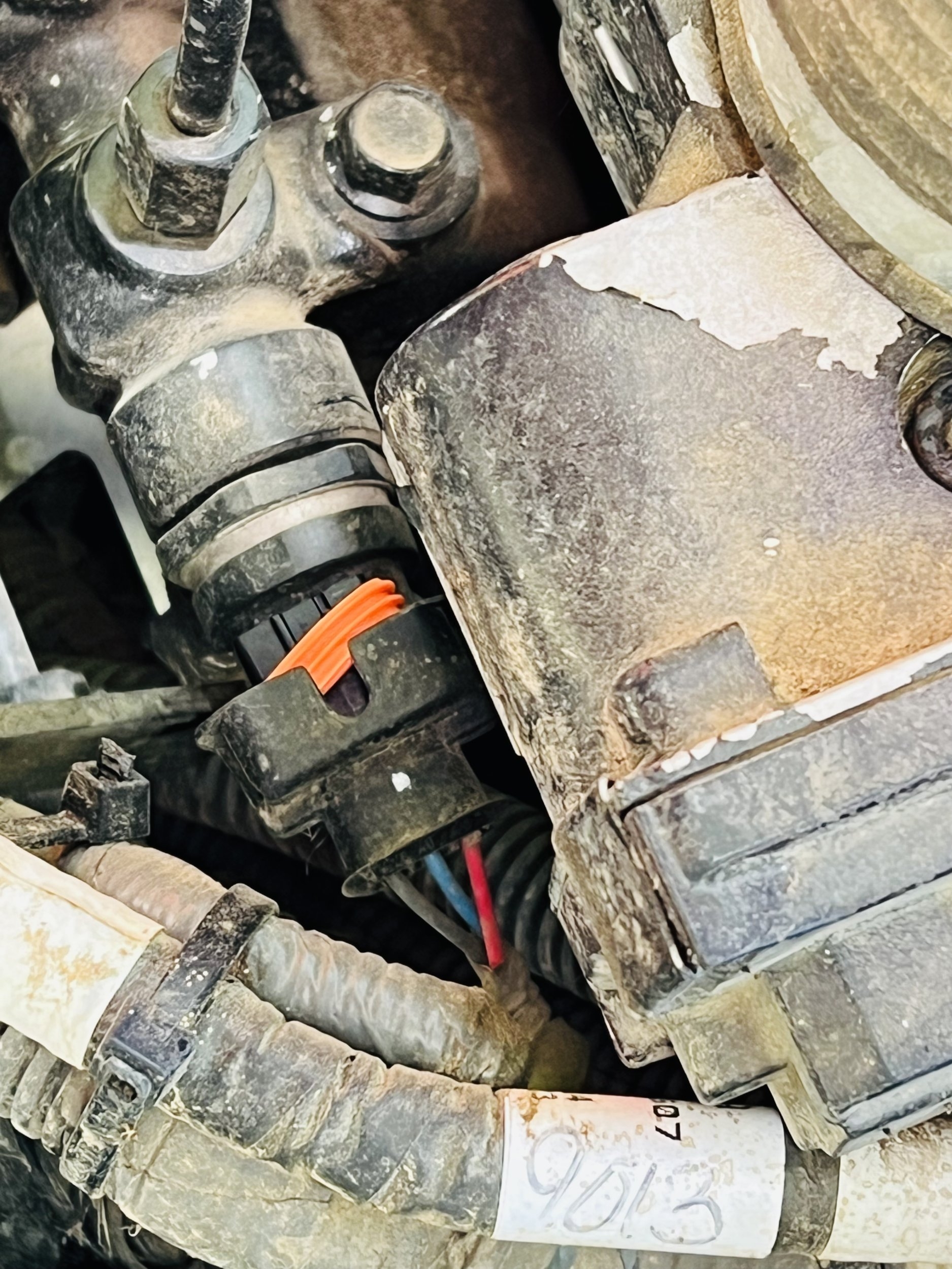

I found it👍🏻. It was one of those sneaky sappy bushes that unplugged the electric plug to the injectors. Took 1 seconds to reattach but a half hour of chain saw and weed whacker action so I could get in there and see what was goin on.

Nice find! was that on the underside of your 1736? So I guess the code 002011 03 high voltage can indicate no wires attached then.
   / MY 2014 Massey 1736 just quit won’t restart. What’s Code 002011 And below it 03???
It’s way up on the side actually. Like i said a sneaky flexi single bush got up there somehow and plucked it right off the injector. Can’t blame the manufacturer for leaving it out in the breeze just a sneaky talent branch. Chopping down the ever encroaching edge brush certainly doe exact a price.
