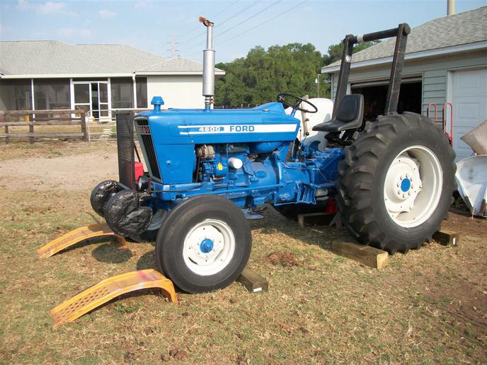

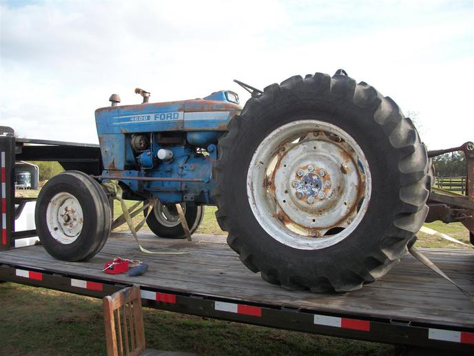

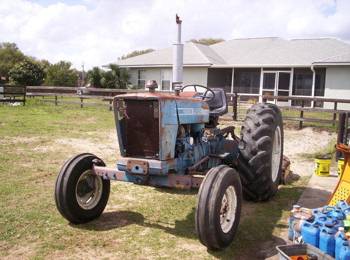

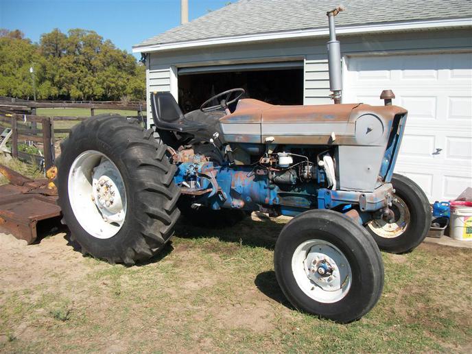

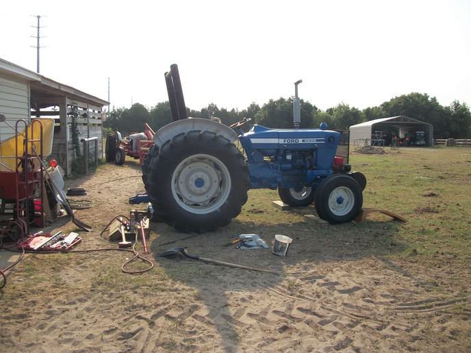

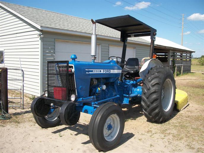

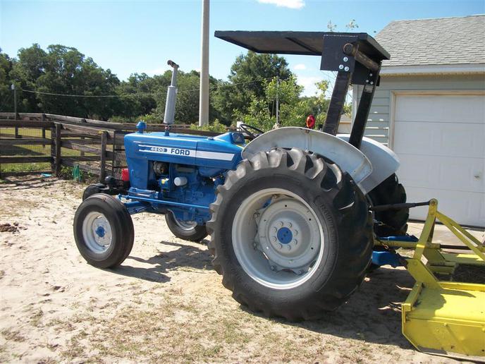

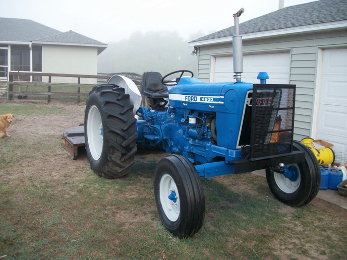

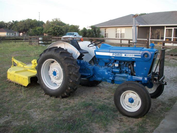

Here's an example of what you can do with 5000$
I got this 4600 for 3900$ needed some tlc.
had to do some body work, chase some leaks, change a few gaskets and orings.. do some welding.. paint....found a rops for it.. made a bumper / grill guard, made a topper out of steel and fiber board and heavy rubber matting.. muffler..had to weld up bracking sna mounts on fenders.. front wheel weights.. filled tires with water and eco AF.. old beater mower was free.. but I see beater mowers for a couple hundred all the time.. bought a couple to rehab. this mower required lube, paint, and welding... it's a beast...
all in all I got time and about 5000$ in it or so..
good machine...
