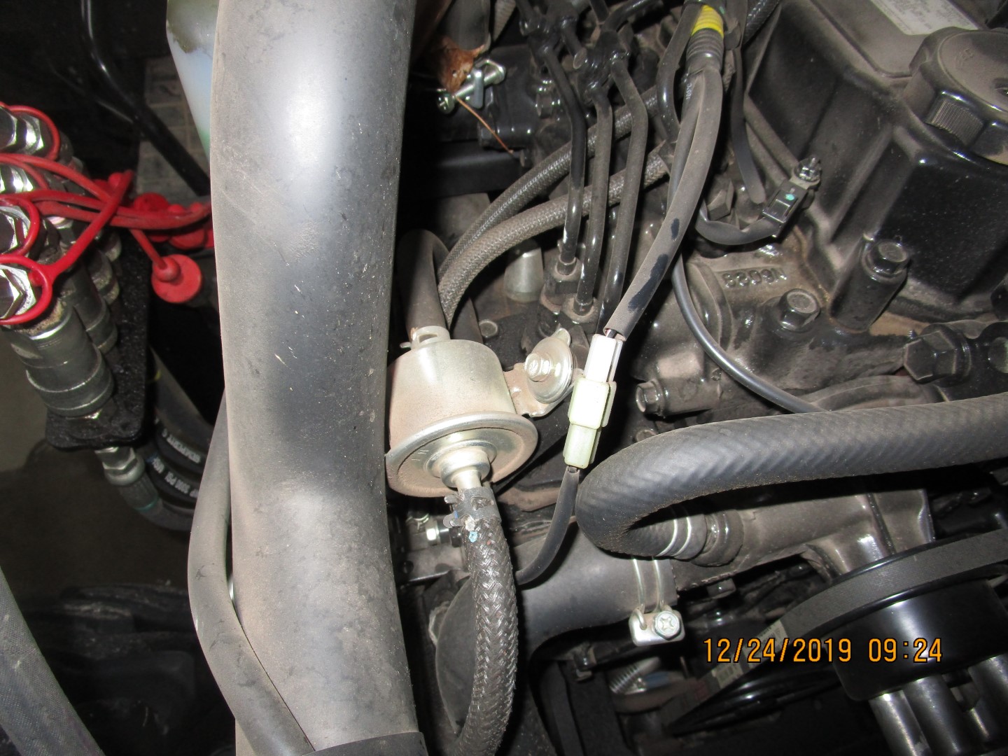

On my 1526 [ Mitsubishi like yours ] three cyl, the fuel solenoid is located on the right side of the engine a little above the injector pump. Mine looks like a small metal canister with two wire going into it. The fuel comes from the tank and goes thru a clear plastic fuel bowl, then from there up to the shut off solenoid. Your solenoid might not be the problem. ANY [ ' ANY ' ] air or water in the fuel lines will cause this problem. In this picture, the solenoid is the silver thing in the center of the picture. These are indirect injection diesels, and NEED the preheaters to work when cold to fire. You should put a voltmeter on them to see if they cycle, and also check for resistance. Forgot ..... " MERRY CHRISTMAS to you and yours, stay safe ... !!!! "

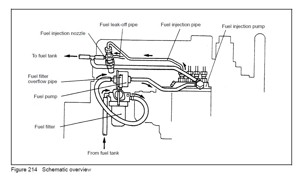

I have a 2216 and this thread got me curious as to where or if my 2216 had a solenoid. Searched the 2216 parts listing and none found and it appeared from the fuel pump to the injector pump nothing was in between, so I found a service manual for the 2216 Mitsubishi engine (S3L-W414RH) which has a fuel system schematic. The schematic does not seem to indicate a solenoid in the fuel system path. Don't know if the 2015 is similar to what I have, but possible. Fuel filter and pump are at rear of tractor on the 2216.

The photo posted by JerryK is actually the fuel pump. On my tractor it is located under the seat area.
