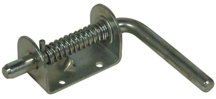

I like this design. The ones I have and the ones I always see have the individual forks clamped to the bottom of the bucket, and they flex a bit.
Also on those pins, when you pull them is there a way to lock them in the open position, so you don't have to hold one while reaching for the other pin?
   / My bucket forks. #7
Thats a good looking setup..tks. for sharing
Army Grunt
   / My bucket forks. #8
Those latches have a "lock open" position; when you want to close the latch just rotate the handle 90 degrees and it springs closed. I think the latch is intended for a heavy duty gate latch; I used one on my tilt trailer.
Found a picture of it:
