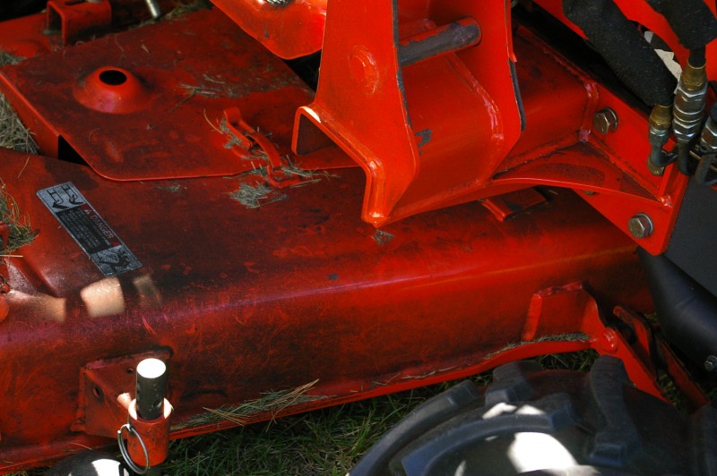

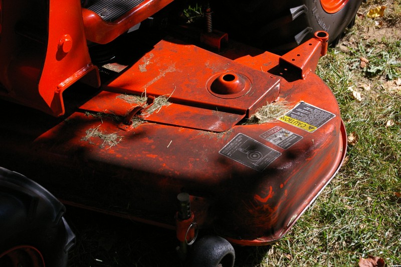

Well, I drove myself crazy for the last 2 days trying to resolve a soot problem on my BX-2200. It's a 2001 with 440 hours and I never, ever had a problem like this.

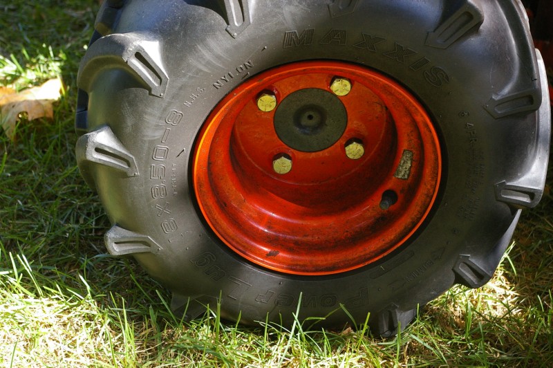

As the photo attachments show, it appears there is soot everywhere on my BX, even in the wheels. I had noticed this right after performing an oil and filter change (Rotella Syn & Kubota Filt) and starting to cut some grass. The soot was everywhere but most heavily on the mower deck and lower parts of the machine.
Thinking it may have been either air stoppage or bad fuel(doubtful) I went to the local dealer bought a new air filter and another set of fuel filters.The local Kubota mechanic said may be air filter or bad fuel, confirming my suspicion. Cleaned air filter housing and replaced with new filter - same problem. Removed deck, drained the tank, replaced both fuel filters and still leaving a soot deposit when I mow.
Hmm... driving me crazy!_____ Did a search on TractorByNet and came up with someone who had a similar problem way back in 2002. Looked at the response to his problem by Kubmech (what a great guy!) and he wrote this: "Mike, here's what I'm pretty sure the problem is. Has it been relatively hot and dry in your area? If it has, what you are most likely seeing is grass mold spores building up. Had this problem years back, cust. swore it was belt dust from the mower, came back several times and could'nt find anything wrong (pulled my hair out trying to find something). Found the answer in the John Deere dealer tech data base.".
Well, went out and tersted it today, sure enough the material coming out of my deck chute had a black tinge to it. How to test it was easy, since I didn't have anyone to ride along and test the output, I got a long 1"x1" and held it near the chute when I was cutting. Yup, there it was dark soot all over the wood.
By the way, it brushes off real easy, and I was able to blow it off with my air blower. Also, as I put rubbed some on my finger it appeared exactly like carbon soot but the key is how easy it dissipates.
Well thanks Kubmech and TractorByNet.. I only lost 1 night of sleep over this!

Yep, its a fungus, I had it a couple of years ago, thought I had chewed up a belt too. I have noticed several black "puff" balls this fall as I mowed, but no black on the tractor. I had 2 bouts of rust fungus this year, it turned everything brown on the tractor and mower. They say it is caused by too much humidity and not mowing often enough, only good thing is that it can't survive the winter here. I would wear a mask if you have a allergies.
   / My BX is loaded with Black Soot!
You're right, I did wear a mask last night but in my haste forgot to wear one today. Think I am paying for it now as my cold has intensified and my chest is burning.
This grass is my neighbor's property and I was doing them a favor since their lawn guy quit on them. True, they don't mow frequently and the grass was long, dry and discolored.
Oh well, as long as the BX still functions OK I'm a happy camper.
Watch out for those spores!!

On a somewhat unrelated note, I love those tires you have. I had them on my BX2200 as well. They grab like crazy in the soft stuff and yet are gentle on the grass. Too bad Kubota did away with them.

Well, I was able to test the theory of either mold spores or fungus as I fastened a test "pole" to my tractor and placed the end not too far back from the deck chute. Sure enough, one pass and it contaminated the pole with the black, I believe, mold spores.
The sad thing is that not wearing a mask seemed to have me inhale some of this stuff and the cold that I had really got worse. My chest was really burning and I did have a concern. Fortunately, today the effects are diminishing.
BTW, I did check the deck belt and pulleys, absolutely no belt dirt or material anywhere in the pulley or belt area. Belt still looks great after 6 years of mowing.
They have not done away with them. They are still available not only for the BX but for the rears of the B's there is a simular tire called bar turf. The hard facts are the most popular tire for compacts is the industrial for us.
