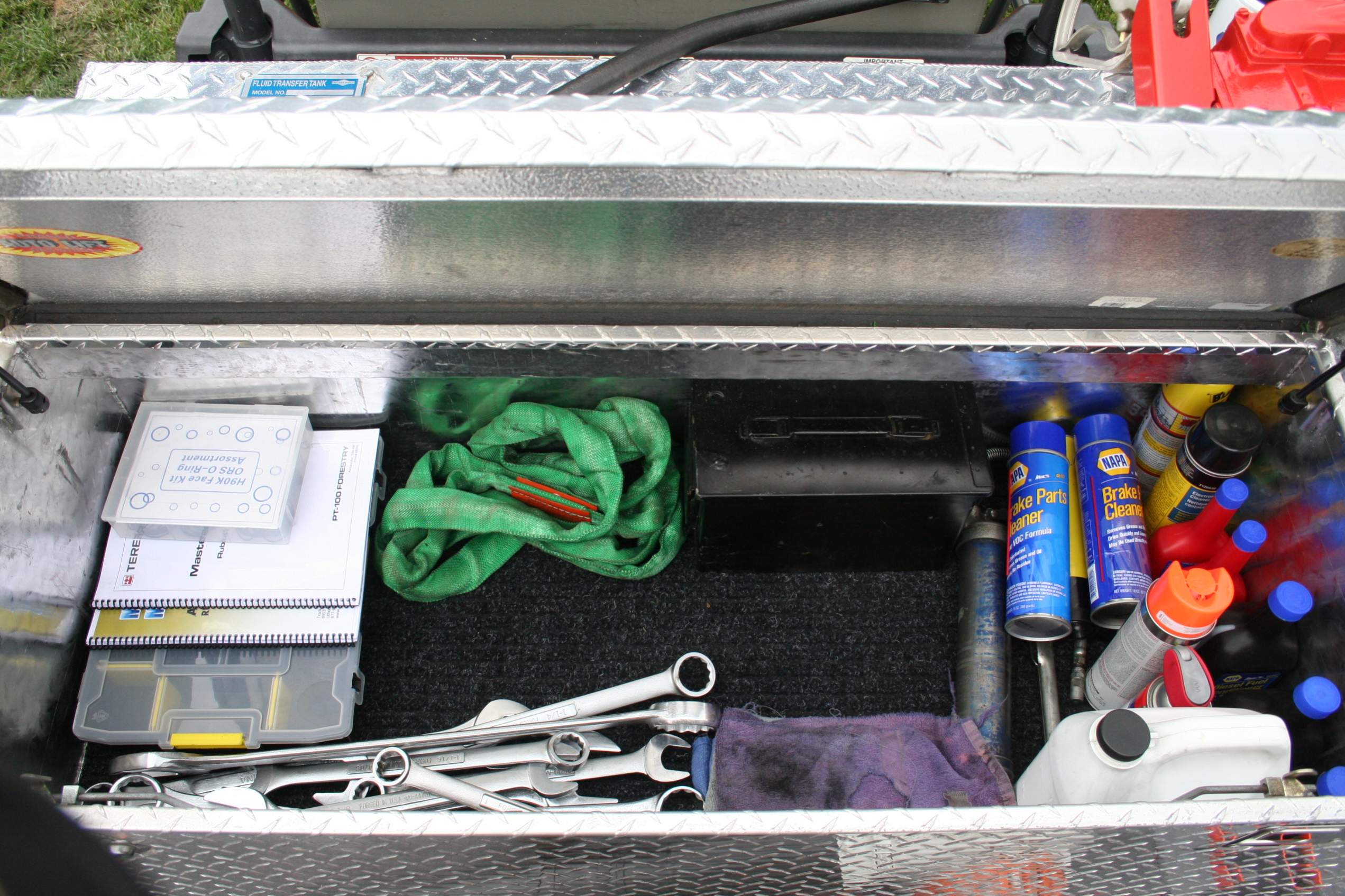

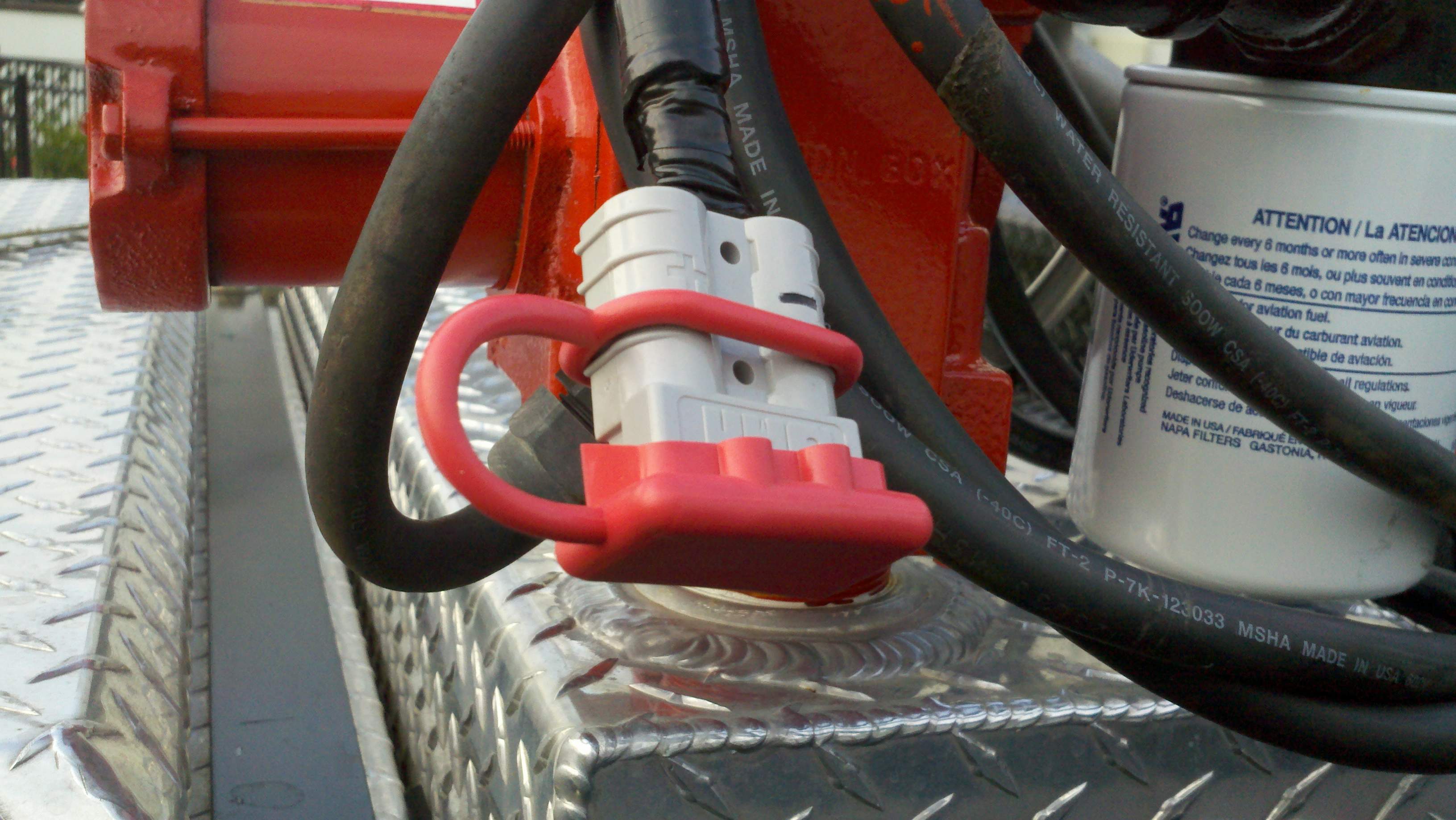

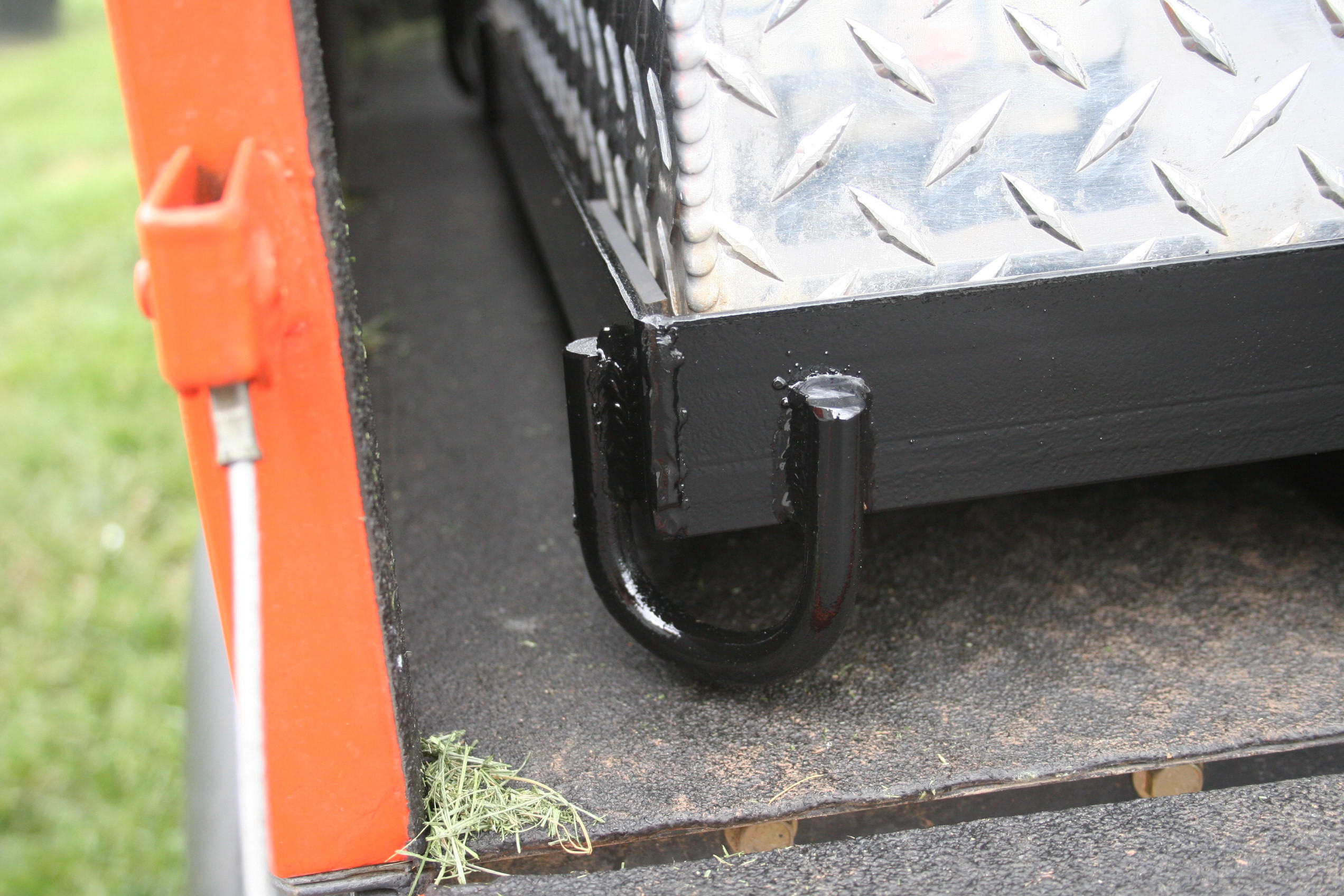

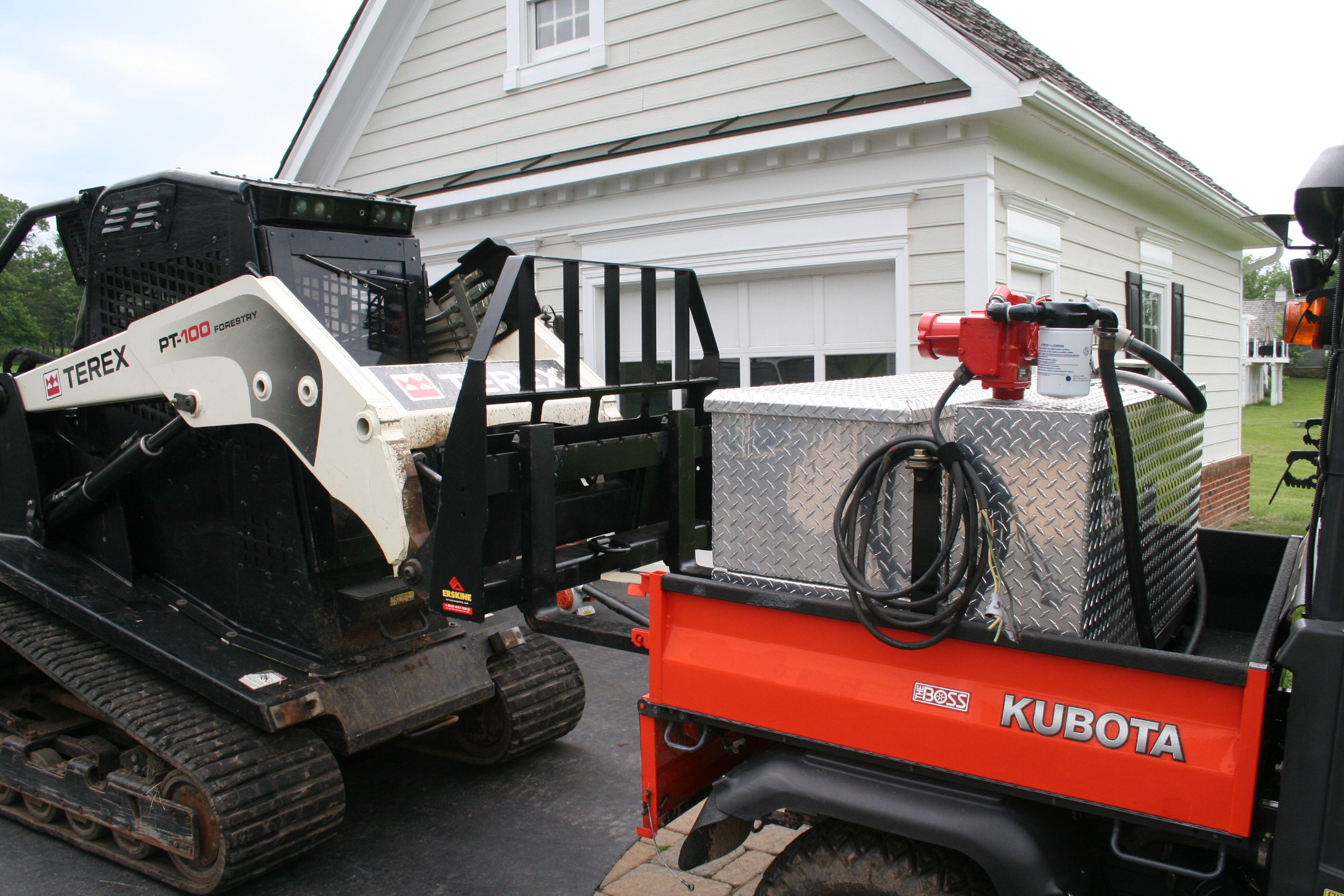

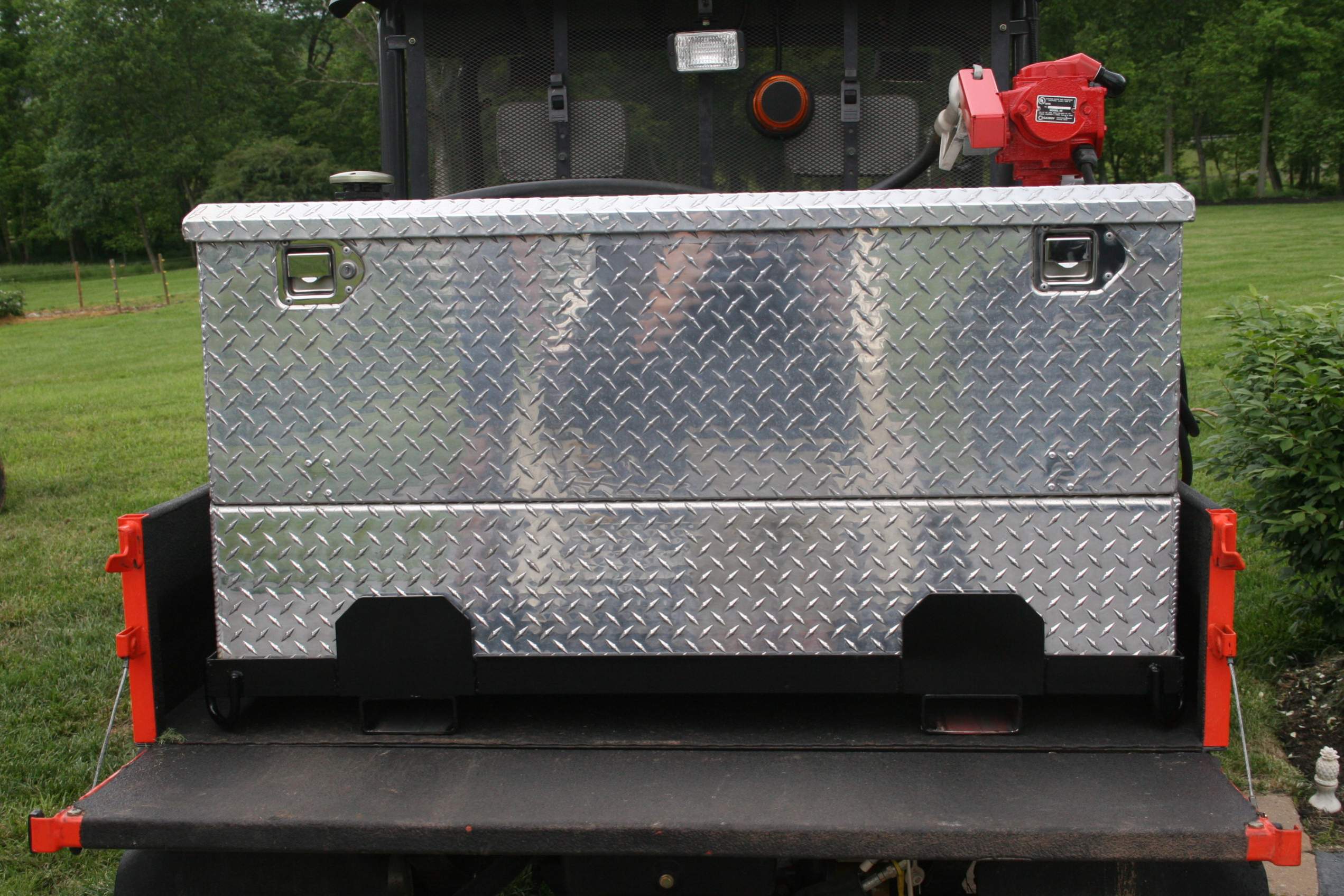

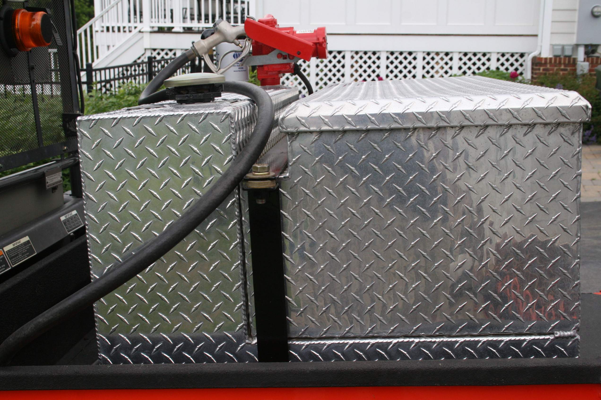

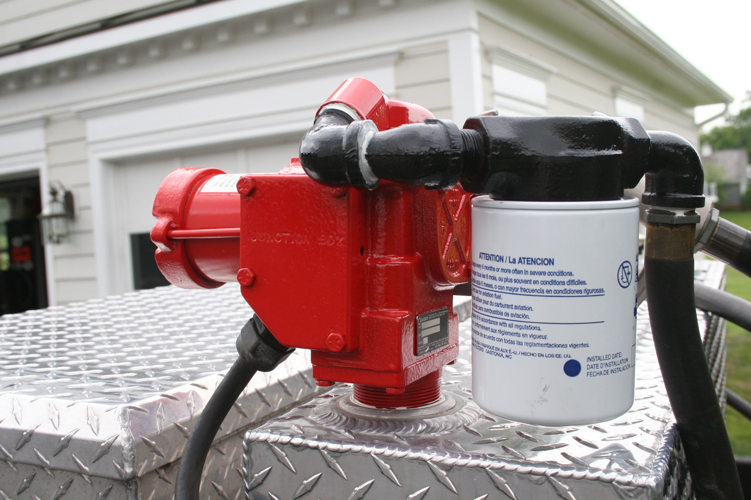

I needed a transfer tank for my mulching company; after tooling around craigslist i found a good deal on a aluminum tank/ box with a pump. After i got it home I polished the diamond plate up, repainted the pump and made a skid for it. The idea behind the skid was I didn't want a tank in my truck bed all the time, also I wanted something I could put in my Kubota RTV to fuel up my mulcher on remote jobs. :cool: The skid is constructed of 3/16" angle with rectangle tubing pallet forks slip into. There are rings on all 4 corners to tie it down.
I think it turned out pretty nice and fulfills all my needs well. Would be glad to answer any questions or hear any comments. :thumbsup:
Jon

Very nice ! Looks like that is going to be just the ticket .:thumbsup:
   / My diesel tank/ toolbox portable skid
Thanks! Now all thats left to do is wire in some electrical connections on my truck, the RTV and the mulcher. :confused2:
   / My diesel tank/ toolbox portable skid #6
Nice job.
Chris
   / My diesel tank/ toolbox portable skid #7
I like the safety plates above the fork pockets! :thumbsup:
   / My diesel tank/ toolbox portable skid #8
nicely done!
Where are you getting the juice for the pump?
#9
I put a plug on the pump and have them on my mulcher, RTV and truck so no matter where im fueling at I will have power. Thanks for the kind words :thumbsup:
