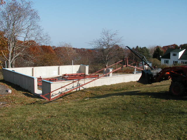

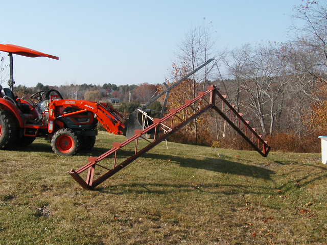

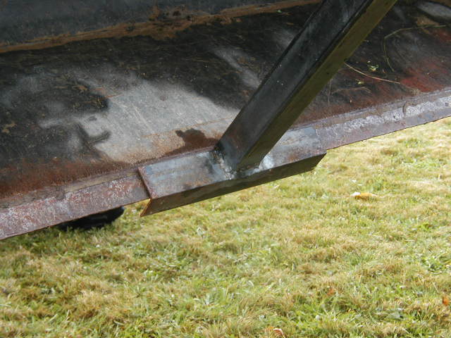

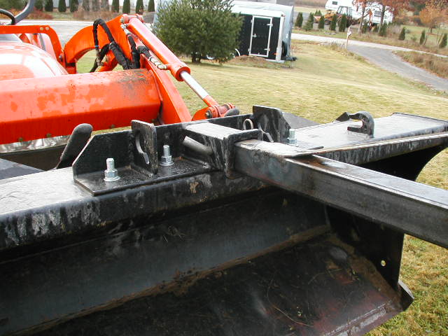

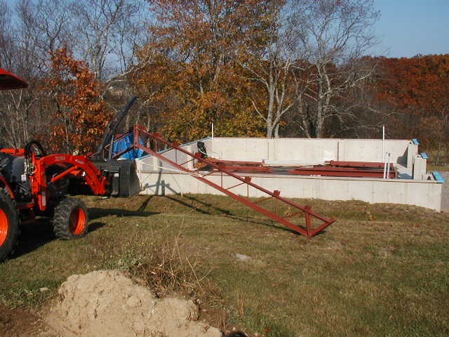

Short story long... I bought a Miracle Truss steel building, before I bought it I was told that none of the trusses weighed more than 125lbs. I figured that with some scaffolding, 3 guys could lift that into place safely. Well... when the building arrived, 2 guys could hardly lift one of the roof trusses, never mind safely wrestle with one up some scaffolding into position. Turns out the trusses weigh about 225 lbs each!! :eek: The first of several lies from Miracle Truss. :mad: So I built a 6ft boom to go on my bucket, but I was not sure if it being that far out front would my CK30 be able to lift it. Well, with 2 trusses bolted together, ~450lbs, I can lift them up. I can't curl the bucket, but I can lift it. I did find that if I partially curl the bucket before lifting, then lift it up so the weight swings in nearer the bucket, I can then curl the bucket the rest of the way. But no way can I curl it with the boom level and the weight 6 ft in front of the bucket. :eek: Looks like my band aided KL130 is going work. So much nicer than driving an hour to the nearest rental place to get a lift. This weekend, weather permitting, I will see if I can lift it high enough to set the trusses in place. I need to get them high enough so the peak is at about 15 ft. Yes Ed, a DK40 would make this job a piece of cake, but I have not convinced Rick to swap me one for one. :(

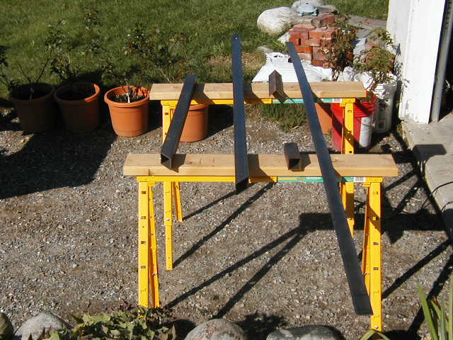

First picture is the pieces that made up the boom.. the others are the boom in action, at least testing to see if it is going to work. :) Ropes are there to keep trusses from swinging when I transported them from the side yard to the back yard.

You don't want to look at my welds... I'm still learning. I use Oxy/Acet and I was having a miserable time until I got larger tips to get more heat into the weld. Everything about the boom is oversized/overkill just to make up for my welding skills, or lack there of. :)

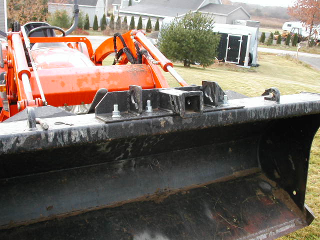

Good job there, Jim. How's it attach to your bucket? Be careful that one of those trusses doesn't get loose and swing around and hurt you or your tractor.

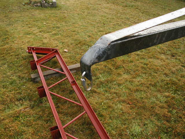

I stole the idea from this thread:
http://www.tractorbynet.com/forums/...ng/93535-bucket-buddy-instead-weld-hooks.html
My dealer made up a 2" hitch receiver, from photos I gave him from that thread and he threw it in with the tractor when I bought it. I then bolted the receiver on to the bucket. I extended the 2" strap to be used for where the chain attaches. Since that strap carries most of the load, I doubled the end where the hook actually attaches.
For moving the trusses around the yard, I rope them to the bucket so they don't swing. I also keep them only 1ft above the ground so I can drop them in a hurry if I have to. When I actually go to lift them into place, I will have a person at each end, with ropes, to keep things under control. I have great respect for what could happen if one of those 450lb trusses got to swinging around or broke loose and fell.
