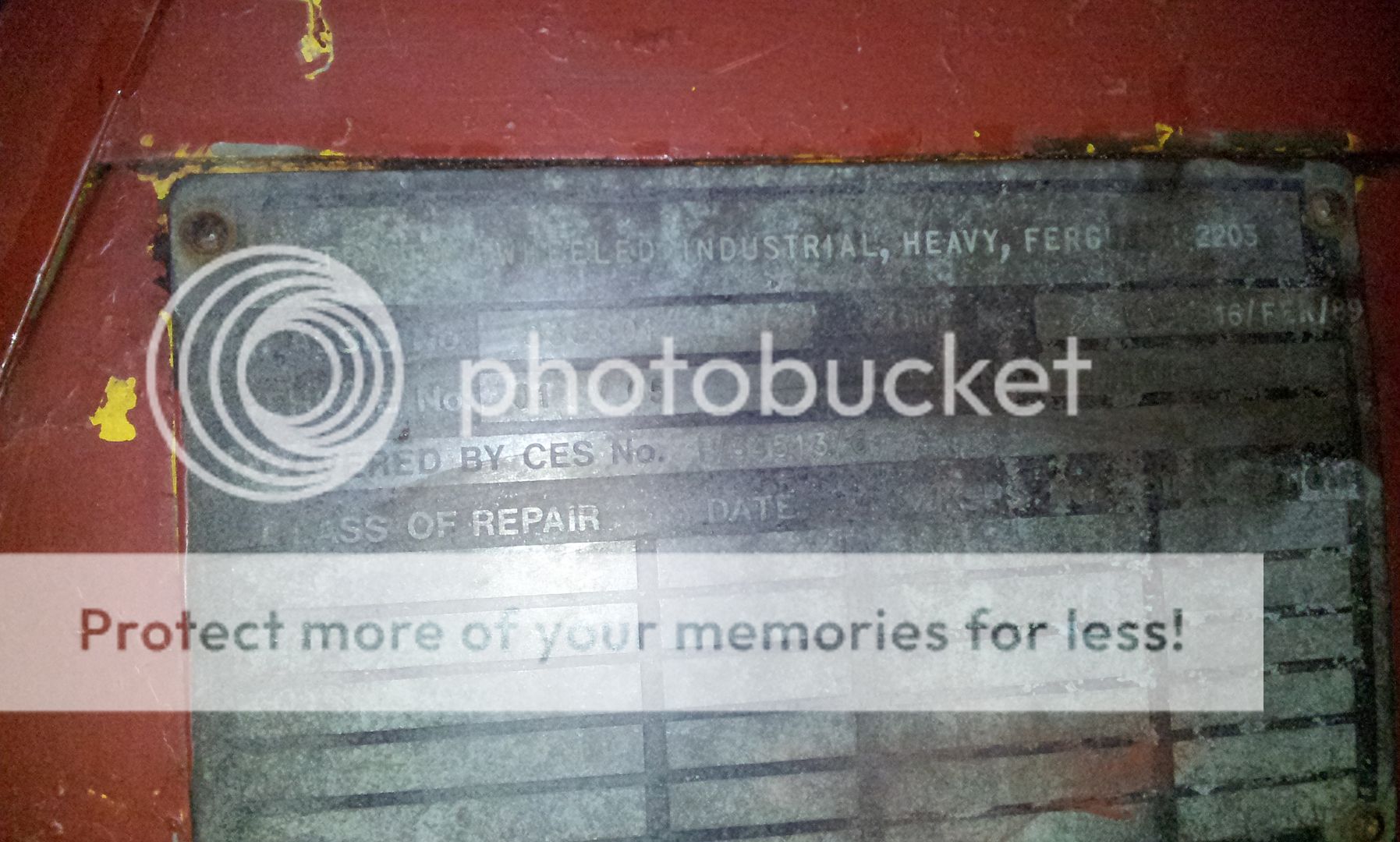

The army vehicle data plate is all a little more visible now

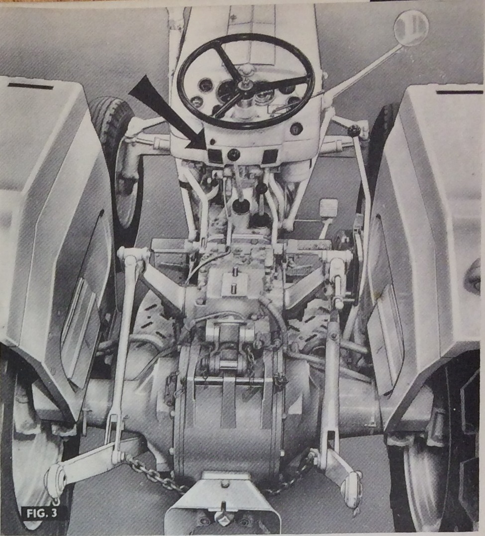

Does anyone know what the picture shows next as it looks like a lever is missing from a splined rod / linkage on the rear axle

The MF203 was a great machine. If I recall, that shaft with the missing lever is the differential lock.
   / My Fergie 203 Industrial needing some TLC
Indeed it is
User Handbook identified its lever operated and not by pedal

With the MF203 I owned that could have been identified as a lever... foot actuated.
Image from user handbook showing lever inside Right Hand rear mudguard / Fender
